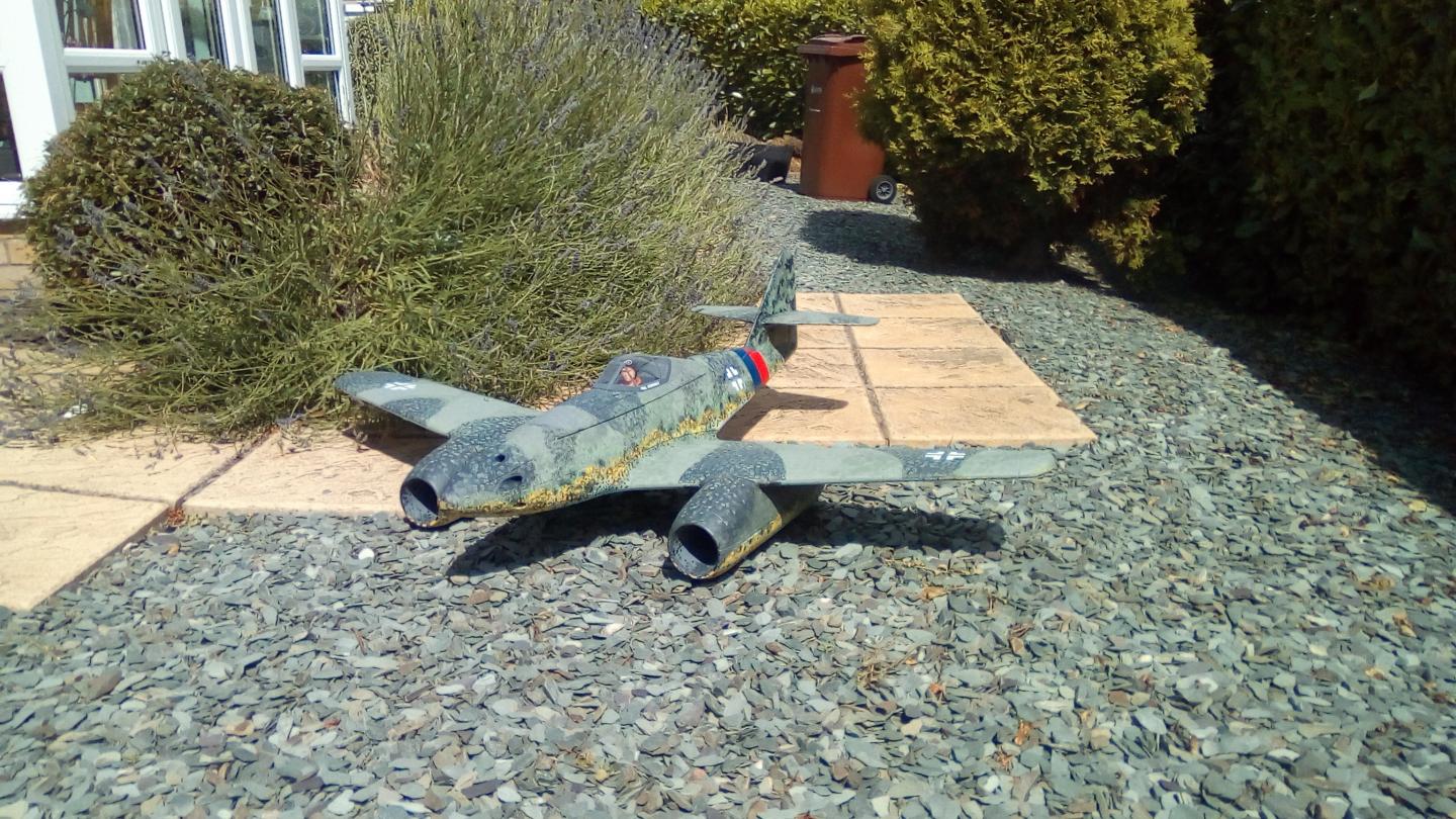

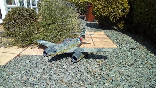

ID:	209415 I use twin 70mm fms 12 blade fans with twin 80 amp escs but I mounted the escs in the nose wheel bay and cut out foam in bulkhead through into fuselage ( not too much) I then installed hole in rear underside of fuselage. I increased air holes via cannons in nose and added extra 2 cannon holes into nose leg area to feed battery. I removed the signal wire from one of the escs so that I only have one bec working so as not to confuse the escs brain( and mine ). I have cg set at 125mm from LE joint, 8% down elevator to throttle mix, HK oloes and retracts, photos attached,flys great, stays cool. Photos attached.

                your 262 looks good also
