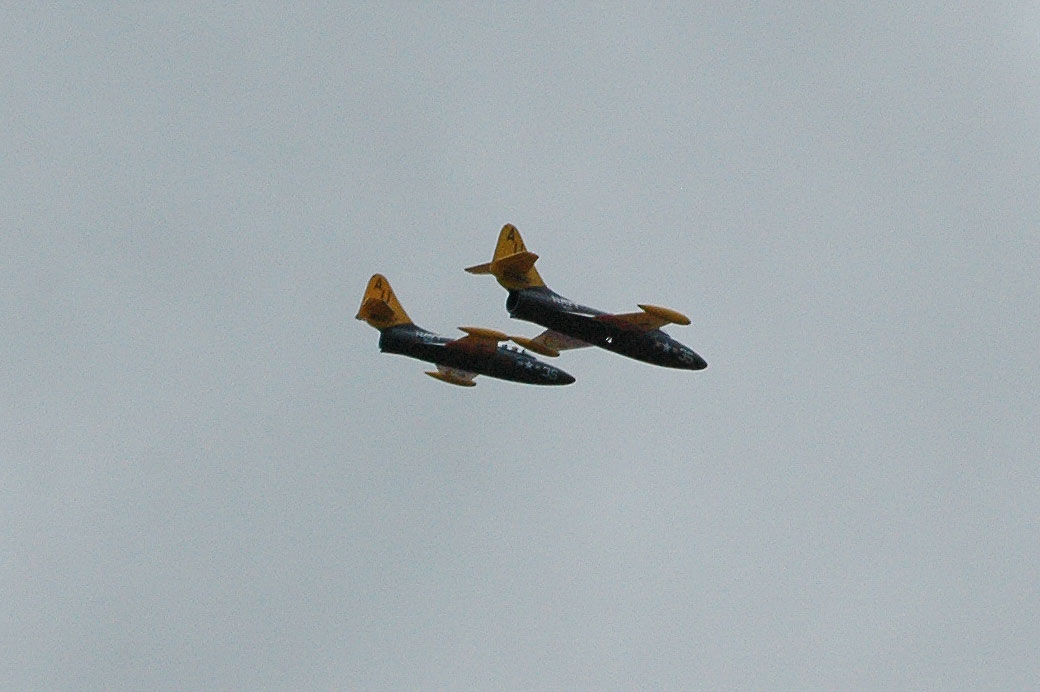

    I was introduced to the Panther by some buddies who had been flying them.
    We use 3 cell 2200 mAH batteries pushed up front. I punched out some of the plywood tray so I could drop the receiver below the tray & the battery.
    To make it easier to launch, we cut out the first 2 ribs in the belly cheater holes which gives me enough of a hand hold under the CG to grab and launch the Panther in one hand while holding the transmitter in the other.
    Here are some images I shot while the boys did a little chasing each other around the field.
    Do you have any flight photos to share?
    Scott

    Great photos, Scott. What a tight formation!

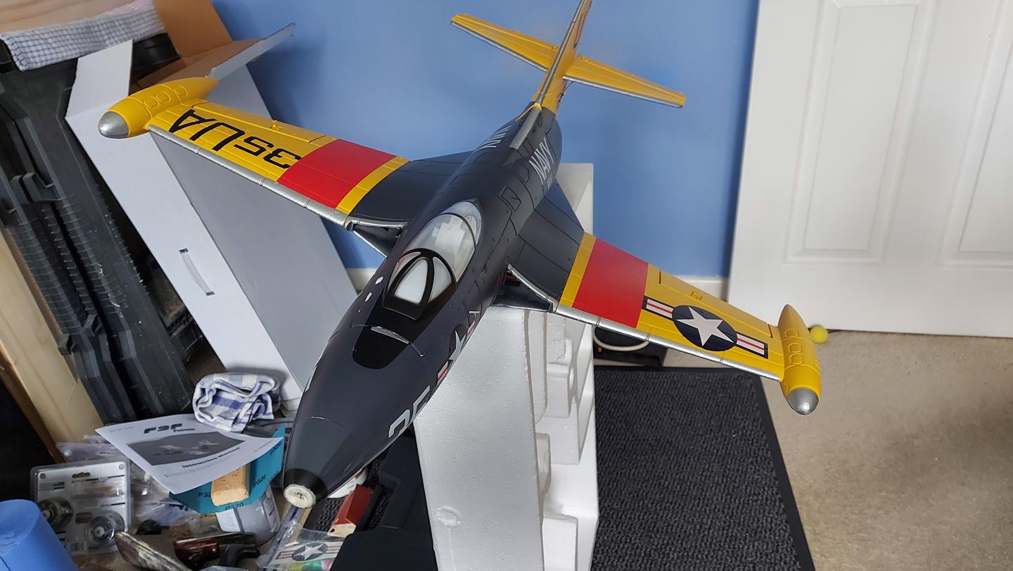

                  Thumbs up on that! stinger 64, 12 blade, 2200 pack and I get 4 mins with conservative throttle use. i wondered about cutting into the battery shelf because there is so much wasted space underneath. I am using stock set up at present and using a Zippy Compact 3 cell 2200 weighing in at 182gms. Just balances at 45mm. I cut into the nose cone and fitted a Cree power led and lens so I can see it coming in any weather. I can also make it flash to give the appearance of cannons blazing.. lol My workroom is in a mess, I am supposed to be decorating.....
