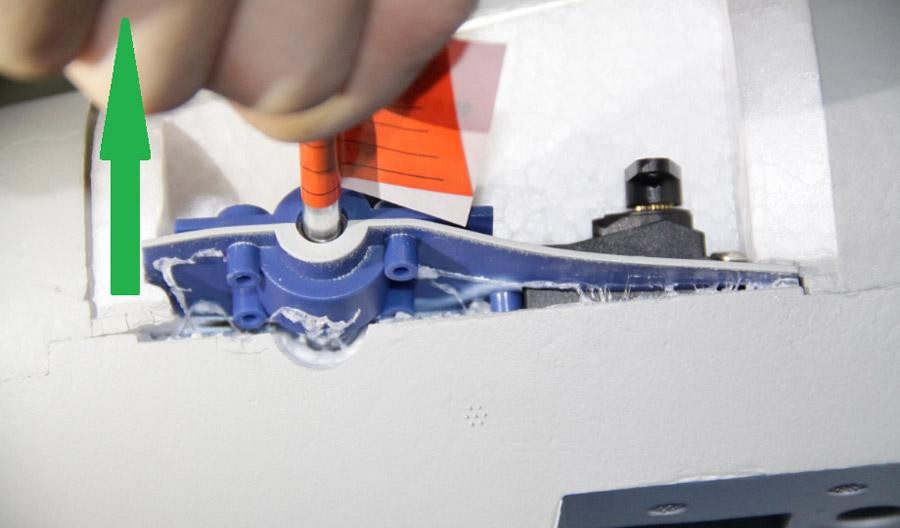

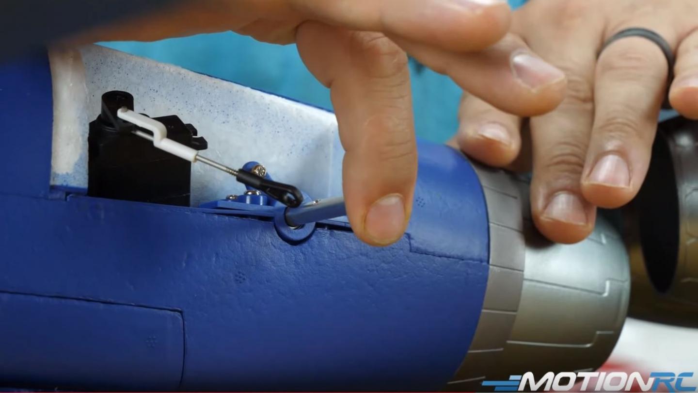

    All, as I'm sure you are aware, a small percentage of 90mm F-18 had problems without explanation. While this was a small number of planes relative to the number sold, Motion RC and Freewing were very concerned and have been looking into a possible cause. We found two causes: 1) Elevator servo wires with stripped insulation, 2) Not enough glue on the Elevator mounting plate.
    In a nutshell, some planes did not have enough glue on the plastic mounting plate which holds the elevator pivot rod and elevator servos. If there is not enough glue on the mounting plate, the mounting plate can pull away from the foam at the elevator pivot rod which in turn throws off the servo geometry. As little as 3mm of movement in the mounting plate can stall the elevator servo, strip it, or bind the elevator. This is very easy to check and add glue if necessary. As I'm sure you can imagine all future planes will have this addressed at the factory. Please check BOTH of your F-18 elevator mounting plates and add a little glue if necessary to make sure the mounting plates are secure. Both pictures below show too much movement.

      Definitely good for all F/A-18C Hornet owners like myself to know about...Please be sure to check before flying, even if you have flown successfully. My servo wires looked fine but my port side elevator mounting plate was in fact loose so I sealed it good with a bit of epoxy. Foam Tac will work great too. This jet is too pretty to lose to a "not-your-fault" crash!

            I just replaced the fuselage this week, and saw how tight it was to get elevator servos in place, so what I did was gently placed servo wires in first then push in opposite side firmly, as far as the whole brace haven't had an issue but will certainly double check thanks for the heads up!

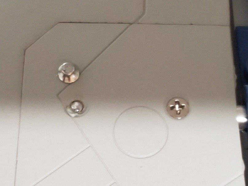

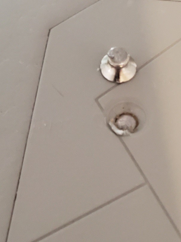

              Id love to check both sides but the screw broke trying to take it out without lock tight on it
              • fredmdbud
                • 451
                You don't need to take the stabilator to check - in fact, that would make it easier since you have the entire surface to apply leverage force on the mount.

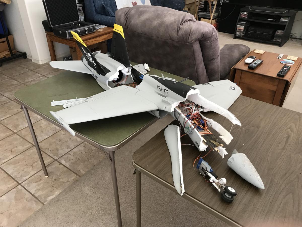

                        Well, checked mine all out and no problems found. Very next flight, no elevator control after about 1 1/2 minutes of flight and it went straight into the ground. Total loss.
                        I've got about 20 flights on mine, and it's flown great (after replacing a bad servo during the build and the 2 nav lights going out), so no idea what the problem was on this flight.
                        There's definitely something wrong with this plane. Not sure if it's the control board or something else, but I had no elevator authority at all after flying for about 1 1/2 minutes. It took off and flew a couple of circuits fine, then out of nowhere - no elevator.
                        I got the wreck home and all of the electronics worked fine on the bench. No idea what it was.
                        I loved the way this plane looked and flew, but I'm seriously rethinking replacing it. Just too many problems with it from the get-go.
                        Would love to hear any thoughts on this.
                        Thanks
