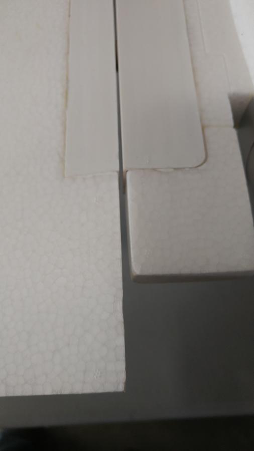

    Elevator neutral is having the top of the stabilator plastic mount trailing edge level with the top of the trailing edge of the fuselage plastic mount. (see photo).

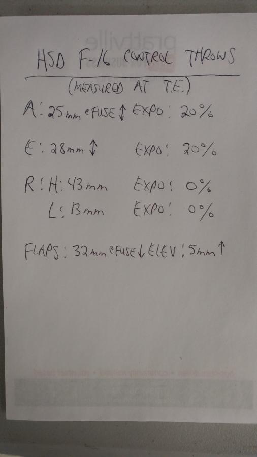

    See the attached for my recommended scale flying control throws and expo.
    I used flapperons for takeoff only, not needed for landing.

      Thanks for the info. I'm still a few days out from receiving the jet but you've given me a great starting point.
      I assume the 32mm is full flaps. Do you have preferred takeoff setting? This would be the first jet to mix flaperons for me, if you have any advice on that I'd gladly take it

        Correct...the 32mm is my only setting, and again, only used for takeoff. Note there is 5mm of up elevator. An F-16 will pitch nose down with flaps...so the up elevator mix is necessary to compensate.
        Since I'm flying off grass, I use that flapperon setting for takeoff only...somewhat as a soft field takeoff technique. If you're flying off pavement, flapperons may not be necessary depending on your runway length.
        I've found, like most F-16s, they land better with some speed. That's why I don't recommend using flapperons. I do recommend land with about 20-25% throttle.
