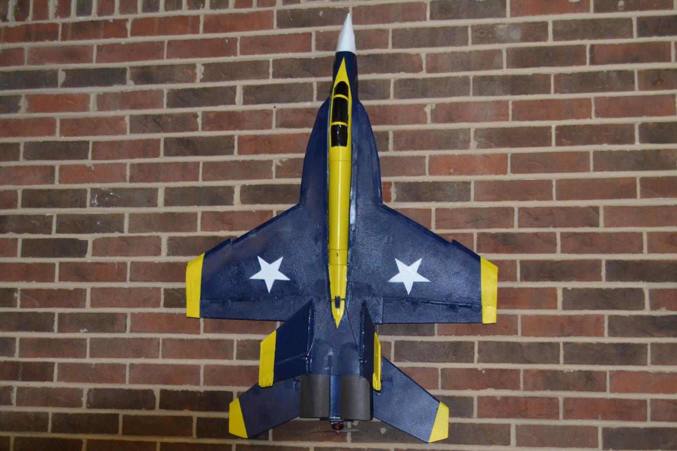

    I have built several edf jets (F-35, F-22, and F-15) and have tried three different control setups such as:
    1) Normal mode (ailerons and elevators), the traditional controls.
    2) 2X4 mode (ailerons, and elevators mixed with ailerons)
    3) 4X4 mode (aileron mixed with elevators).
    I keep going back to the 4X4 setup. The 4X4 setup seem to give me a better success rate on all three jets.
    I just want to know different opinions and experiences on this issue.
    My next project will be an F-18 (EDF) similar in design, but bigger than the one I built in the picture attached.
