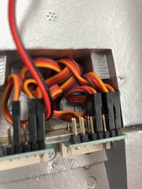

    CAUTION T33 Wing servo connection
    2 Servo boards are screwed to plywood in the center of the wing. Please ensure that the 4 screws that hold the boards in place do not contact the servo wiring. Replace these with shorter screws, bolts or
    glue the boards in place. We found one T33 that had multiple cuts in the servo wires already.
