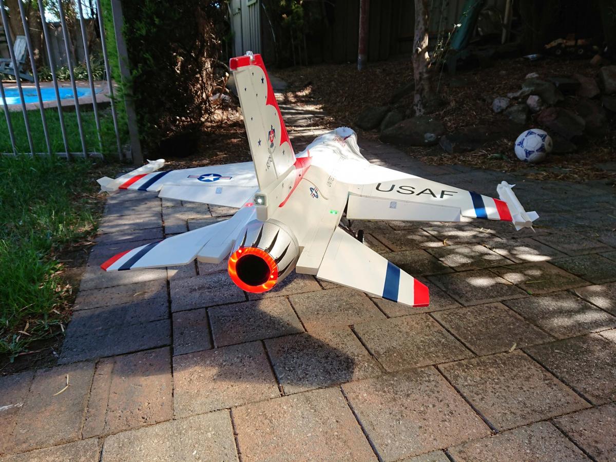

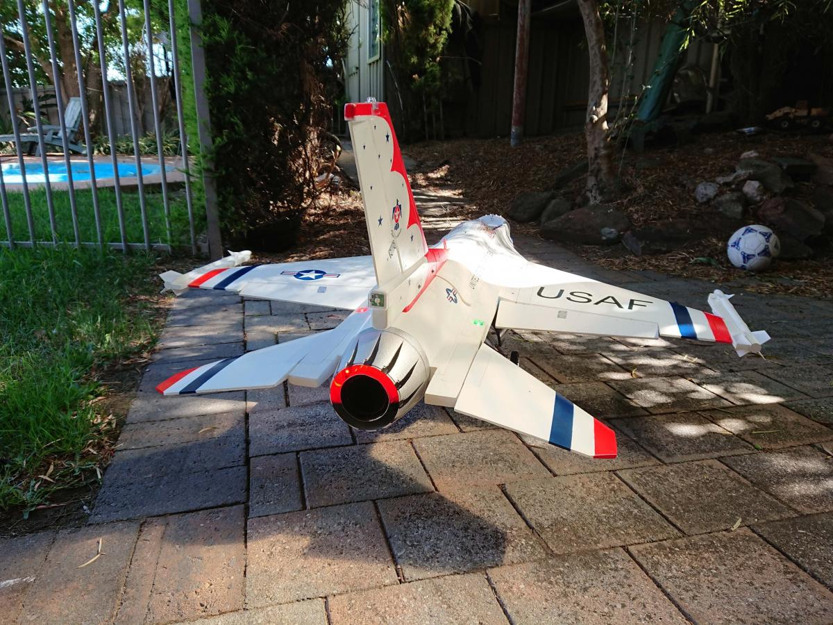

              I have a HSD F16 and mixed flaperons in and it made a huge difference.
