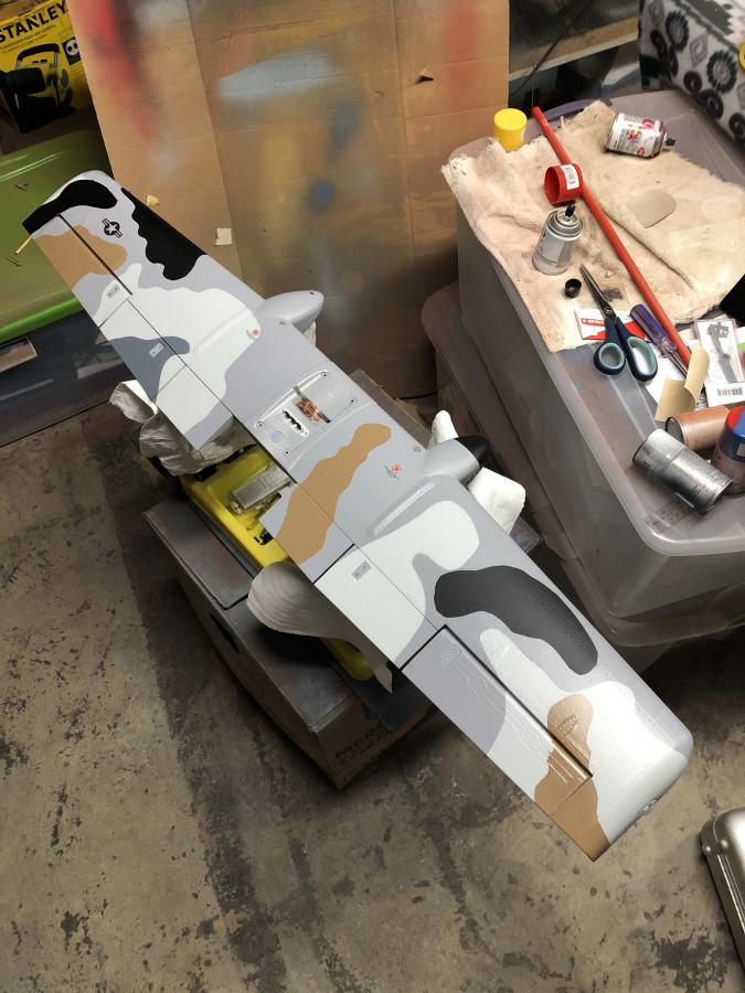

    I just received one yesterday, after checking every thing I decided there is to much gray, so I started adding more color. Just finished the top of the wing this morning. I am going to do the tail surfaces tonight and the fuse tomorrow. To many projects going now, so staying in to finish a bunch of them. To windy lately to fly.

      I like that Wild Man. How did you mask those areas?

        I used Two widths of 3" masking tape then after laying out a masking paper pattern I cut the pattern out of the masking tape laid it on the wing and covered both sides of pattern with masking paper and painted it. I was very suprised after doing a test with some masking tape to find that they finally have a plane with a paint job that does not lift with the tape WOW it is about time!!!!. I was very careful not to get the tape on any of the decals though. I use a low tack masking tape.

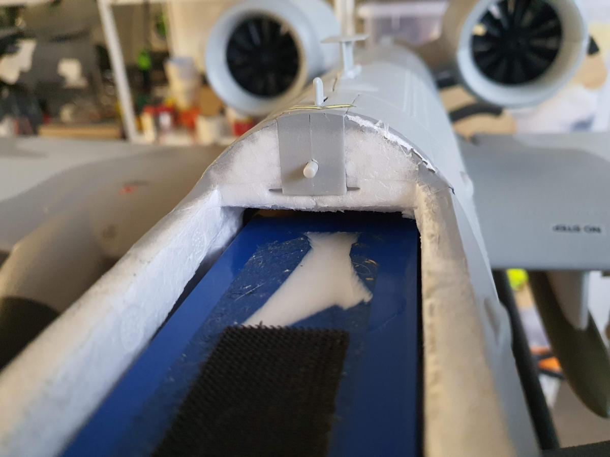

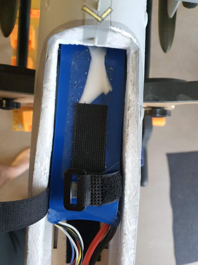

                      Here's some pics of the big ol' Turnigy in there. Hopefully you can see the foam carving. They work ok but it really does fly much better on a lighter pack. Like you, I had these at hand from other planes. But I wouldn't buy them just for this jet.

                              Yes, with 1/2oz of lead just under the horizontal stab.

                                MSHAGG - Are you connecting your battery on the top of the pack with the wires coming thru just below the latch for the hatch? Or did you re run wires so they are under the battery tray somehow?
                                • mshagg
                                  • 541
                                  • South Australia
                                  #17
                                  With smaller packs I bring them up the side of the battery, with the larger packs I connect the battery and then slide it into position as there isn't room either side to get the wires past.
