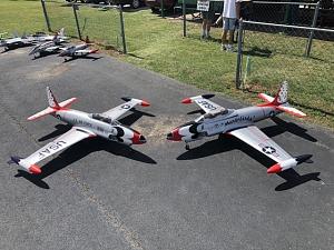

    Just received mine yesterday. Anyone else out there set theirs up yet? I will be updating.
    I did the maiden last Sunday!!!!
ID:	255541 https://youtu.be/91rt_K9tjRE
