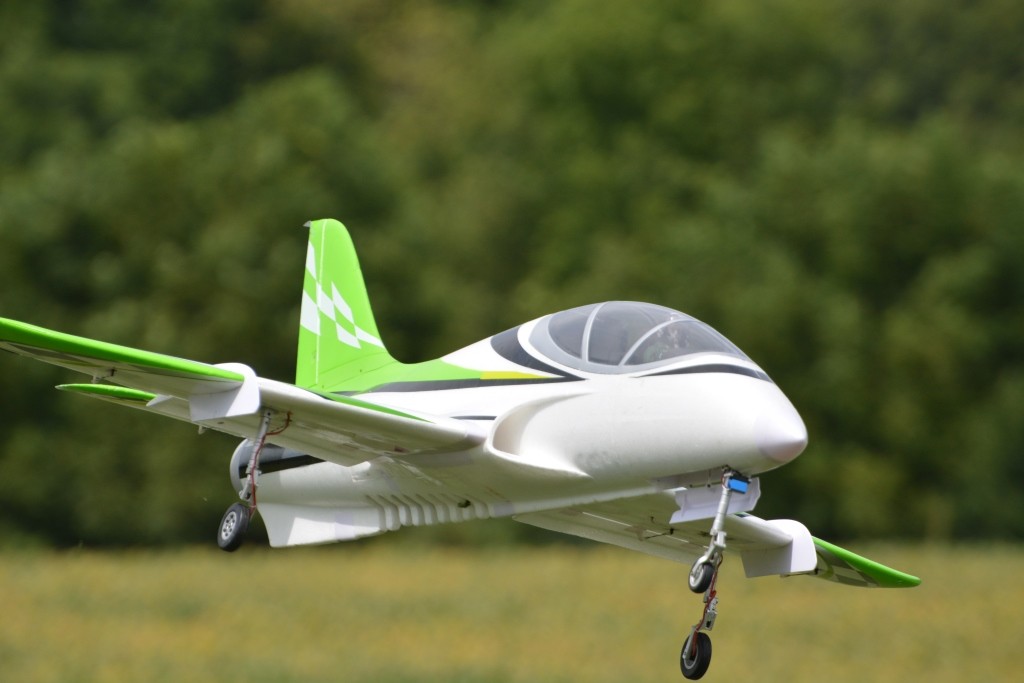

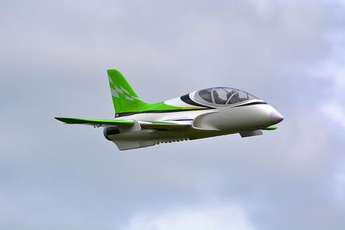

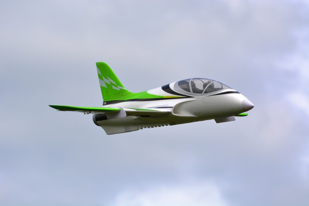

                              Here is my V1 HSD Viper. Running on the JP Hobby 105mm fan with the original ESC and did not need to change motor timings. Setup per manual and CG per manual. I did remove the HSD box so I could shift the batteries back for more aft CG (2xRoaring Top 5500 70C) I control the gear and front door through IX12 gear sequence and use 9 channel Spektrum with Cortex Demon Gyro Brakes are as supplied with the plane. Fly's smooth but not a screamer but fast enough and landings are at a shallow approach. This is a trainer for my HSD Viper with king tech 60....

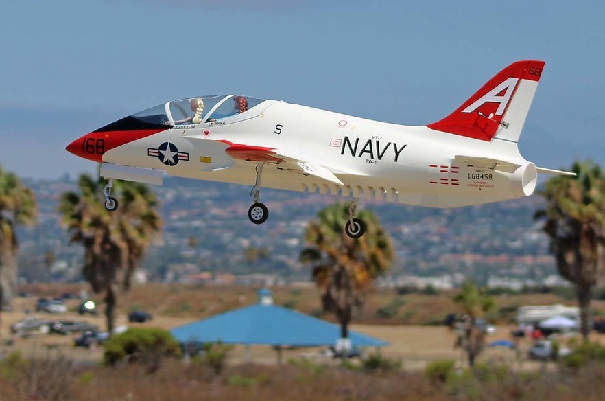

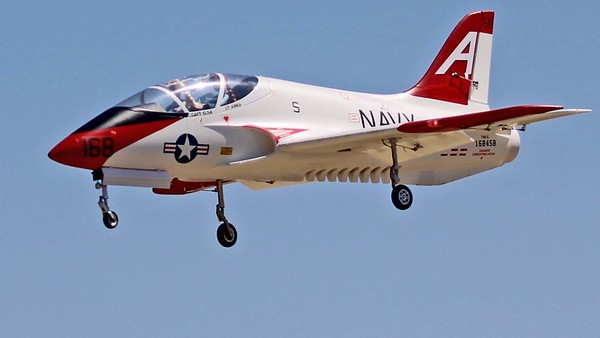

                                Looks great Wolper. Here's an aerial picture of mine captured by one of our club members. My granddaughter is (or was) into Frozen, so the pilots are the two main characters.

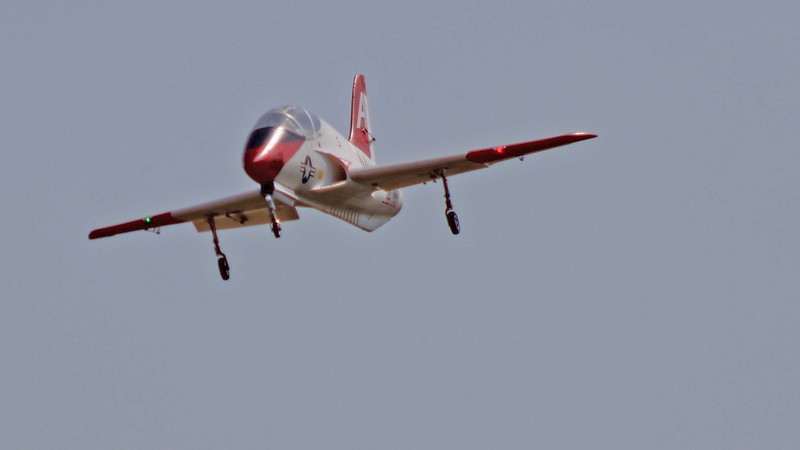

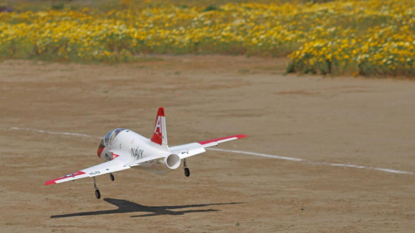

                                  I had an adventure last time - the plane was going crazy, and I figured out that only 1 flap was down! I actually landed this way - in retrospect I should have just raised the flaps, but I didn't think of that in time. I might replace the servo, I noticed it was a bit sluggish. But it was also pilot error. On any plane, it is wise to slow down before hitting the flaps, otherwise the servo can stall.
