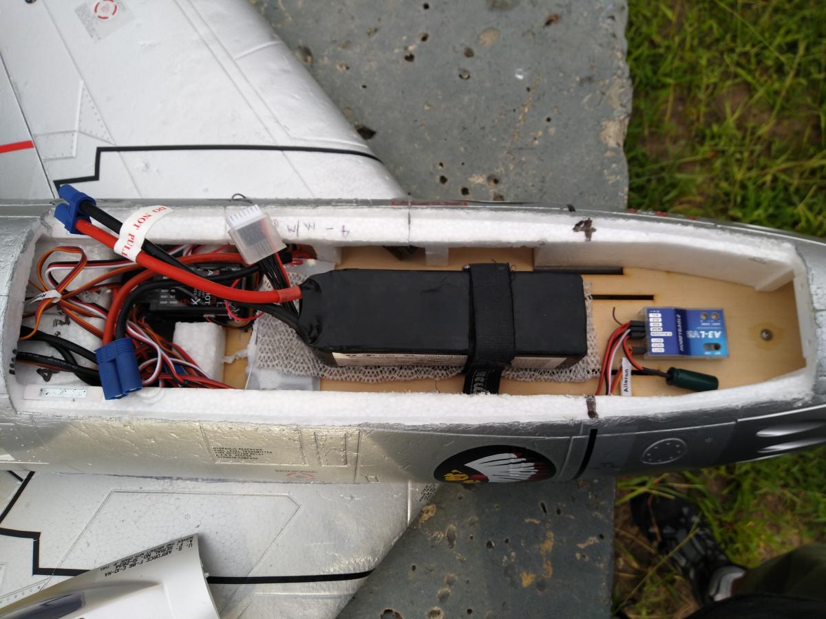

                    • Johnnyrabuse
                      winner wolf
                      • Apr 2020
                      • 136
                      • NY
                      First on mine I only fly 4000s easier on the gear second if you can find the metal retract reinforcements that they are adding on newer models get them
                      They will help save the gear from ripping out
                      Before you fly tug the gear sometimes the glues not right
                      Check that
                      On mine I have the 4000 sitting way back on top of the esc to do this I removed the wooden lockdown and used gorrila tape to hold it down so it's flat
                      I learned the hard way nose heavy is not good on this jet it will come in hot that's just me I fly neutral start off a tiny nose heavy then in flight go inverted if it dives down push battery back a little fly again do it again see what it does
                      Repeat this till when inverted it flys true then you have neutral
                      This jet loves neutral gear up when the gear goes down it just settles in sweet with full flaps it's wheelie city
                      I currently fly the high performance one on 4000s 3 minutes
                      If I go wot it comes down ten percent that's cutting it close
                      So I fly it half thottle slow flight I have other turn and burns
                      This jet flys slow great and landings are a piece of cake
                      The important thing to remember is nose heavy on this jet makes it very ...... Unforgiving unless long rotations and hot landings are your thing
                      I also put screen on my cheater vent the kind you use on windows
                      Keeps the rocks out of the fan that get bounced up by the nose gear
                      Hope this helps

                            Here's my battery placement it doesn't need a gyro mine is in there for rudder only 4000 mAh battery be sure to calibrate throttle it's airframe isn't really a high speed one I'm lucky to get 70 mph on down wind
                            It can loop ok but veritcal is limited
                            If this is your first edf and you fly 3300 to 4000s get an l 39 as your second easier to land than T 33
