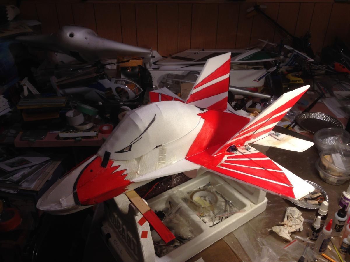

          • 8814
          This thing should NOT fly and yet ...........................
          We all know that elephants can fly but should they? (I challenged Otto to make one and in a few weeks, he did.)
