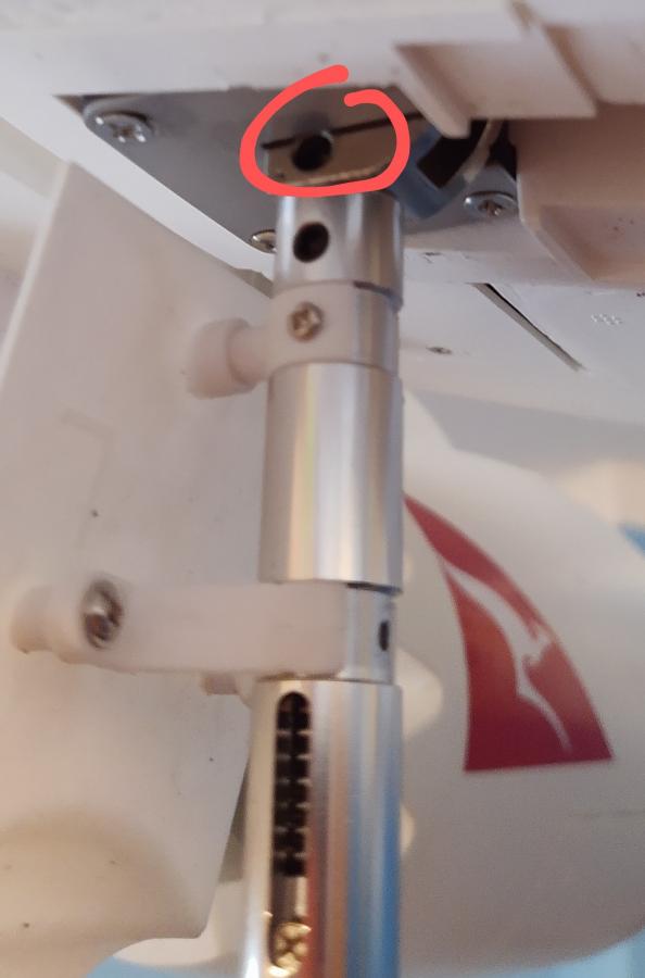

    Hello Guys!
    This week I had a partly belly landing, because one of the main gears was not coming out. The reason I discovered was loosen screws at the leg. A friend of me which has the same model from the same batch double checked his gear and found loosen screws too. So I think it's an production issue.
    Fortunately the landing was in the grass. So the only damage at the plane was some scratches at the bottom of the engine housing.
    Please check these screws at front and back!
    Click image for larger version  Name:	 Views:	0 Size:	34.2 KB ID:	278538
    Alpha : Is it possible to use Loctite for the metal to metal screwings in the production process?
    • 8835
    This is not a production issue. ALL hex screws in retracts (and other parts as well) will eventually work themselves loose just from the rigors of landing and bouncing along the runway (paved or grass or whatever). Many people will use some sort of thread locker at the time they put the plane together. Sure, you can use Loctite, but I prefer to remove all hex screws and dab a small amount of FoamTac on the threads and put the screw back in. If Loctite runs and touches plastic, that plastic will deteriorate quickly. Also, Loctite may require extra attention when the time comes to remove that screw for whatever reason. FoamTac remains a bit soft and the stickiness absorbs the vibration of routine ground running. If you ever need to remove the screw, it's not that difficult.
    PS, you might consider putting a dab of FoamTac on ALL your "C" clips, too. They've been known to vibrate and fall out and one day, a tire or strut will just fall off on take off or landing. That's not a defect either. It's just the nature of this type of design. The "real world" can defeat almost any kind of design.
