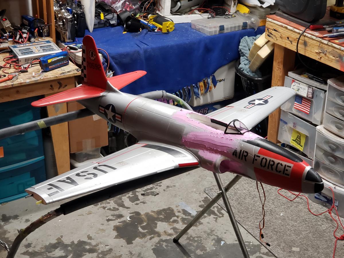

    started a new project..something ive been wanting to do for a while...a p80 conversion! Theres a good chance im going to scratch build a X1 so ive got something to chase :) my son and i love the X1..and so i thought it fitting to do a p80..the t33 was pretty beatup from its many flights..so i figured now or never lol. Check out the video as i go over the process..

      Looking good, there.
      I have been delayed on my P-80 conversion by a bout with Covid 19, a tough work schedule and a few new models this past May-sept.
      Back on it, though.
      An offer to 3D print a new canopy pattern fell though, but I did get a pattern printed for the early style P-80 tip tank. Currently making a canopy pattern from scratch in Ren tooling board.
      Need to take some new pics, as mine is now in white foam primer, after blending the fuse joints.
      Parts should go off to Sparky at Parkflyer Plastics in a couple of weeks.

        Looks great! Did you shorten the rear fuse too?

                Good ide. Panthers/cougars had similar doors. Honestly ita flying pretty well. Plenty of thrustbfor go arounds and whatnot. And that was on my less powerful packs

                  I am really enjoying your thread how is it progressing?
                  • Corsair nut
                    Jets...warbirds...mmm hmmm
                    • 218
                    • Tehachapi ca
                    Quite well! In primer! Taking her out again tomorrow :)
