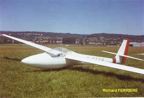

          As a slight side note my dad made an Artificial Horizon for our glider. We tried several gyros for actuation, none of which were satisfactory, we put it down to the sensors being about 4' ahead of the CG
          Still work in progress but shelved for now...

            What does the stuff in red mean? What kind of glider? 4' ahead of the CG means you've got a really big plane. That's likely too far to put a gyro sensor for it to work correctly.

              Typo error!
              It's a 15m span full size glider
                • 8835
                OK, don't know anything about those.
