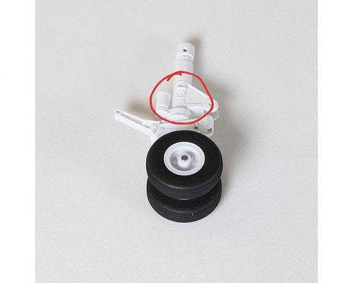

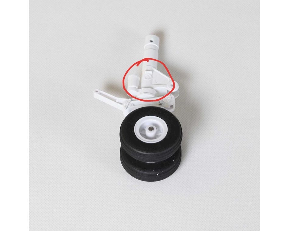

        Yea... these is possible fix for it. I couldn't find a better picture but, on the opposite side of the circled area is a screw with like a big Phillips head type head on it. Its notorious for getting a bit lose and cause that issue. Make sure all the set screws are snug as well. I've been flying the Eflite F16 and A10 and this F18...I'm not really thrilled with it. Flies heavy and the 80mm EDF seems to lag on spool up. Also...are you aware of the elevator issue? Terrible design but...the connection can separate and when it does... you are screwed with only one elevator. I would suggest fixing that if you're gonna do anything elevator intensive lots of people are having issues resulting in crashes. Good luck and...I hope this helps your nose gear issue.
