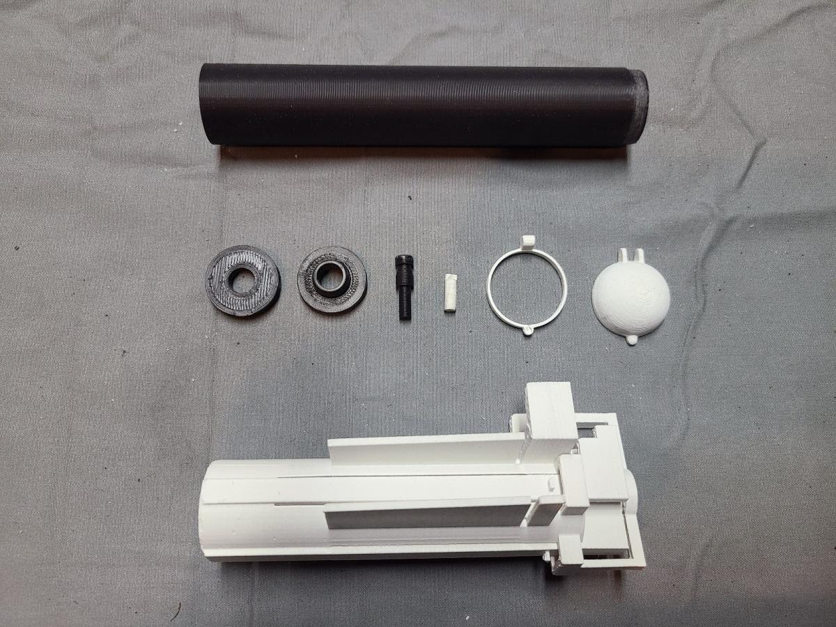

    Here are the parts as printed. They were printed on my Ender 3 Pro with Polymaker Polylite ASA filament. My slicer is Simplify 3D. The only part that requires supports is the Main Body (the big white part). Other filaments can be used but I just don't know how it would turn out with something like PLA for instance as I print almost exclusively with ASA now.

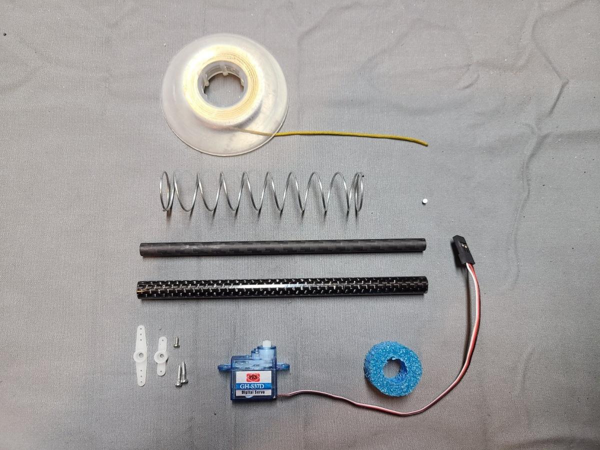

    Other things you will need to complete the assembly are shown below:
    Click image for larger version  Name:	Image_1610751843.jpg Views:	0 Size:	205.7 KB ID:	294726
    They are as follows:
    • Some kind of strong thin cord
    • 1 spring - Hillman #543018
    • 2 - 2mm x 1mm rare earth magnets
    • 1 - 130mm long piece of 4mm carbon fiber tube
    • 1 - 130mm long piece of 6mm carbon fiber tube
    • 1 - GH-S37D servo and it's hardware
    • 1 - foam donut. I used some of a blue camping pad. It is closed cell and about 1/2" thick.
    • 1 small piece of piano wire or equivalent. A pin would work. (Not shown)
    • 1 servo extension about 36" long. (Not shown)

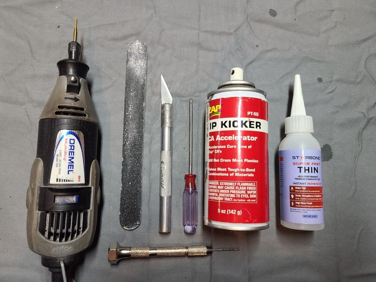

    Some tools that will be needed.
    Click image for larger version  Name:	Image_1610751882.jpg Views:	0 Size:	203.3 KB ID:	294725
    In addition you will likely need some 220 grit sandpaper, a razor saw and some FoamTac glue.

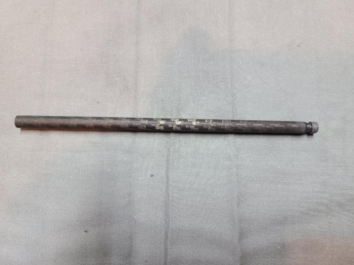

    Once you have the additional items you will need to assemble the mechanism, start with the plunger and insert the 6mm carbon fiber tube until it is flush with the face of the piston and glue it in place with some thin CA.

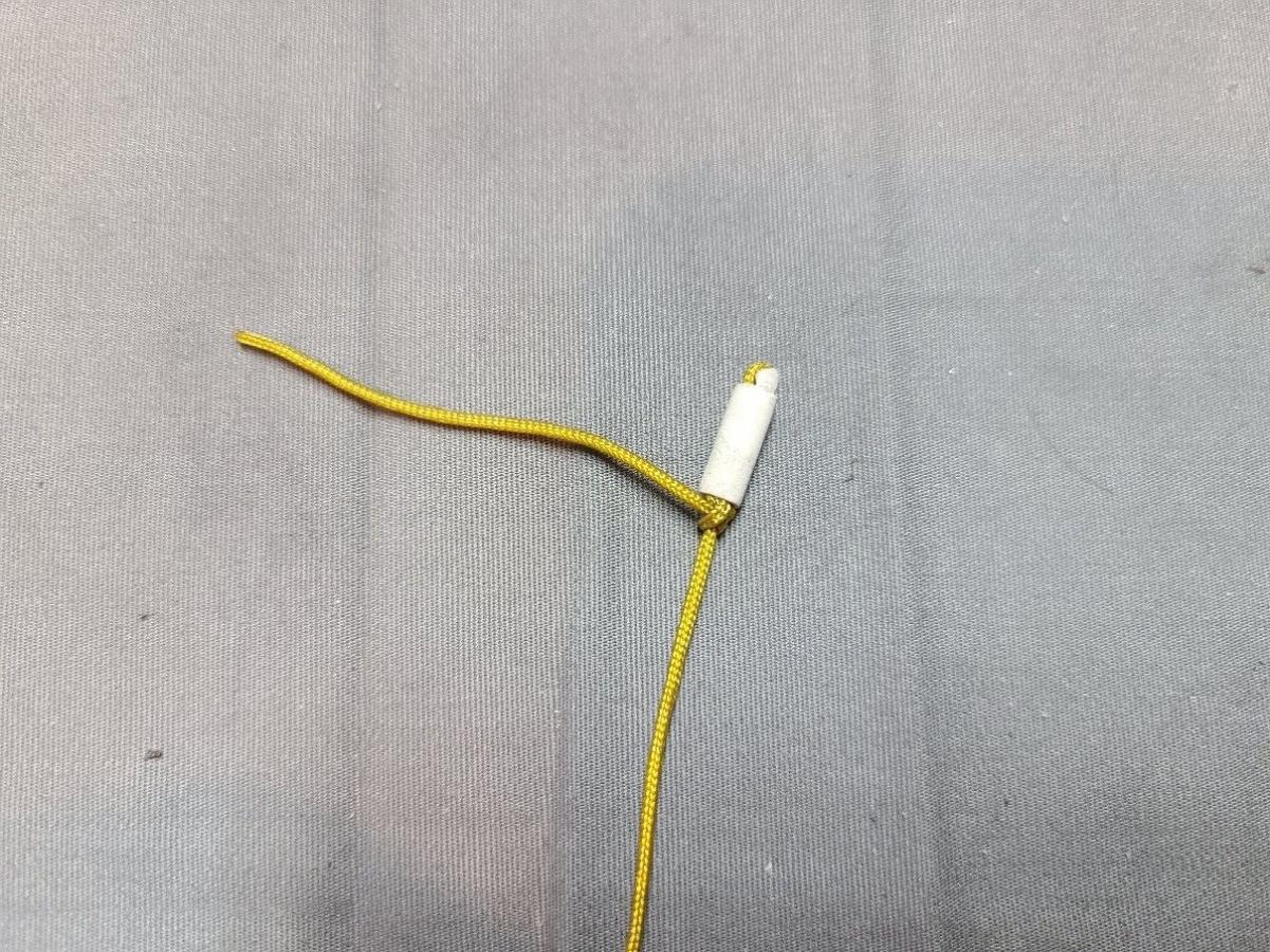

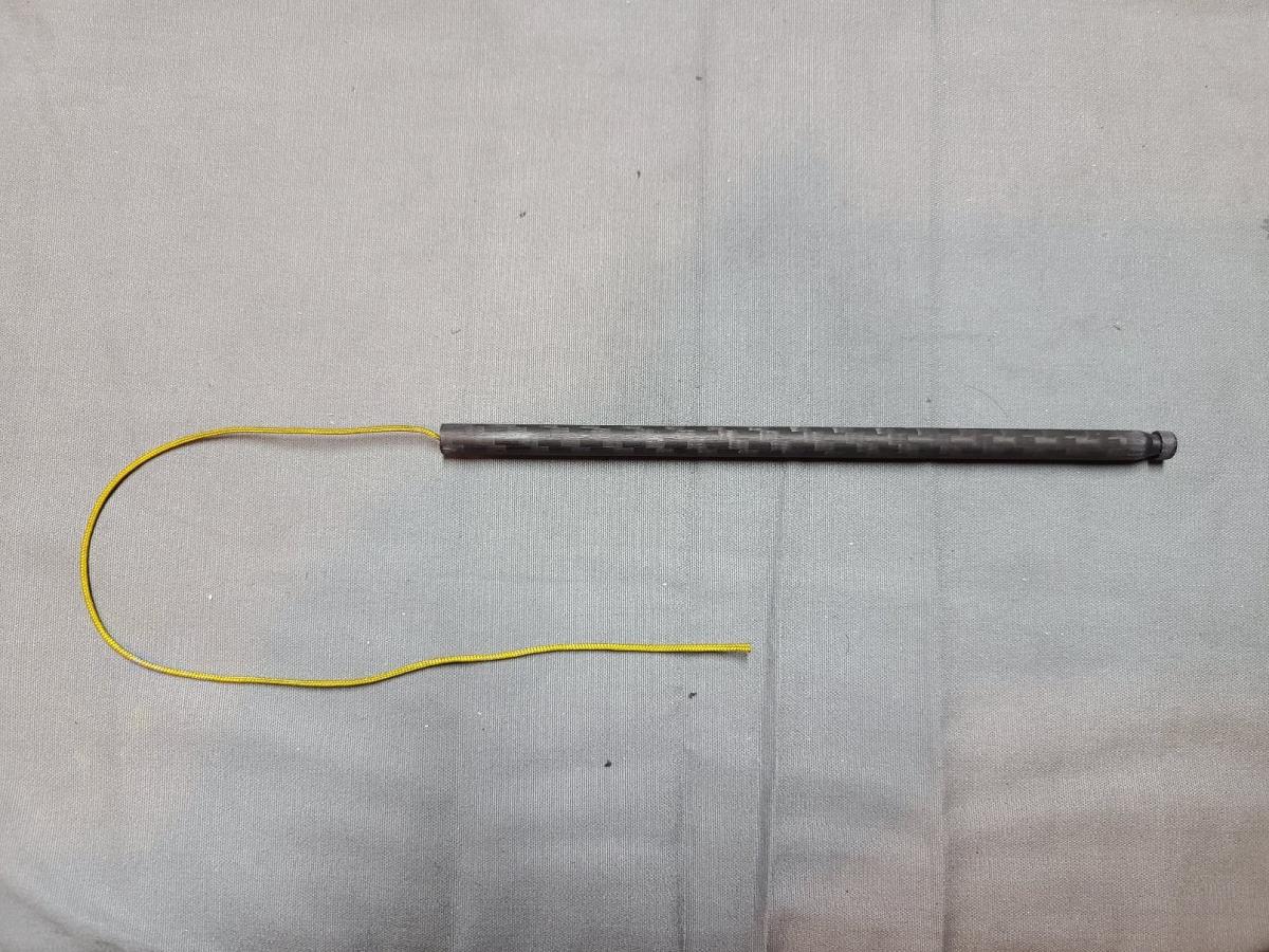

    Now, take your thin cord and pass it up through the cord anchor, over the cross member, back down through the anchor and secure it with a knot. A small drop of CA on the knot will help it to not come untied. When done, insert the anchor into the open end of the 4mm tube and CA it in place. Leave about a foot of cord. It will be cut shorter later.

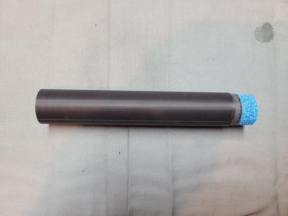

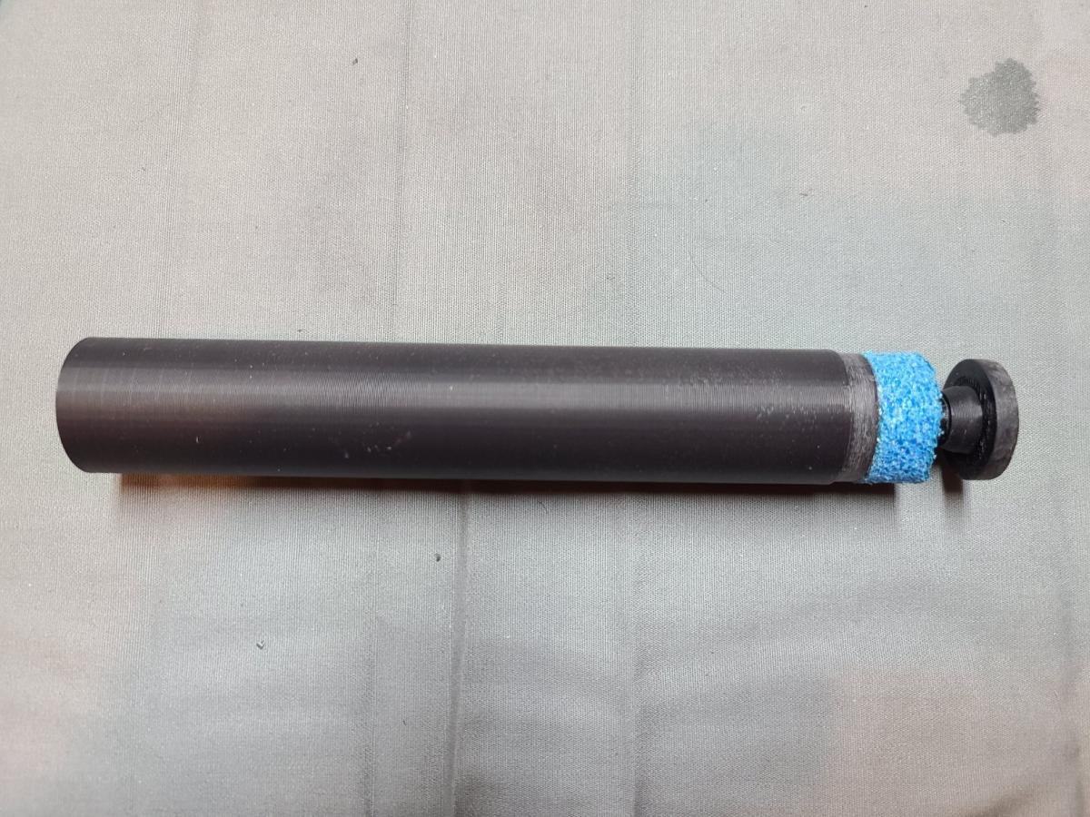

    Then glue the foam donut to the end of the chute tube using something like FoamTac. Make sure the hole in the donut is big enough to accept the tapered shoulder of the chute trigger plate.
    Click image for larger version  Name:	Image_1610751937.jpg Views:	0 Size:	197.7 KB ID:	294927

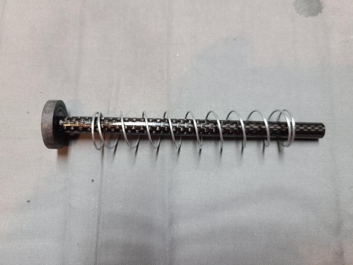

    Next, slide the spring over the 6mm CF tube, insert the piston assy into the chute tube aligning the 6mm CF tube with the hole in the front end of the tube. Insert the 6mm CF tube into the chute trigger plate taper shoulder side first until it is flush on the forward face of the plate, then secure it with thin CA. The piston assy is now complete.

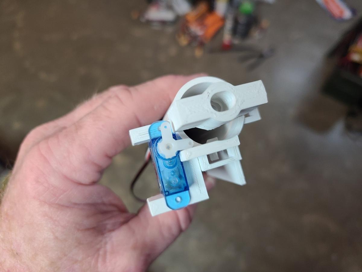

    The main body will be next. This is the part that will need the most attention, teimming and sanding. Once the support structures have been removed you will clearly see the dezign intent. The critical things to make sure of are that the triggers are free to move. The chute trigger is easier to do than the jettison trigger. I used a length of sandpaper to get in between the catch block and support beam until it moved freely. It needs to be tested with the 4mm CF tube and release catch inserted into the block. You will likely need to do some minor trimming with an Xacto blade to permit the catch to easily insert into the block and actually seat into the lip of the catch. This is critical to the function of the jettison feature so take your time and only remove small amounts of material as needed and again ensure there is no binding. Testing the fit of this will require that the chute tube is inserted into the main body and that the piston is in the cocked and ready to fire position. You must also make sure that the 4mm CF tube and catch assy slides easily inside the 6mm CF tube of the piston assy. I think you get the idea by now. Just do your best to make sure the jettison tube is easy to slide into place and the catch block slides sideways to allow the catch to seat and the catch block to return to its original position. You also do not want it to take a lot of force against the catch block to release the jettison tube. It is basically just like one of those toy dart guns.

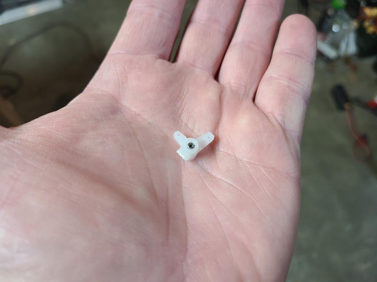

    Now it is time to install the servo and horns. This is where it gets tricky. I ended up using a long and a short horn and turned the short horn over on top of the long horn. This way I was able to position the short horn to delay pushing on the jettison trigger block. I added some FoamTac to help glue the short horn in place and secured it all with the screw provided with the servo.

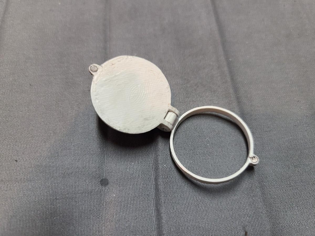

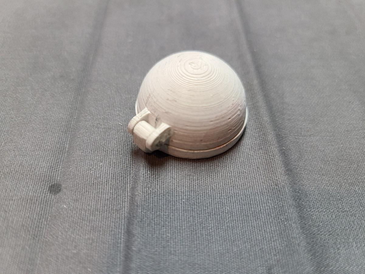

    The last thing to do is assemble and secure the hatch and hatch ring. The hatch is held shut with two small 2mm diameter x 1mm thick magnets. You will need to clean material out of the magnet pockets in both the hatch and ring to allow the magnets to seat flush. Glue the magnets in place with CA. Sand the hinge faces if necessary until the hatch and ring fit together without any binding. Now, using the small hinge pin location marks on the hatch ring, drill them both for the hinge pin you have selected. The hinge pin should be just long enough to barely extend past the outside edges of the hatch ring hinge forks. Secure the pin on each end with a small spot of medium or thick CA and make sure the hatch moves freely. Make sure the hinge is positioned on the bottom of the chute tube and that the hatch fits flush on the end of the tube then secure it with some thin CA.
    Click image for larger version  Name:	Image_1610752112.jpg Views:	31 Size:	205.3 KB ID:	295389
    Click image for larger version  Name:	20210103_183400_copy_1209x906.jpg Views:	30 Size:	181.1 KB ID:	295390
    Position the hinge like this.

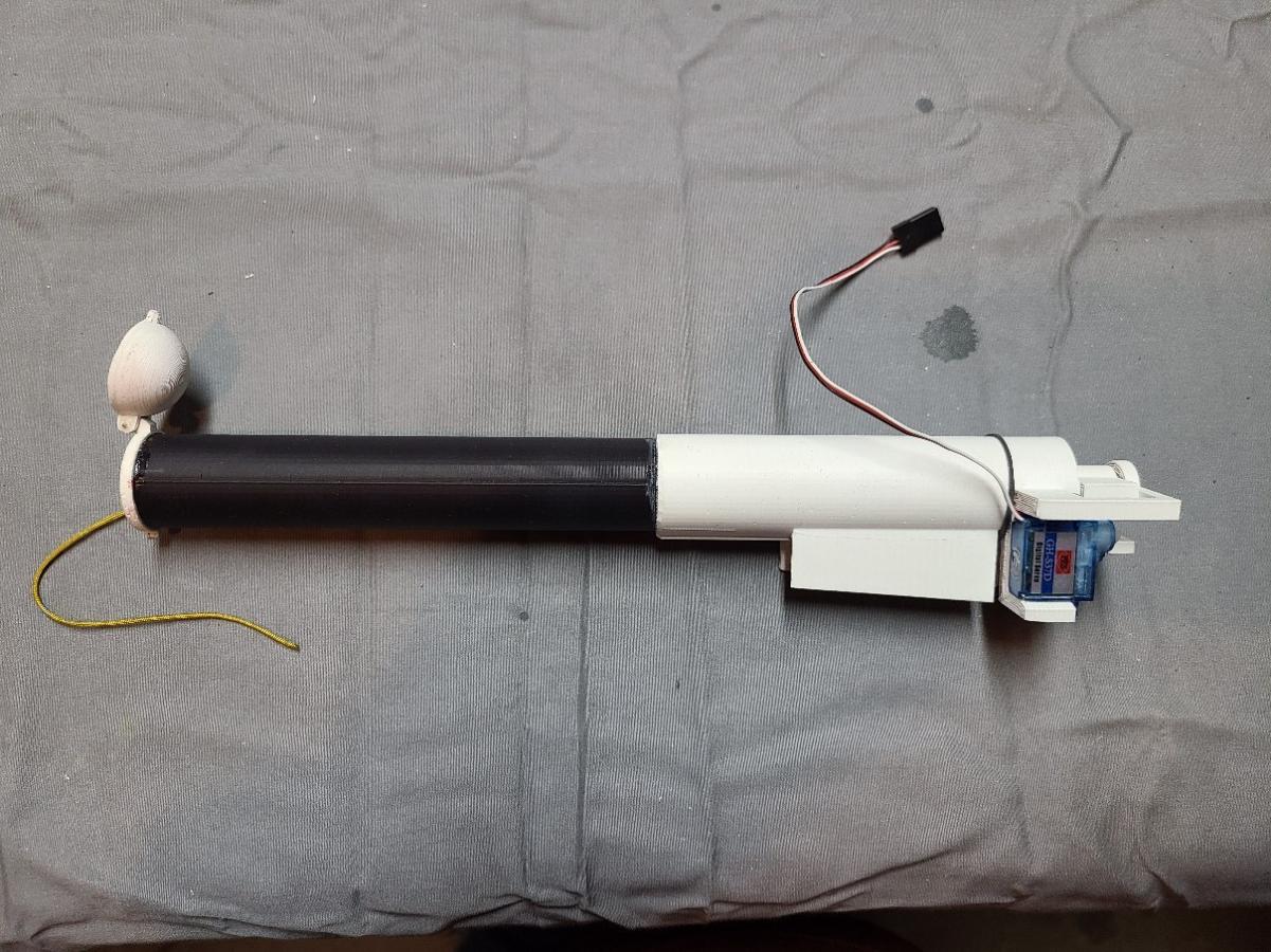

    The mechanism assembly is now complete and ready to be installed. The final piece of this system is the chute and I highly recommend the chutes from Paul for their fit, appearance and quality.

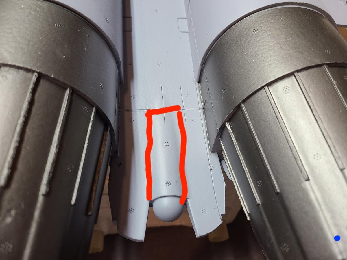

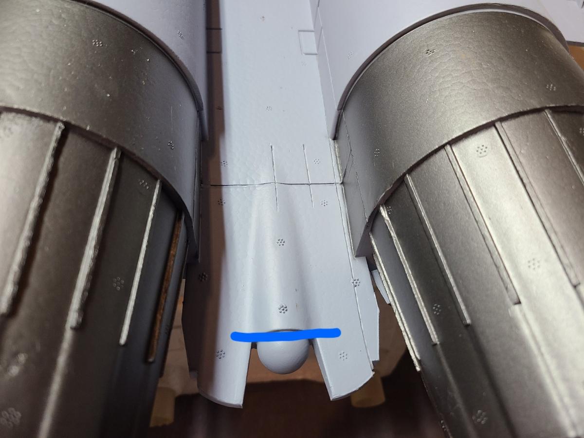

    When I initially installed the mechanism on my plane I cut the whole back end of the fuselage at the panel line between the nacelles and then carefully bored a hole in the foam for the chute tube to fit but the foam ends up being very thin and it is not easy to bore straight. Therefore, I highly recommend removing the whole chute tube section (in red) instead and then filling/blending it back with some light weight spackle instead.
    Click image for larger version  Name:	Polish_20210209_001702482.jpg Views:	0 Size:	102.4 KB ID:	298608

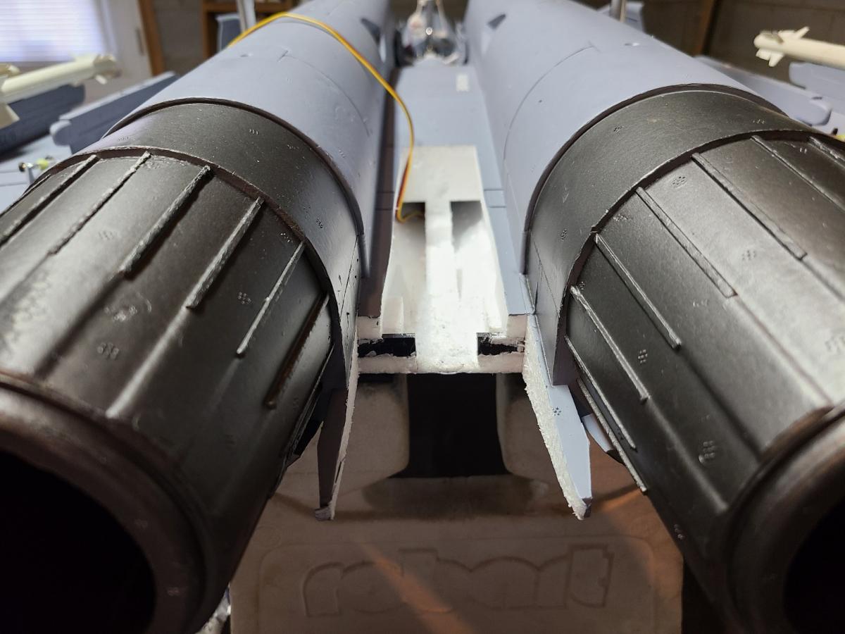

    At the panel line you will discover the carbon fiber alignment spar so just cut all the way through the foam and up to the spar wide enough to receive the chute tube. Next, cut the foam between the nacelles on the other side of the CF spar about 40mm wide up to the 275mm mark you made earlier. A rib of foam exists in the center of the fuselage between the nacelles so do your best to separate the rectangular plate from it trying to leave some of the rib intact to later secure the tapered tabs on the mechanism main body to. All I can tell you is that if I can do it, you can too.
    Click image for larger version  Name:	20201114_130941_copy_1612x1209_1.jpg Views:	16 Size:	100.4 KB ID:	298609
    Next, using a razor saw, cut through the CF spar making sure that the gap is just wide enough to accept the chute tube. You should have something similar to the photo above when done. It is very easy to now pull the servo extension into the radio compartment with a wire.
