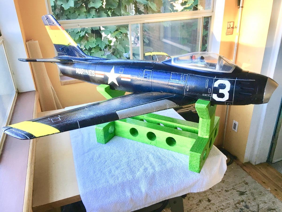

          The North American F86 Sabre offered by Freewing in 80mm available as a standard PNP and High Performance version. This classic jet looks great and can be done in different schemes although the silver USAF scheme is cool. It glides great and lands easy. Many say, if you can't fly this gal, you need more training flight time. I love my dark blue Marines scheme I made up, but it did "gator" in the sun though...But, it breaks the laminar flow....Kind of like driving a speed boat with a slight ripple on the lake...The T33 or perhaps the A4 Skyhawk would be a good choices too...

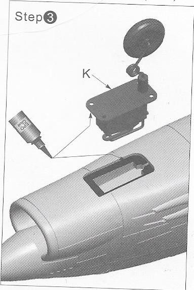

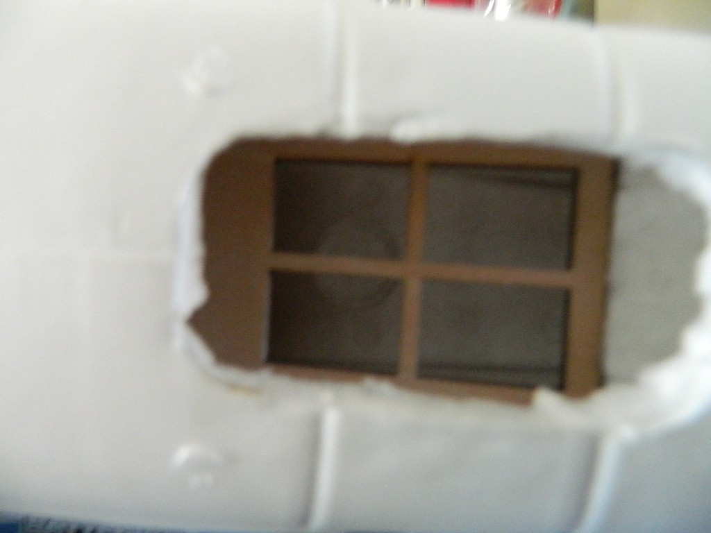

                                  My lad's having all sorts of problems with his Freewing F-8 crusader and after he contacted the Motion RC chat line is no further along with his installation of both radio and nose gear.
                                  The chat person advised cutting out the aperture for the nose gear and when he did he was left with a gaping hole with no means of fitting the noseleg which doesn 't fit anyway. Secondly he required advice as to the servo connections to the receiver for this particular model.
                                  I was present during the chat session and had the distinct impression that the'advisor' was not really au fait with this model or any other like it
                                  Any help chaps ?
