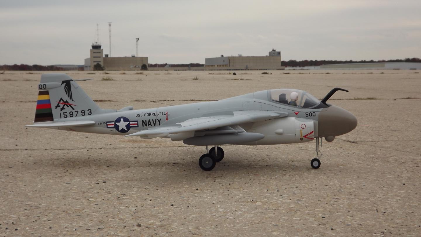

    The A6 Intruder model comes with a 12 blade 80mm ducted fan. Is it possible to use a 90mm ducted fan or will this weaken the foam air frame. My landing abilities are questionable, so I don't want to weaken anything. I've read a couple of reviews claiming this model is under powered, but none of them have described the power plant in use. So who knows if it is really short on the power side. I spent 3 years working the A6A avionics and know this plane was not designed for speed but to hall around 28 500 pounders (14000 lbs). I not looking for hi-speed but enough power to provide good maneuverability. Any thoughts or advice will be greatly appreciated.

    I fly the A-6 on the stock 12-blade 80mm setup. And while this jet is by no means a barn burner, it is definitely NOT underpowered. It has very scale-like flight, but handles slow flight very well. The key is to keep it as light as possible (I use a max 4000mAh lipo), and keep it clean. I don't fly with the fuel tanks anymore, but I did get the bomb racks as it just looks too cool to fly without them. With this configuration, she flies just fine, can loop and roll, and lands almost at a walking pace with full flaps and minimal power.
    The only thing to look out for is to make sure you keep the speed up in the turns. But that's the rule for almost every jet. Otherwise, she's an excellent jet!

      Something else to think about. The inlet on this jet is not the best, asking it to feed a larger fan might actually be counter productive.
      Another possibility is to go with an inrunner 80mm fan upgrade. This probibly won't help with low speed thrust but might help with top end thrust/speed.
      http://www.motionrc.com/freewing-80m...-motors-black/
      I do like the upgrade in my Mirage 2000 and F5-Es with 1850KV motors. But as Pat said watch the weight. The larger power will need to be fed, and that usually means heavier batteries. I'm sorry to say but often power upgrades result in LESS performance as the variables often conspire against each other.
      Remember that with jets almost all the review are guys wanting to go fast and faster (that is why they are into jets). So they almost all say "X" model needs more power.
      Run her stock and clean. As you said you need some work with landings so work on that. I can tell you seeing a guy make a 200 mph pass and then bounce, tip, and over shoot the runway does not leave me with a good impression of his piloting skills. Now landing in a 90° cross-wind on the numbers now that takes pilot skill!
      Going fast does NOT take skill, it just takes power!

        Hi there, Skip, first of all thank you for your military service to our nation! Our Freewing 80mm A-6 Intruder really is best in its stock PNP format. Trust me, I flew Freewing's first pre-production prototype and have logged hundreds of flights with it over the past 2.5 years. A 90mm EDF unit wouldn't fit, and its inlet and exhaust diameters are all wrong for a 90mm fan, anyway. It would be a challenge to make CG with the model as well, based on its available battery compartment size. I find the model flies very scale, with power for non-scale loops and inverted flight without any issues. If you're itching for nonstop vertical climbing power, that's the only time I'd recommend considering the Inrunner/100A upgrade.

            I have the A6 for the past 2 years and I fly this stock so I can in form people the truth about our jets and plane. On this jet here I find it to be a perfect balance of power to weight and to the way the original had flown. Like some one else had said this is not a super sonic jet at all quite like the A-10. It was built to be a precision light bomber low to the deck flier. For that roll speed does not mean to much go under the radar be able to see what kinda soup some one is eating and let the bomb drop in it and get out. This model does that to perfection and above like loops ,rolls,inverted even semi decent knife edge. I have flown this in clocked wind speed of 18 mph wind guest of 21 mph and did awesome (crosswind). Landing was fun but handled it OK and no I do not use a gyro in this not needed. I think another thing to mention is the way this can glide as well. with about 500 feet put the flaps to half flaps I can almost get 2 100 yard circles and land with out giving power to it. I also fly this off of grass with great success. The only real flaw I find with it is on crosswind take off if your not ready for it and you have the wing up just a little bit the wind will roll it over immediately so watch out for that one. All in all it is by far the best jet I have ever flown and I would recommend to a person jumping to their second jet by far.
