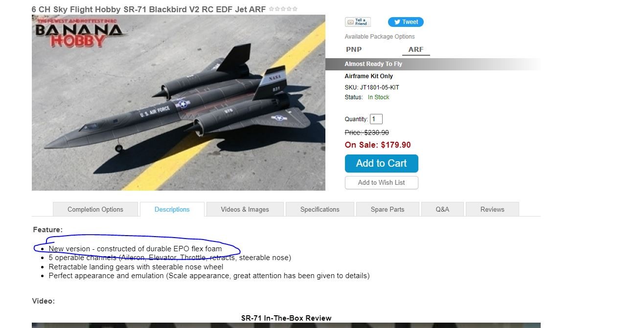

                    I am alittle late to the show but I owned two of them and if you toss in a flight stabilizer the CG is not as much as an issue and it makes landing her perfect. Aros and I both had DON's Wicked motors for our setups and the sound was sooooooooooooooooooo freaking sweet and the speed good. Mine got killed when a battery dropped out and one of the motors dies down from the power loss, I was flying too slow an low to recover. I am about to buy another one since they say it's now made of EPS foam, if this is the fact then I will snatch one up soon, same with the YF-23.

                        Correction : EPO FOAM not EPS.. according to BH website
