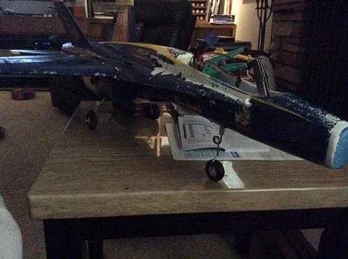

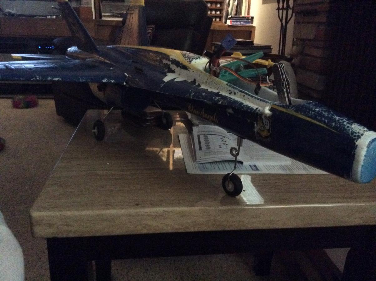

    While I have been content to have plenty of turbine time in my logbook, I have been happy fly prop scale planes...That changed on Sunday when I was gifted an Entry level jet - Force RC Blue Angels F-18. It is the PNP with upgrade motor and ESC - even gave me a battery.
    So my question is what reciever programs anyone use with AS3X - I have a 636 ready I think would do the job, but wanted to get something of a SAFE mode.
    I have time, since I want to clear coat before I get my hands on it...Never flown NIB and have some good help at the field for upgrade training.
    Click image for larger version  Name:	16CE038D-A36E-436B-A5C6-C578398857C7.jpeg Views:	148 Size:	149.2 KB ID:	316530Click image for larger version  Name:	4E5F962E-ED4F-4442-948D-4FAADE51EFD0.jpeg Views:	172 Size:	135.9 KB ID:	316528Click image for larger version  Name:	53214956-917B-4767-9DC5-FBC471E3733D.jpeg Views:	146 Size:	132.4 KB ID:	316529

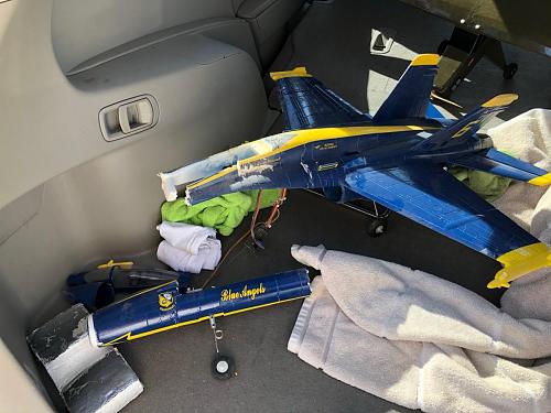

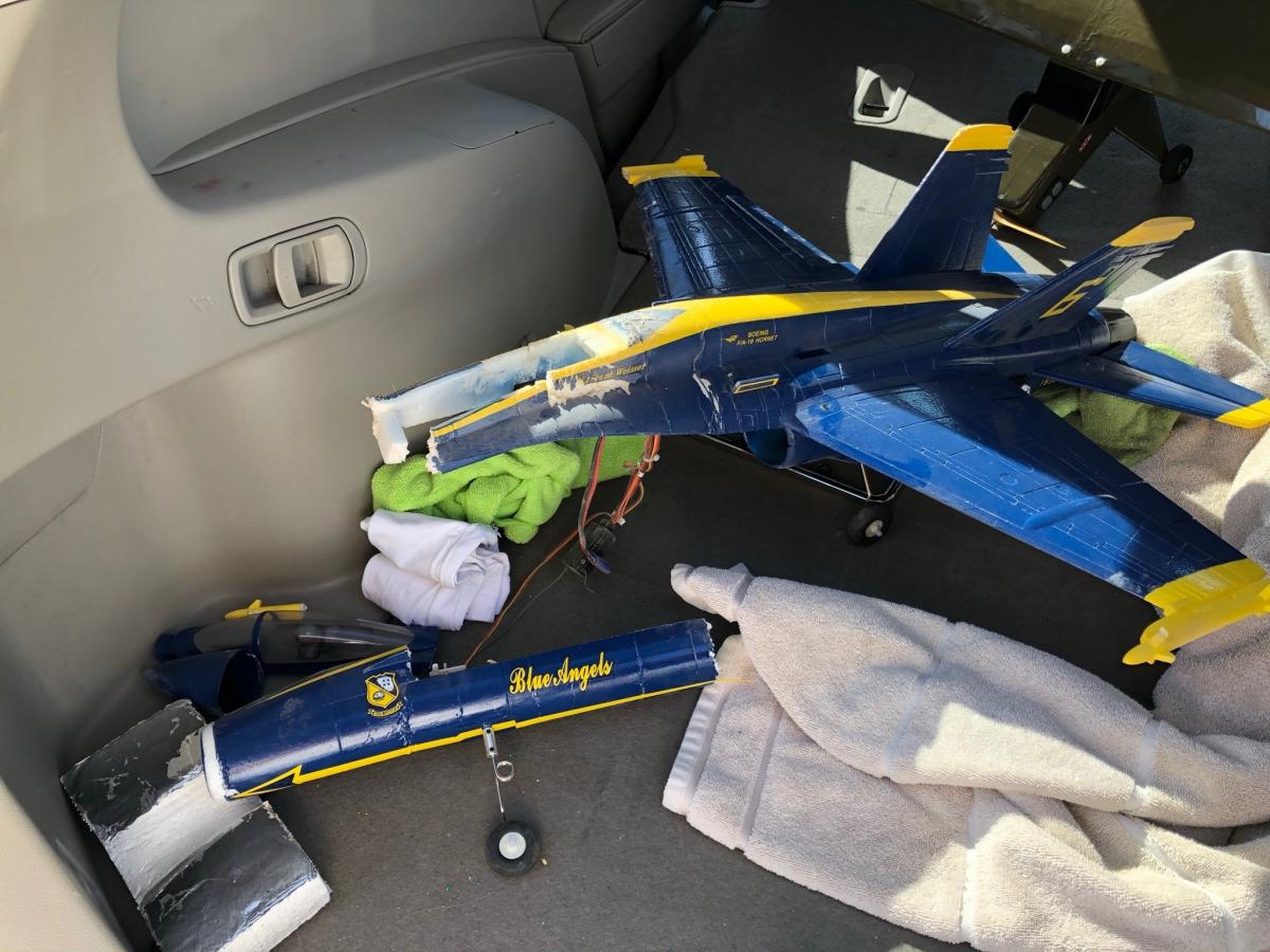

    First brief flight was a disaster. Wing fasteners were secure - but the molded and glued at the factory plate was not. Rolled inverted and went for a dirt nap right after rotation. Some Gorilla Glue and primer/paint and it was ready again. Next flight went well and my first EDF flight with a model is in the book. Got 2 more on it and no more glue necessary.
    No gyro, no SAFE, no AS3X, Just low / high rates and a little expo. For a 64mm - pure fun with a 4S 2200 and get 5 minutes with mid range throttles in flight.

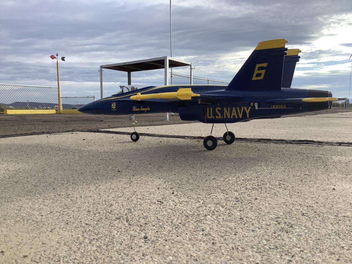

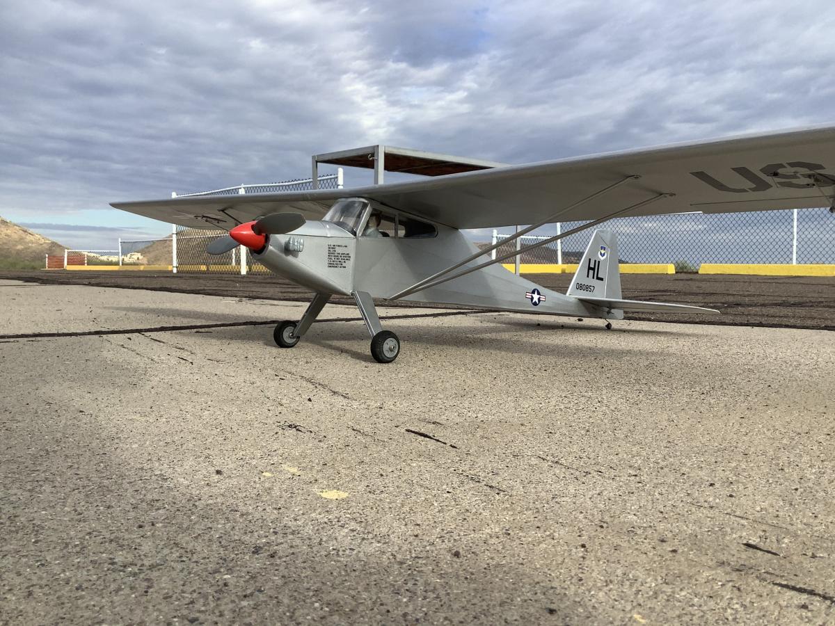

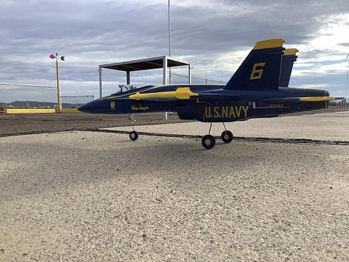

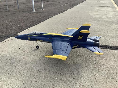

          A good rain last night made for a cool morning. A few circuits in the pattern early were fun, but heat and humidity (+ allergies) had me heading home by 8 AM. Click image for larger version

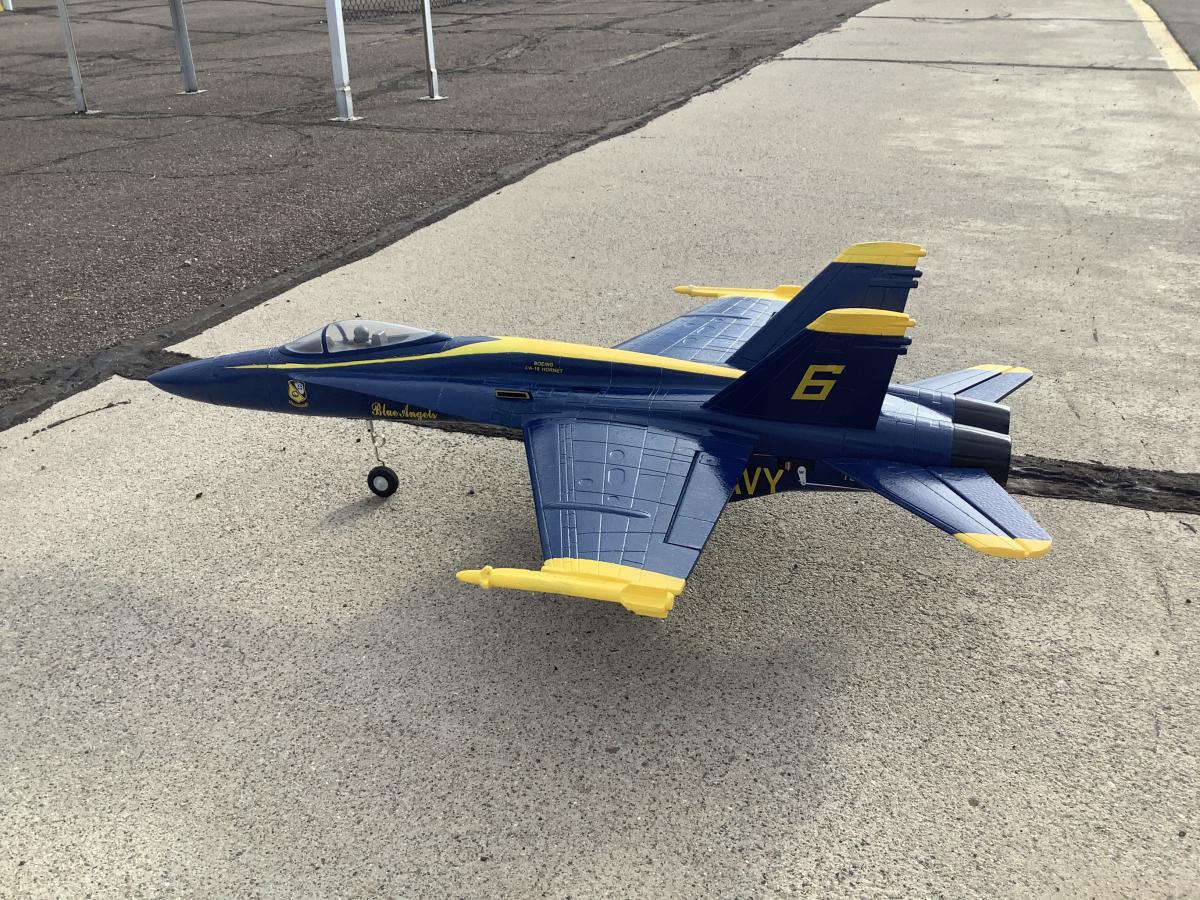

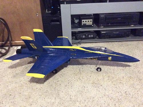

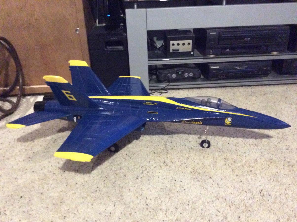

            A little experiment - that worked a ton.
            • #7
              So each add-on wing tip was 3/4 inch x 1/2 inch balsa to start. Those silly foam missiles were flimsy and easily snagged on, well anything. After sanding and clear coat, a little monocote and poof - an extra 1.5” of wing. The difference in performance is impressive.
