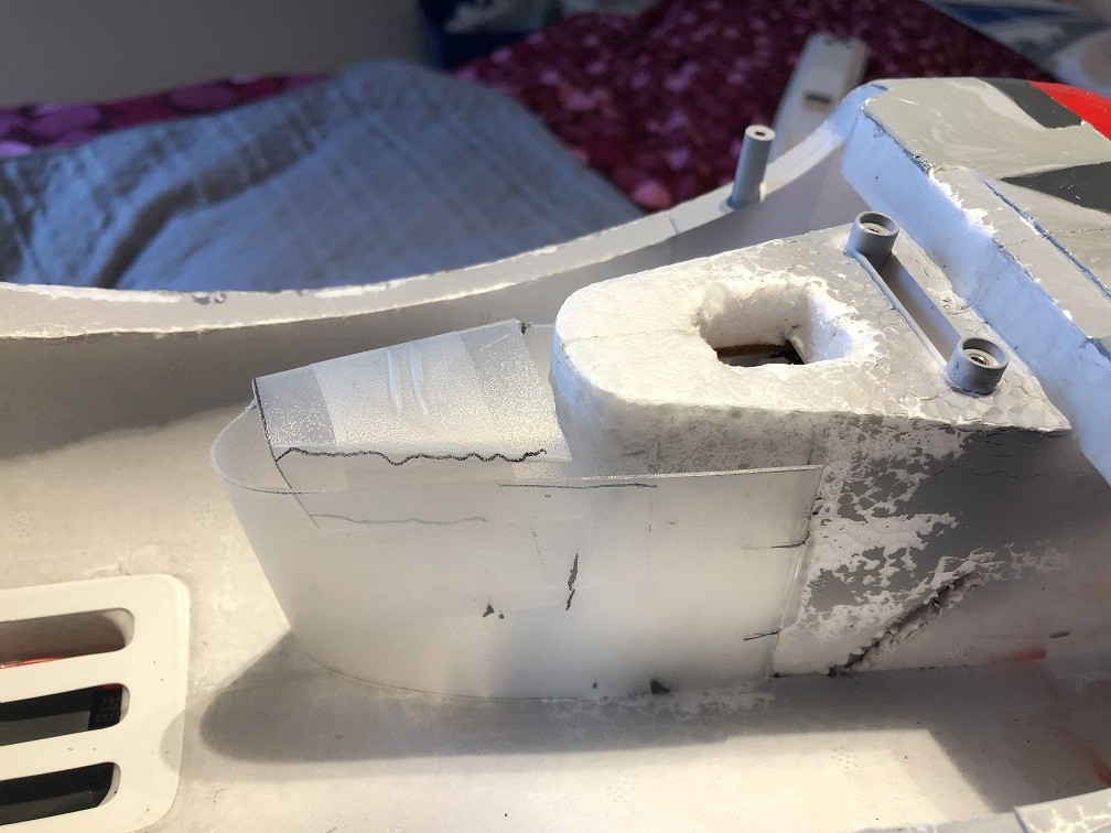

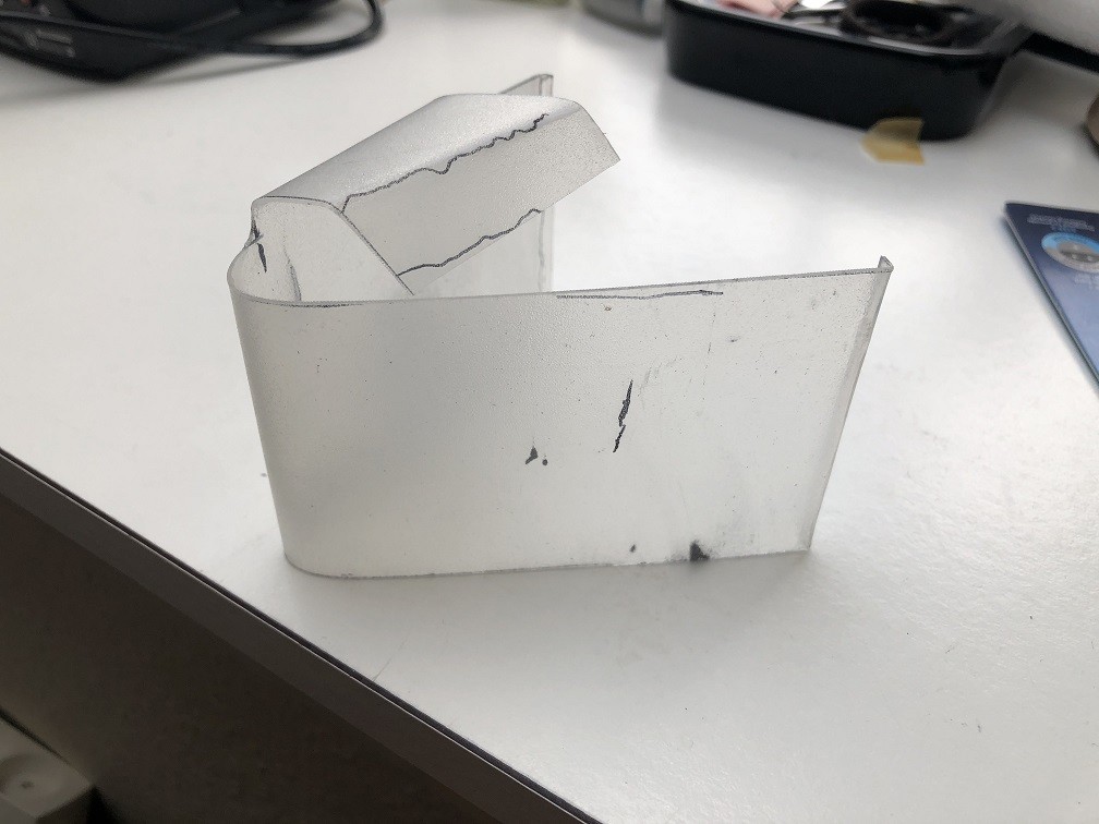

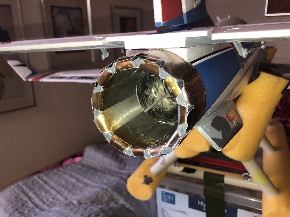

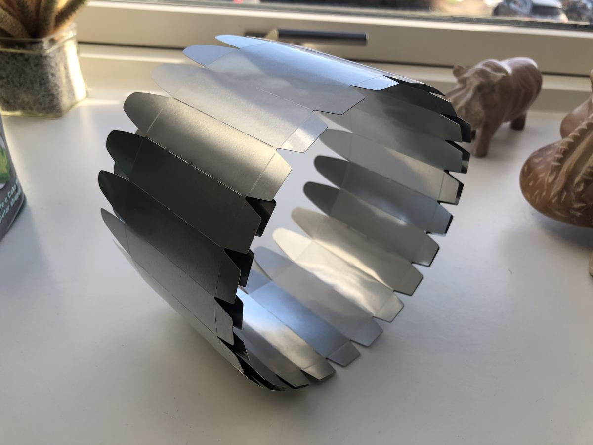

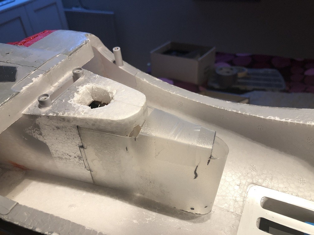

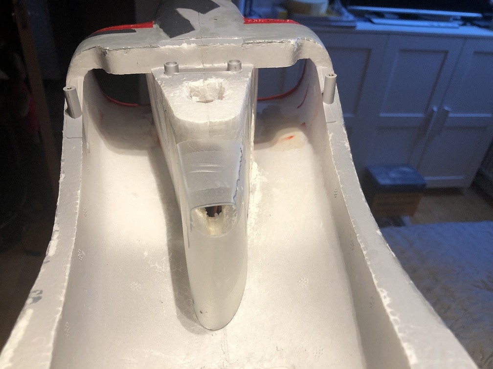

    Hi. Unfortunately i did somehing wrong along the way My Viper is now unflyable won't rotate. If the cause is too much added weight because of the extra bec 15gram or the centerburner 30gram and the nozzle tube 19gram and some paint i don't know? If i’m cutting cheater holes in the Viper where exactly should i cut e’m? Or would a new fuselage be the solution?
