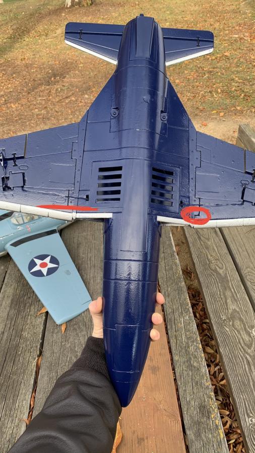

Yeah I have the F9F and trust me, the stock CG is waaaaaaaaaaaaaaaaay too far back. I could barely control it like that. Attached is a picture showing the cg but if you can't see it, then on the bottom of the wing, the 2 "tabs" that you glued the wing on, you'll want it to balance on the leading edge of the forward tab. Flies like a dream. Hope this helped!
