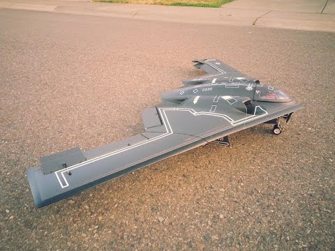

    I bought this at an RC swap meet last Summer...Always wanted one but all the horror stories about instability, crappy gear and so on, kept me from purchasing. But I got it for a good price and saw on a build thread that several were having success as long as you set it up right.
    The maiden was a success, but just like everyone said would happen, the front nose gear collapsed on the landing, even though the landing was actually quite good. This was a known weak spot. Classic LX...Awesome looking molds, but absolute garbage tinker toy retracts.
    I've decided I want to remove the gear and make her a belly lander. I'll seal the front doors closed, remove the main doors and use the main door bays as my grip. The question then becomes, can the stock power setup handle a hand toss? Even if it's a running, strong toss? I can always test it, and assuming the toss is strong enough with the proper AoA, hopefully the worst thing that could happen would be it falling and plopping unceremoniously on the grass without any damage.
    Might be a great platform for a Don's Wicked setup? Anyhow, was wondering if anyone has experience with this bird that could offer some insight?

                    I got tired of the craptastic LG so I removed them. Had to add a boat load of weight to the nose (ugh) for CG but I did what I needed to do to make her a belly lander.
                    Well, we have a hand toss success!
                    Sort of...
                    My buddy gave her a good toss but as I was preparing, she sunk rapidly and even smacked into the grass but I kept full power and full elevator deflection to see if she would get airborne and by God she did!
                    She actually flew the best yet...In the brooding rain no less.
                    The only damage came on the landing when one of the bottom clam shells ripped out on impact as did a small portion of wingtip. Nothing a little CA can't fix. However, I'll definitely need to get some servo arm protectors and maybe some leading edge wedges that absorb the most at point of impact.
                    I'm going to also add a hole at the center section aft of the bomb bay doors so there's somewhere to put another finger when tossing to help create additional grip and better release. Right now I only have two holes, both on the sides of the outer bomb bay doors.
                    The good news is with some tweaks, this can be a belly lander!
                      Glad you ditched the stock gear, it's ATROCIOUS. Convert to the Dynam T-28's retracts, or Eflite's 1200mm T-28's retracts, or better yet as you've found, just hand toss the darn thing. I'd recommend putting the gripping holes about an inch forward of the CG on this bird.

                        Yeah the grip holes are actually pretty dang good where they are at...I added the center/aft hole which will really make a difference on authoritative throwing. My buddy said had he had that center/aft hole he could have really been able to push off with more velocity which may have been the difference between falling like a rock and holding altitude.
                        Good to know on what retracts I could substitute but I think I'm now "All In" as a belly lander for her. :D
