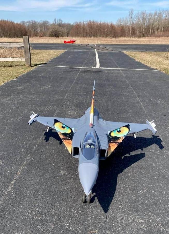

                onboard my 8S powered Gripen:
                (still having issues with gear door closing correctly...working on it)HET 700-60-1865 / JetFan 80RT 45C 4500 4S X 2HobbyWing 150A ESCRuncam2 4K
