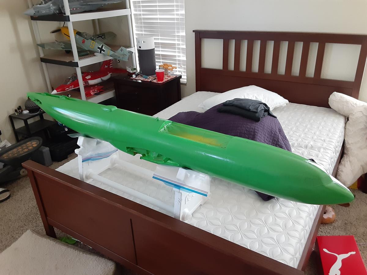

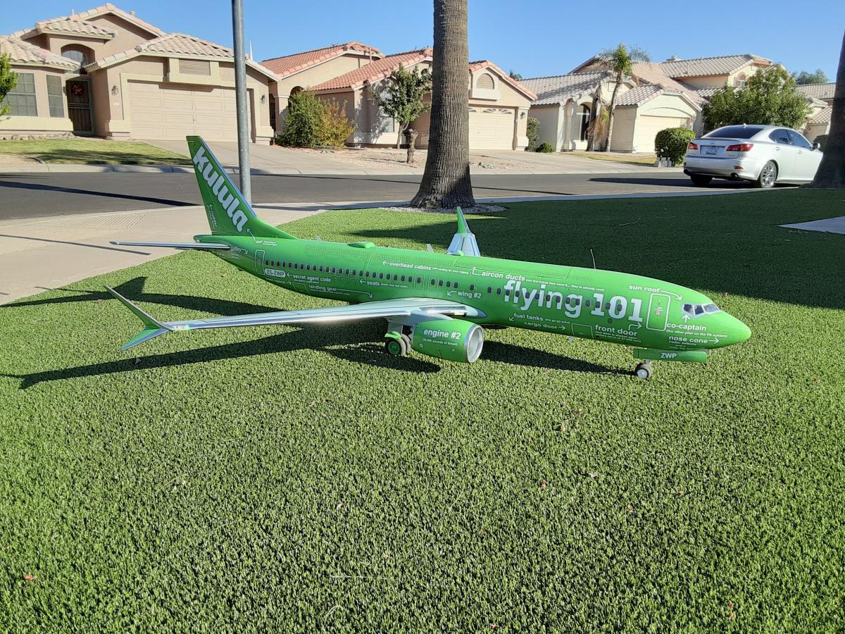

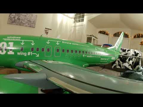

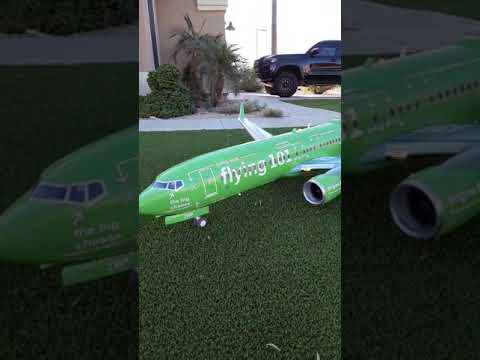

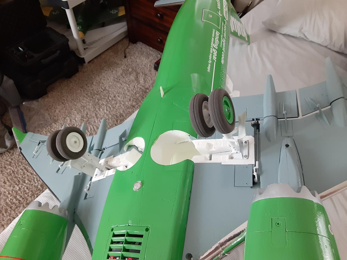

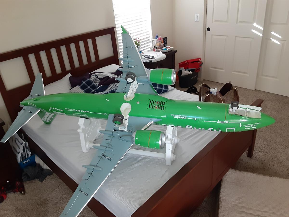

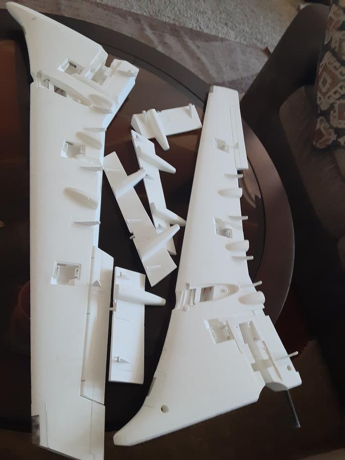

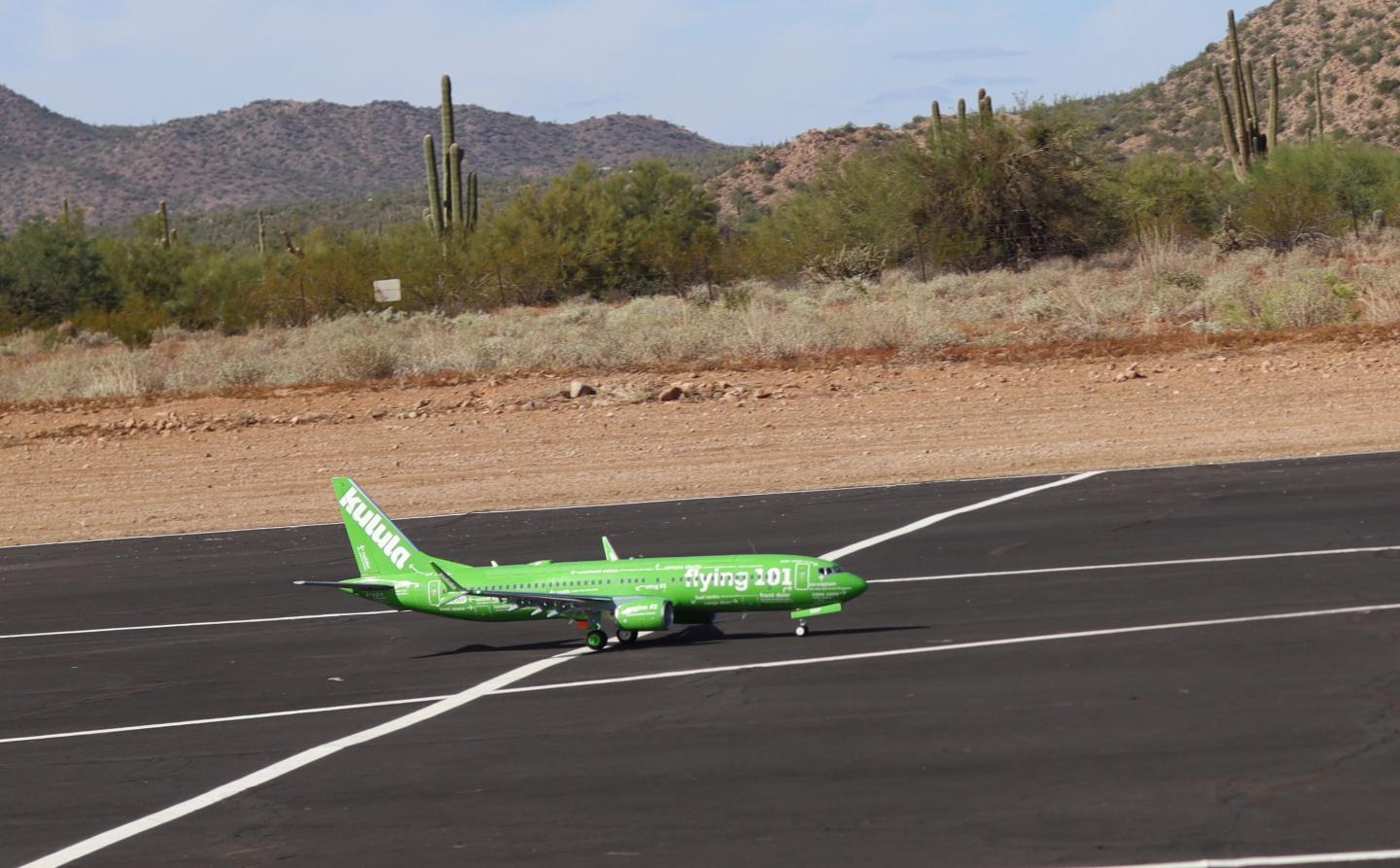

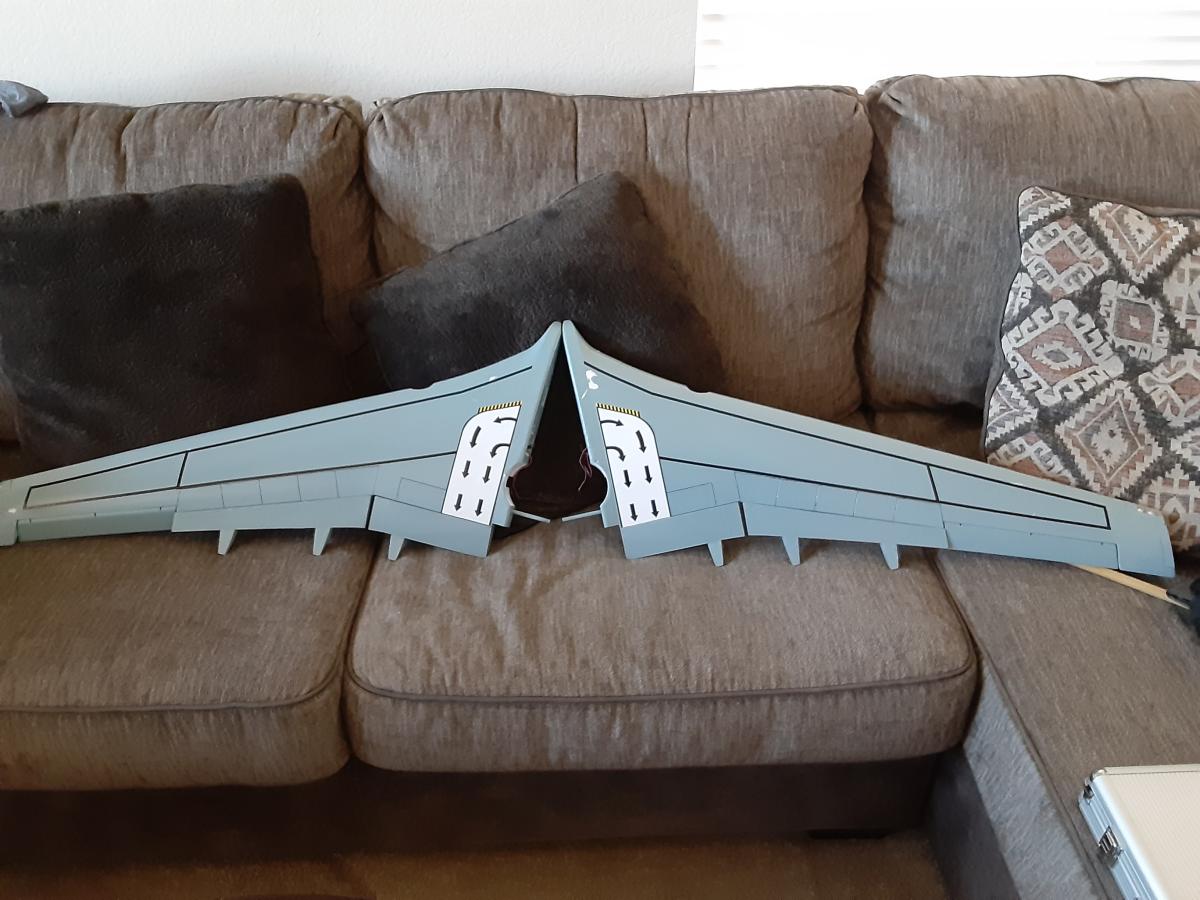

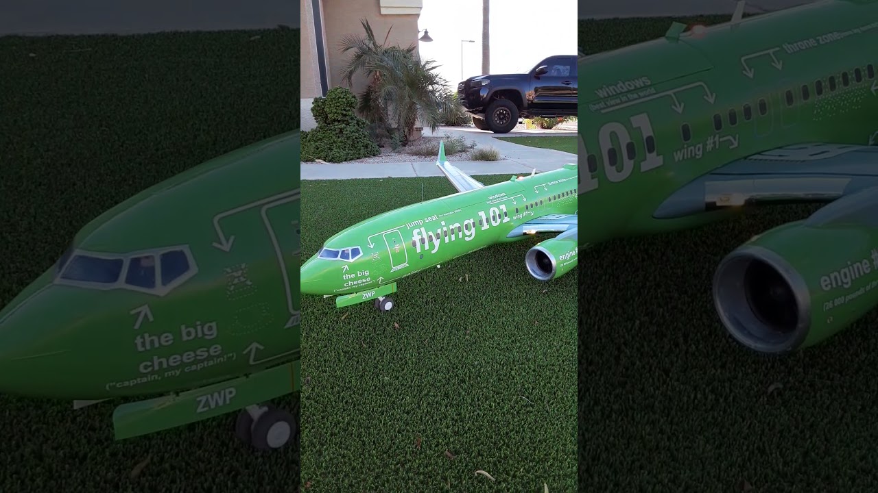

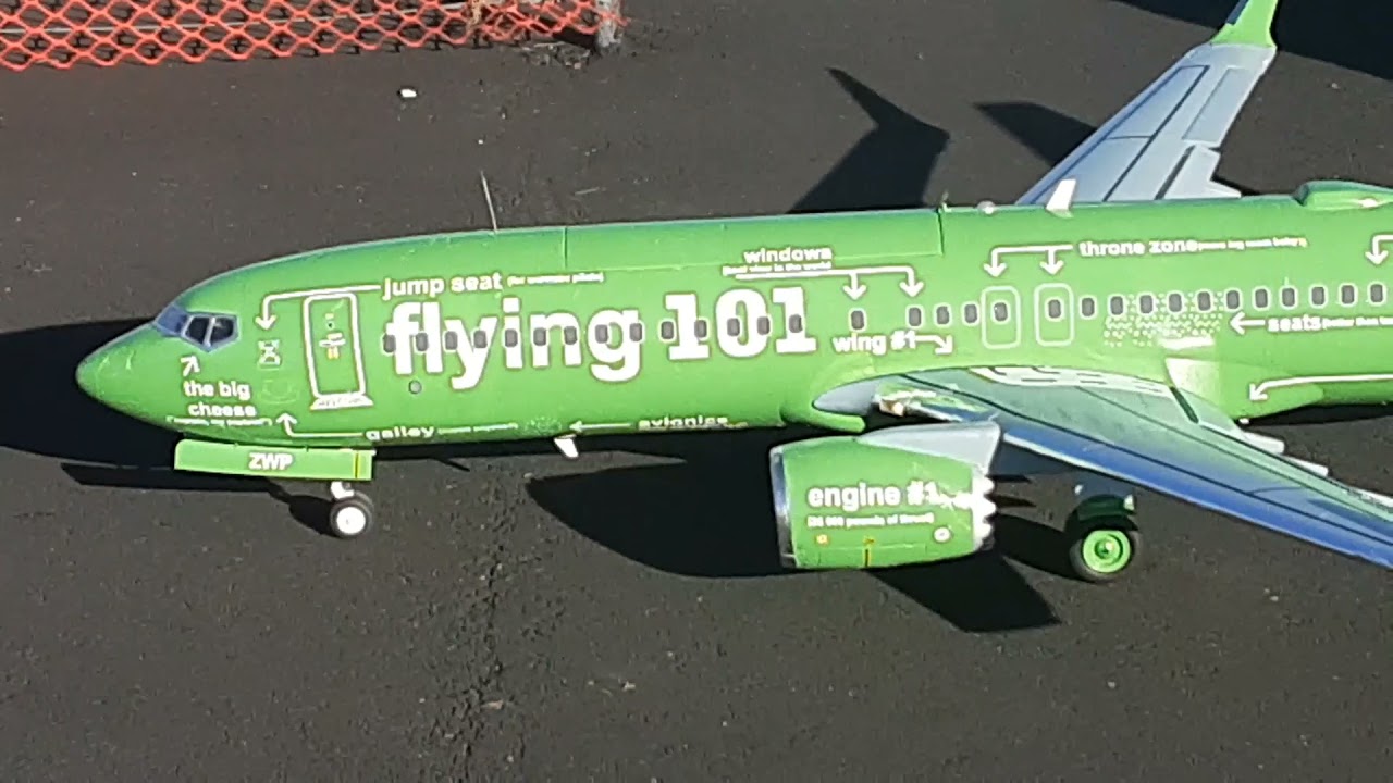

    This was a big project for me. It came out very nice and I love it. Thank you to Motion RC, Callie Graphics, Space Age paints and my wife for her patience.

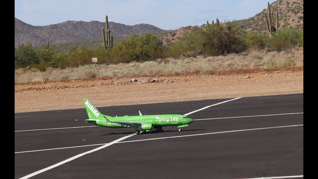

    I made the mistake of stickering the aircraft when I got it. I had no intention of painting it so it did not matter at the time. I then tried to remove the decals by hand and messed it up a bit. BTW you can just use acetone to remove the decals and not the paint from the aircraft. I took apart everything to paint it so I would not have paint in all the joints and I could get better coverage on all the parts. I could not find the right paint for this so I had it made special from space age paints in Mesa Az. I had them put it into spray cans since I do not have a sprayer for this. I removed all the decals with acetone after damaging the aircraft by trying to just remove them. Sanded it down and painted it. I used a chrome detail tape on the wings because every time I put tape on it, it would pull the paint off. Leaned that with the nacelles. Decals came from Callie and were easy to put on. I messed a few up in placement but that's OK. Once it was all done I coated it with minwax water based clear coat. Landing gear were painted white and one wheel on each side green. I will roll it out next week end at an airshow at Superstition Airpark with the Arizona Modelers club on Oct Some pics and a video of the completed aircraft.

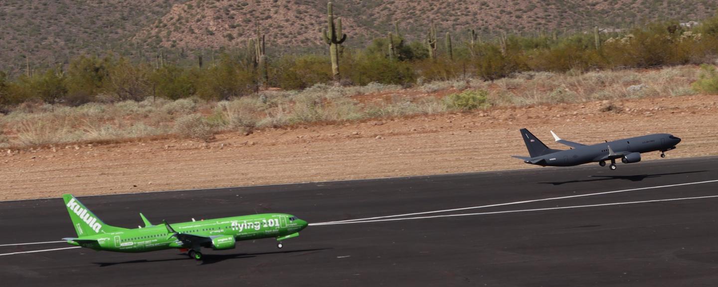

      Airshow pics not uploading

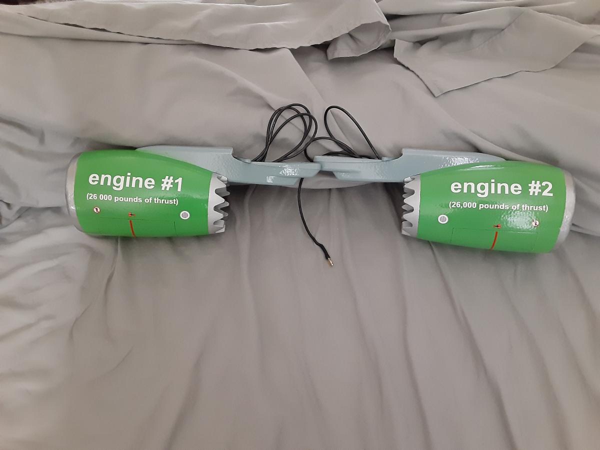

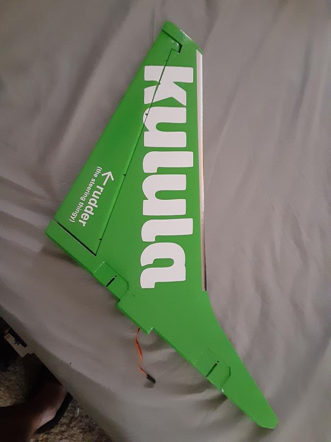

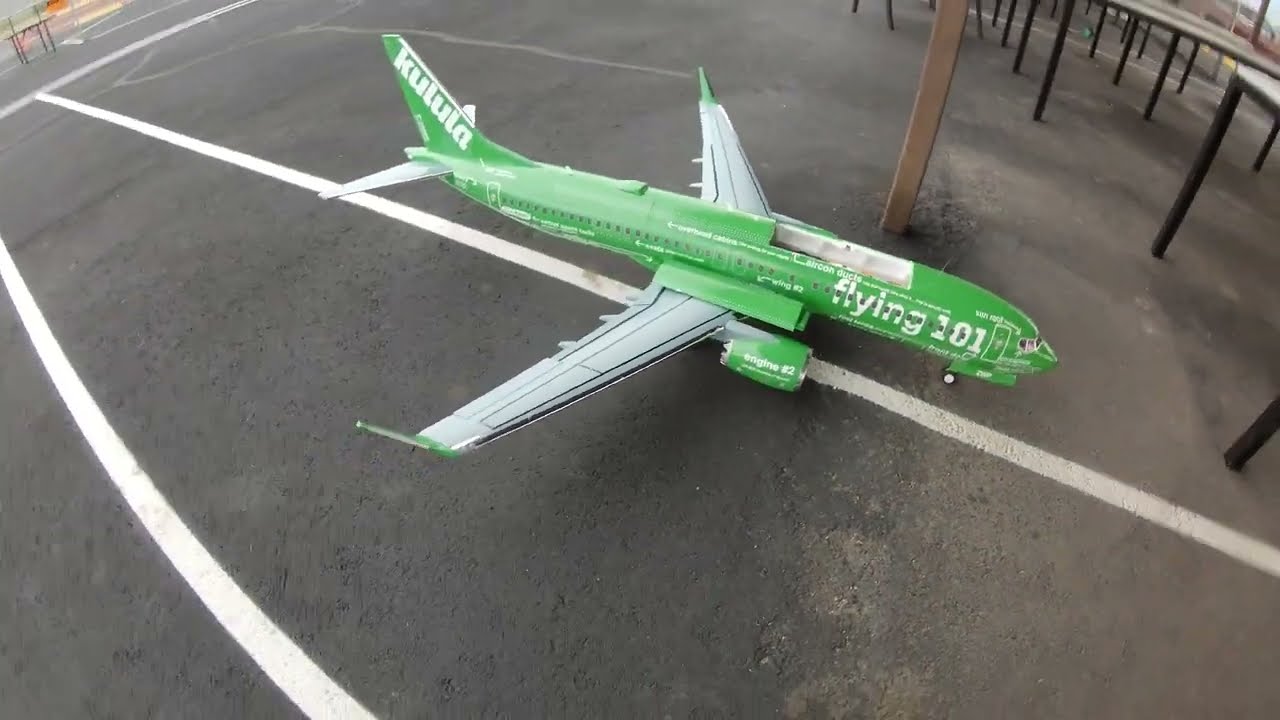

                      Took the engine nacelles apart to clean the fan unit and paint. Repairs are done, so some light sanding and paint. Then to repair one wing top. I redid some wingletts and took off rge lower part so the winglett just curves upward. I also painted the marks on the engine in the center. New vertical stab is painted.
                      • #12

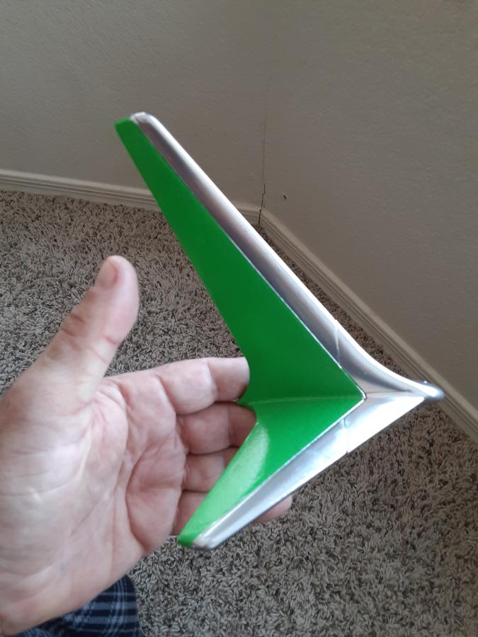

                        I think I am done with the repair work. The powder and tape idea did not work for me but I did do the wet paper towel idea and it did work. After a lot of cursing and frustration I am done. Just to be fare I am not good and painting these things. Changed the winglets and cut the bottom off and added a swirl thing to the center cone of the engine. I will post some pics in a bit.
                                I have used paper that I dampen with a spray bottle. The type of paper I use is a roll of brown painters paper that they use for masking. I've cut curves on it and wetting as well. And I use a clean t-shirt rag to wipe excess water before placing the paper and before spraying.
                                I'm not that great at painting either and I can give you more pointers as to what not to do, than what to do. Cursing definitely helps!
