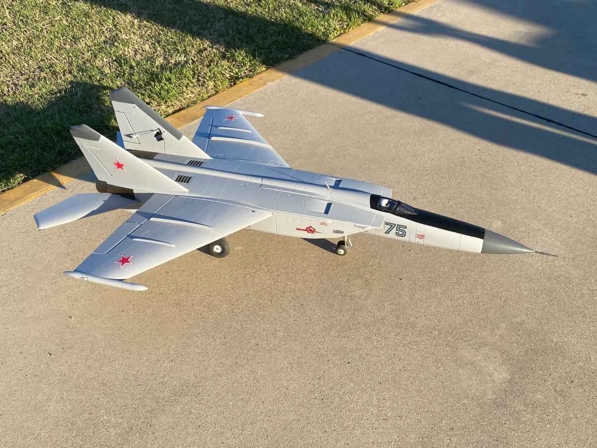

    Here is a pic of it resting in the late afternoon sunshne after the flight.

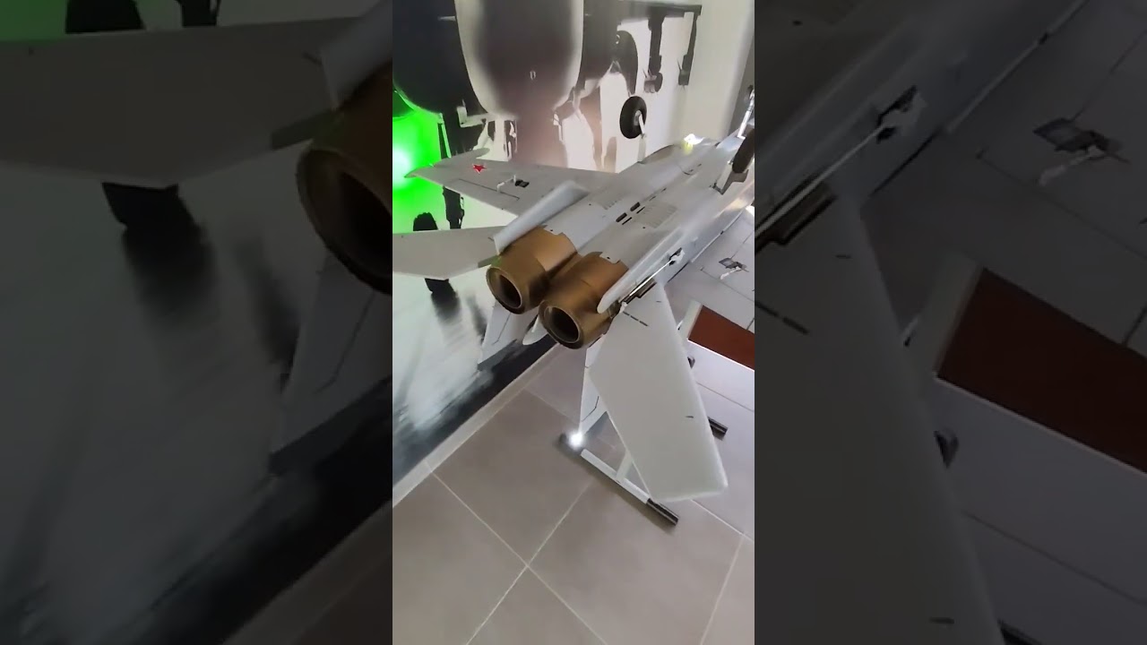

      Stay tuned for more vids later showing a modified front trailing link suspension and exhaust nozzle caps for 300grams extra thrust and 10A more power for better verticals!
