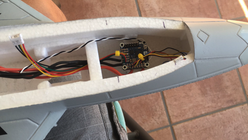

    The perfect location for the flight controller has been found, with GPS on the front:

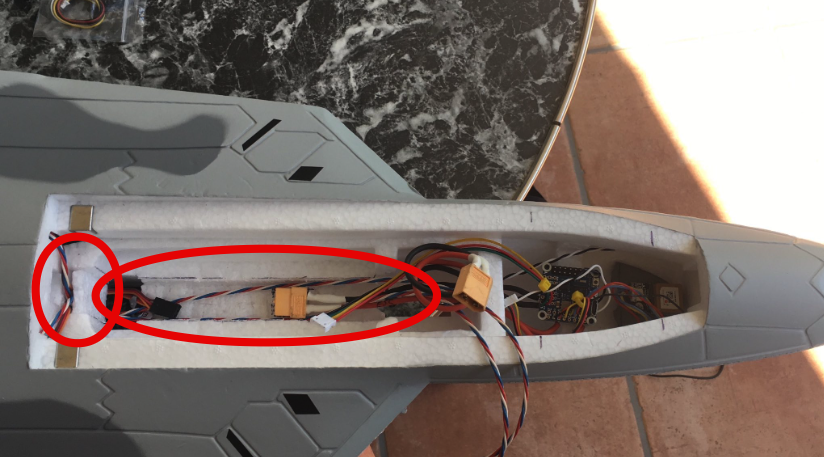

    I decided to hide the servo and ESC cables under the battery, so I cutted out a cable duct on the back and under the battery compartment:

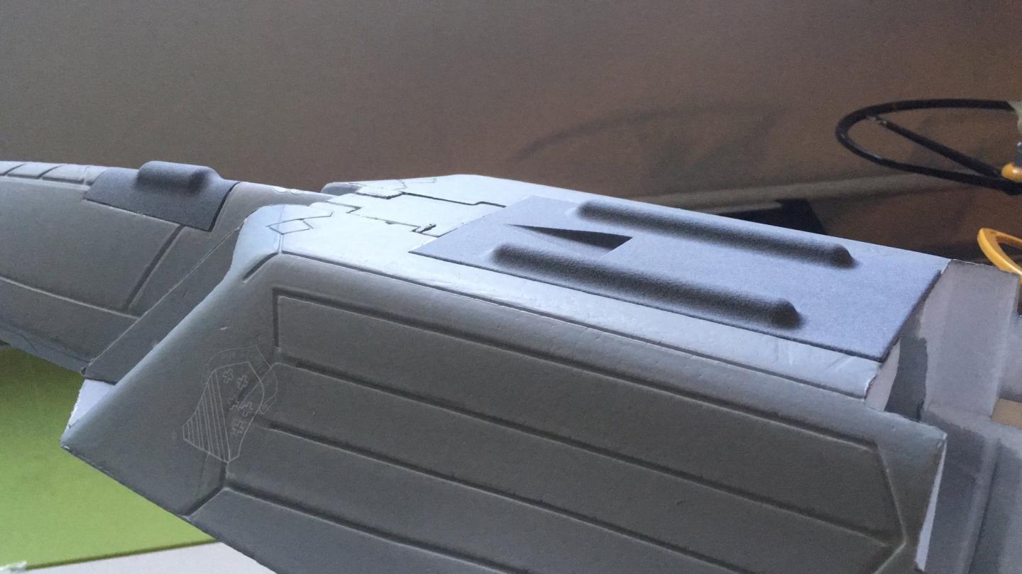

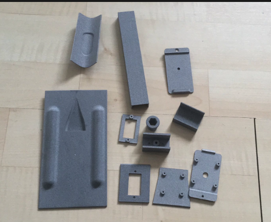

    Finally arrived! The 3D print parts for the F-22. New nose gear cover, ESC cover and all parts for iNAV and FPV gear :-)

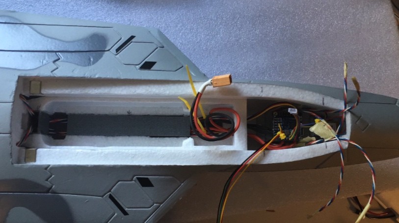

      Some update:
      - New landing skids and ESC cooling
      - A first view of the internal wiring
      In the nose there is flight controller and GPS
