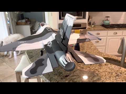

    Flying Stabilizer Mod. Jet flys great!
  • Nvenezia
    • 4
    1st Flight with Modification 😀

      That looks awesome!

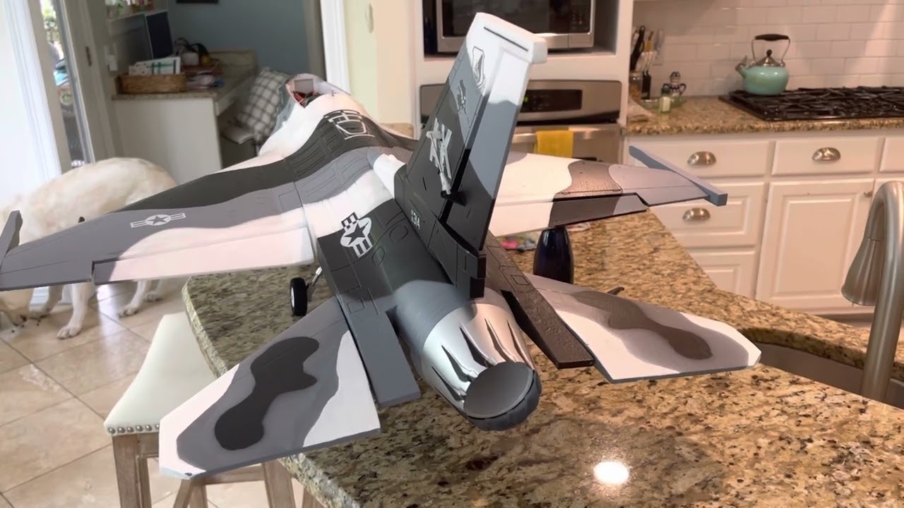

      do you have any photos of the modifications in process?
      • Nvenezia
        • 4
        Here are a few, I used the stab pivot from the 64mm F-22,6in 4mm tube for stability and filled in the elevator trench with a kabob stick expoxied above and below backfilled all with no shrink spackle. I also upgraded to 17g servos and set up elevator/ aileron mode 1 and flaperon/Taileron mode 2…

          Just another question if you don’t mind, nice job on the modifications, I am thinking of doing this to my F16
          Although as I’m sure you would agree that this plane fly’s great just out of the box, do you find any performance gains from this modification or is it more just the cool factor that you get from this modification?
          • Nvenezia
            • 4
            I felt that after the modification it gave me better stability at low speeds (highalpha)in the flaperon/ taileron mode. And of course it is way cooler and in my biased opinion, should have come like this in the first place…
