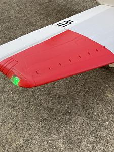

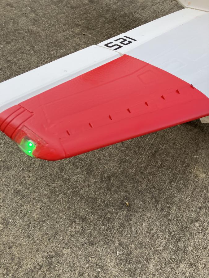

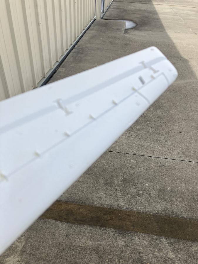

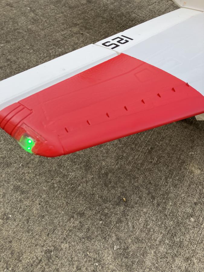

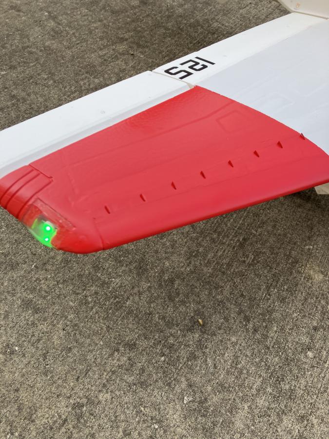

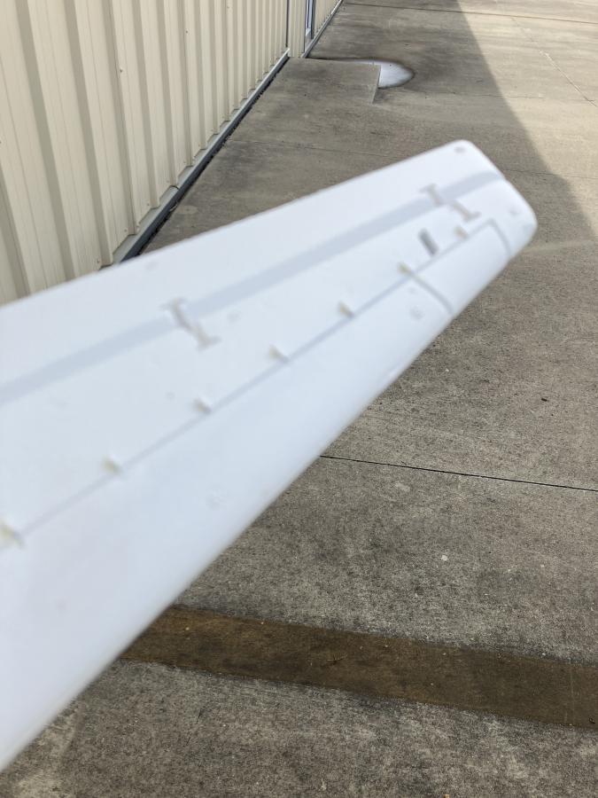

    About a month and a half ago I contemplated adding vortex generators to my T-45 to eliminate wingtip stall on landing and buffeting of the horizontal stabilizer during a high rates of turn. Horizontal stabilizer buffet is something the real plane suffers from and I was surprised to learn this from some of the F-18 pilots I flew with that the T-45 has this issue.
    Based on the testing with the OV-10 my installation resulted in this configuration:
    Today was the first chance I have had to test fly this modification. As you can see gone is the Freewing vortex strip more like a spoiler in my opinion.
    The first thing I noticed right after lift off was how rock solid the aircraft was, the control authority was extremely crisp. Mind you I changed none of the control parameters primarily to see the difference. The first tight turn exhibited no buffet. I then went and made an even tighter turn attempting to rip the wings off and it was out of this world how tight it was, unbelievable. After about 3 minutes of this yanking and banking I entered the pattern for some touch and goes and boy was I surprised. A nice stable approach at a slower airspeed than before and she settled into the landing extremely nice. Two more takeoffs and landings exhibited the same.
    I thought I’d share this with you folks. I do believe the wing has been vastly improved.

    You added them to the underside of the horizontal stabilizer? Or both top and bottom?
    • jetpltrich
      I fly with gyros!
      • Dec 2021
      • 156
      • Somewhere in east Texas
      just the underside.
