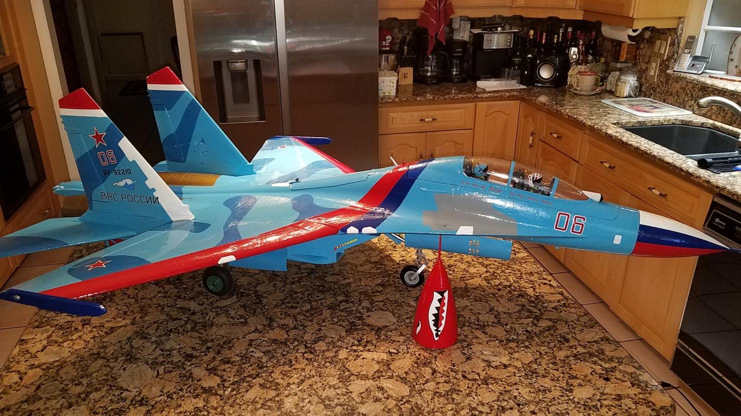

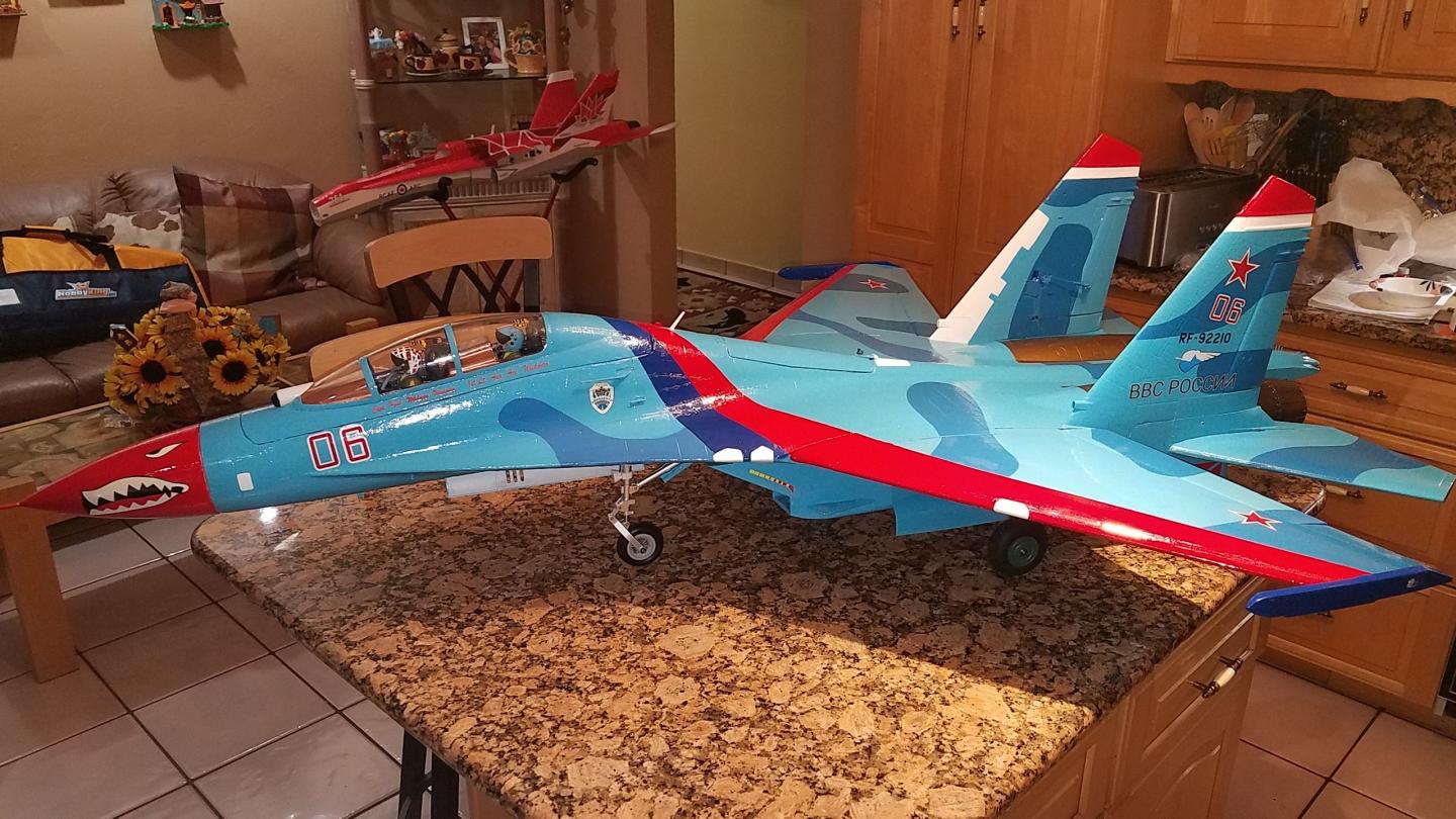

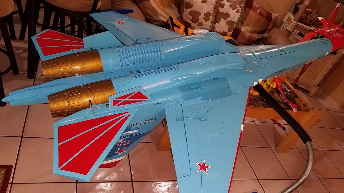

                  My original E-Flight SU-30 was getting a bit "long in the tooth" and after a lot of mods and maybe 150 flights, a bit worse for wear. So decided to get another FMS SU-27, the blue version. Did all the same mods: Dual batteries, afterburners, larger nose wheel and upgraded hitec elevator servos. Finished it a week ago and maidened it recently. Flies solid, not as nice as my Mig 29 but that one with TV nozzles is spectacular. Installed the AR 8360T AS3X upgraded to Plus along with a remote satellite, as Kallend mentioned. I fly off grass so have in set up with flaperons and also set it up with tailerons and the nose wheel gyro in the Plus RX. Got it balanced at 170mm, not as far back as the 200-240 Jon (2 Bros) flies with a single pack in the speed brake bay, but then again I ain't exactly doing some of the crazy stuff he pulls off. Just not quite there yet, if I'll ever be.
                  I liked the fact that there is very little unpainted white on the SU-27 unlike the SU-30 had, but did add a bit more camouflage markings as well as the red band going across the fuselage going on to the leading edge of the wings. Also added the dark blue band on the fuse, but not the red/white/blue bands on the vertical stabs, only some red on the top of those stabs. All for better visibility. Built out the cockpit and covered everything with 4 coats of clear gloss exterior Spar Urethane for a bit more durability.
                  This one (like every other aircraft I've updated with Plus), flies extremely stable, lands easily and with the tailerons has superior maneuverability verses "regular" horizontal stabs. Get 5-6 minutes on 2 SMC HiV 4400 packs. All in all, rewarding to fly and has a great presence in the air.
