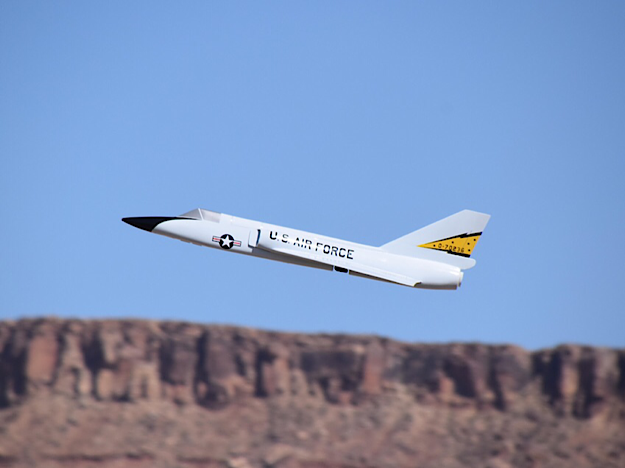

    My new scratch Delta Dart
    1/12 scale 68” long by 39” span
    Freewing 80mm inrunner on 6s 5000 (T-33)
    Freewing retracts
    cnc routed foam parts
    7.5 lbs flying weight
    simple and light

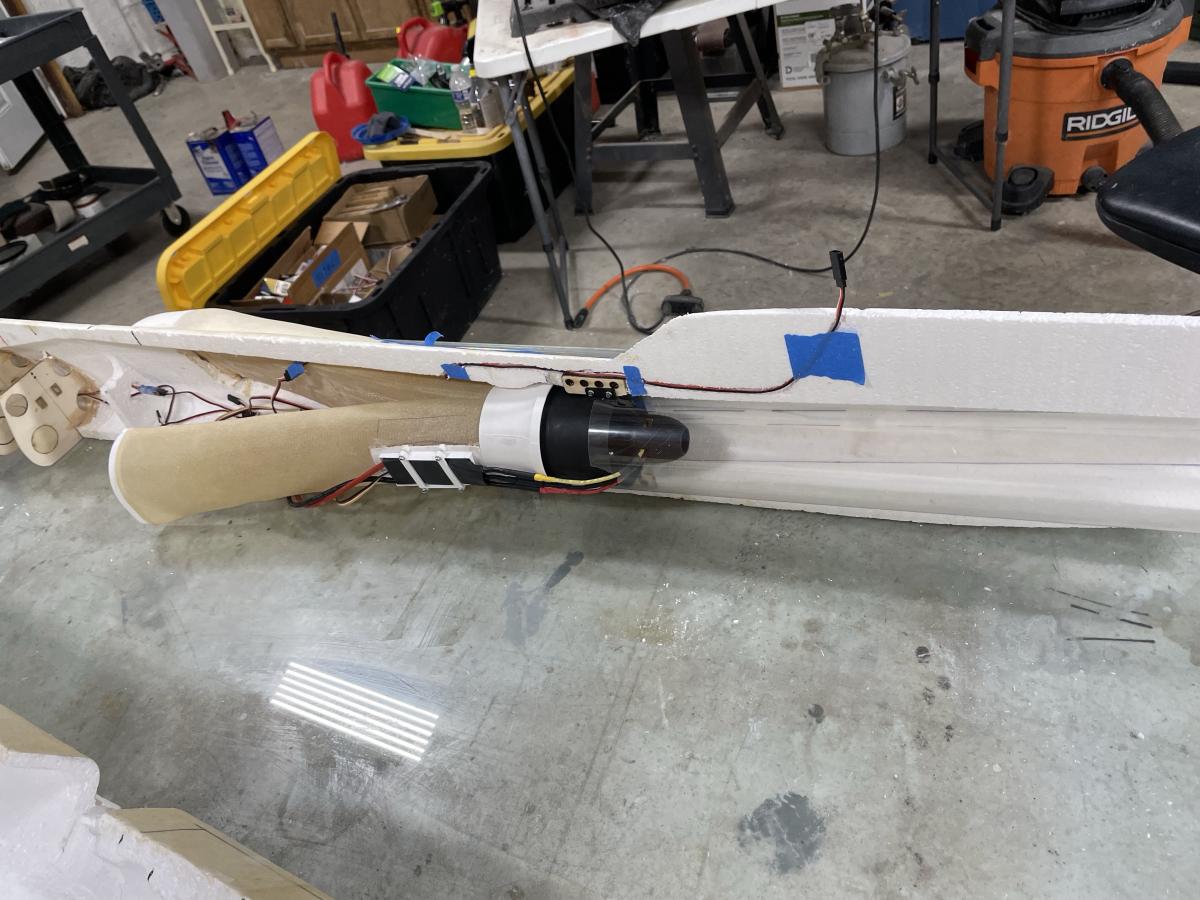

      here is a look at the inside..

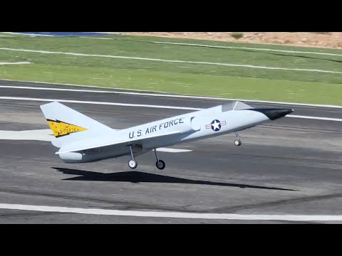

        Video from the Hecht Speed YouTube page. Beautiful model, Paul. Congratulations on the successful test flights. The SIX is sorely missing from the Freewing lineup.

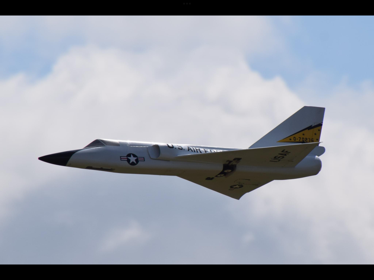

            I was lucky enough to fly this amazing model at the recent BEST electric event in New Waverly, TX 10 days ago. Really a nice flying and good looking model. Paul did an outstanding job!
