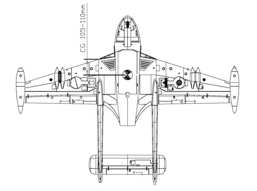

          Are you measuring the CG distance from the inboard or outboard side of the intake? The inboard side is significantly farther forward than the outboard side and the manual specifies to measure the CG location from the outboard side. Click image for larger version

            The picture is pretty obvious

              The C of G is being measured as per the diagram from the manual which I downloaded from the MotionRC site. Appreciate everyone's input. Thanks
