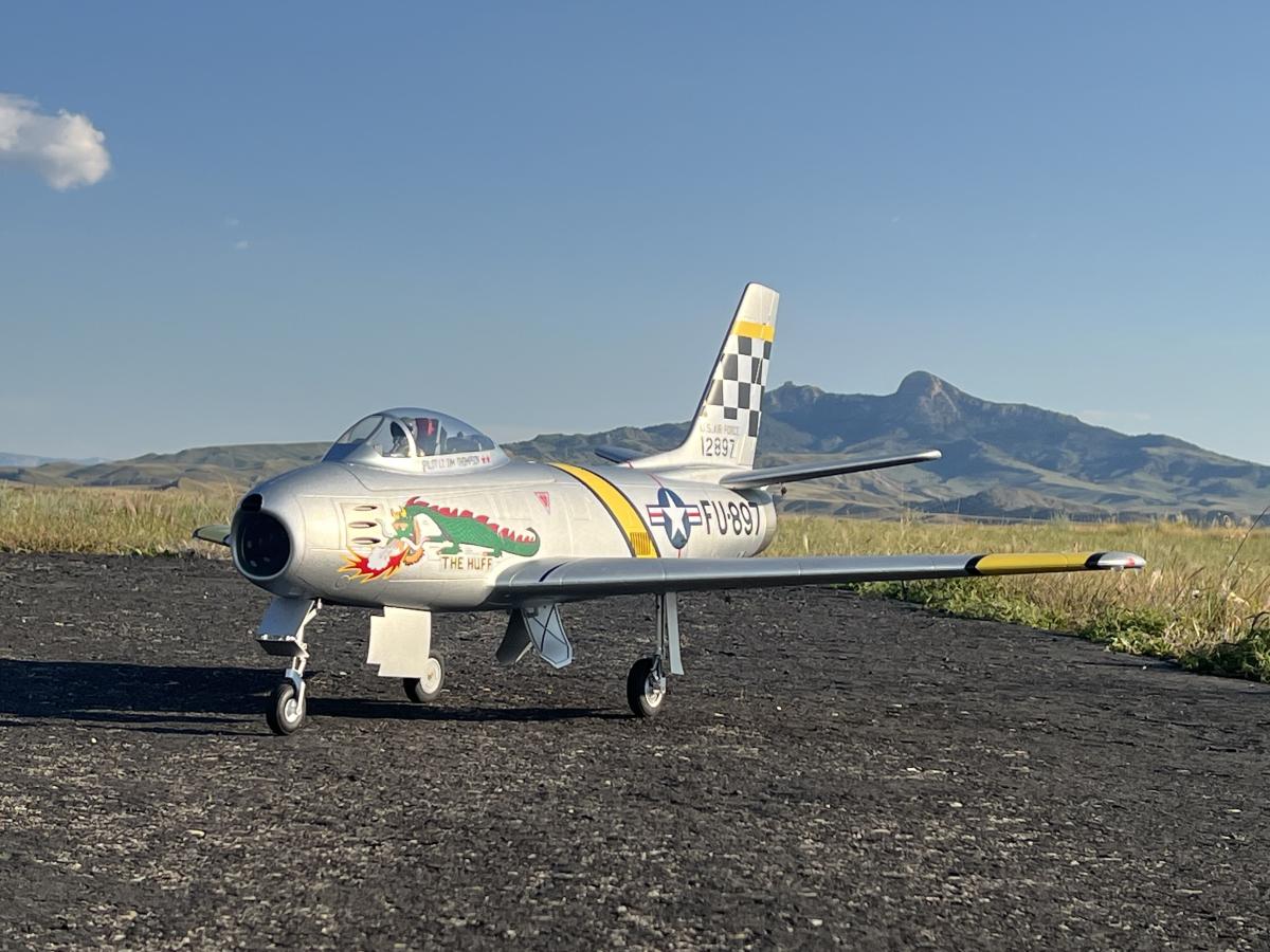

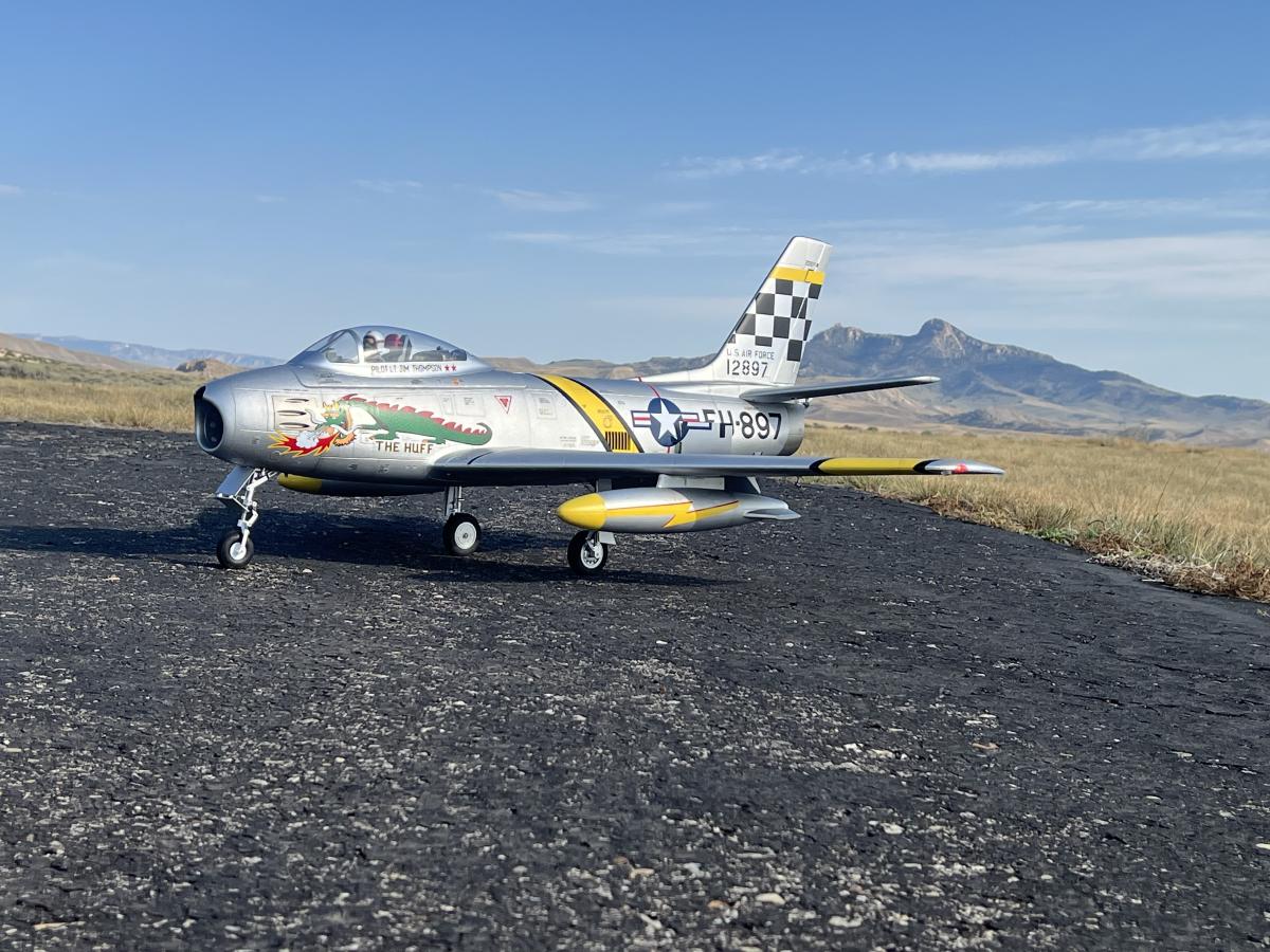

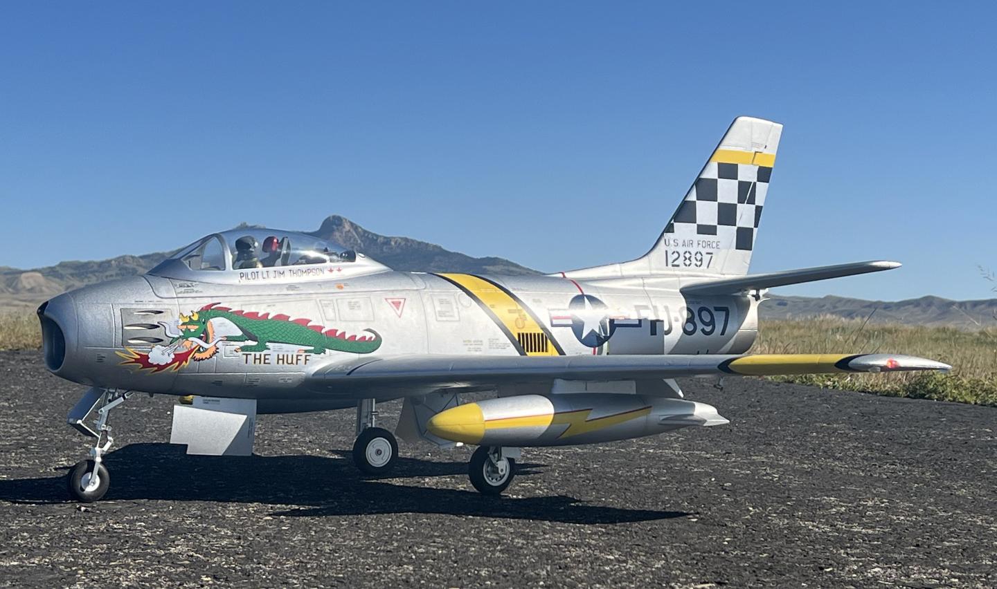

                I took my FMS F-86F and got my 12th flight of its short career in this morning. I am totally liking this airplane! The RC Geek improvements to the landing gear doors to be more like the real thing was a good and positive step to take. Also, RC Geek's 1/10 scale "F-86 jock" bust was repainted to look the part in 1952, and displays nicely.
                Flying wise, even on the Very rough runway our club uses, it survives best as it can. What I would give for a patch of smooth, black tarmac to operate out of! But I make the best of what is available, and deal with it. In the air, it is very stable, flies with authority in our thinner air (5,300' MSL) and with landing flaps and speedbrakes fully deployed, lands like a "kitten" and you can do "wheelies" for some distance, or at least get a nice smooth landing. I don't fly it in big crosswinds with its narrow gear, but with all landings so far, it hasn't had a tendency to drag a wing on takeoffs or landings.
                I think I'll give it a rest for a few days while I fly some of my other airplanes in the "stable."
                I'll attach a couple of pics of the F-86 on the ground. The first photo shows the stock look of the FMS F-86 with the main gear doors hanging down while the gear is down. While this is how the plane would look with hydraulic pressure removed making them droop down (think North American P-51s on the ground with all power removed, the main gear doors hanging down) the second photo is how the airplane actually should look with power on the airplane. The gear doors retract while the gear is down, on the ground, or in the air. This is thanks to RC Geek's ingenious way he came up with a way to do this on his airplane, and I copied his result. I'm very happy with it.
                Not a big deal, but for me, I love doing what I can to make historic aircraft like this look a little more realistic, within reason.

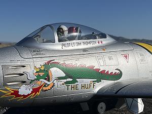

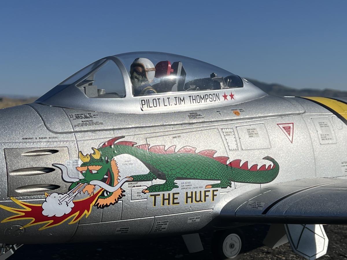

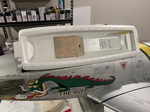

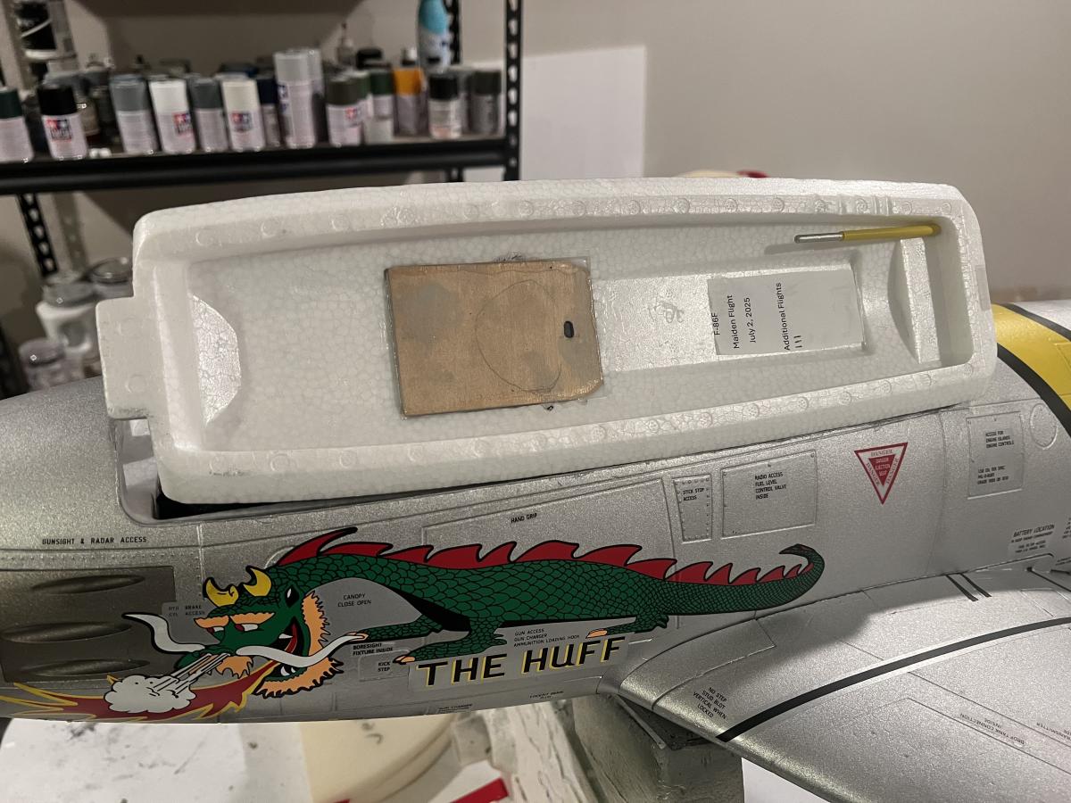

                        Thanks guys! Aileron servos have been replaced, and I'm hoping for a maiden flight on Friday. I filled all the panel lines, and used a filler primer to get a smooth surface. Then, I covered panel by panel in 6" wide aluminum tape: https://www.amazon.com/BOMEI-PACK-Al...1zcF9hdGY&th=1
                          • 2818
                          • Arlington, TX
                          Got the markings in from Callie. Maiden flight coming soon.. The model is painted after Robbie Risner’s aircraft. After his wingman lost his engine Mig hunting in China, Risner incredibly used his airplane to push the jet to a bailout point. Sadly, his wingman did not survive recovery from the water, but it remains an amazing feat of airmanship.

                              Maiden Flight has been completed! Flies quite nicely, however I did collapse the nose gear on the 2nd flight, but it looks to be a fairly easy fix.​

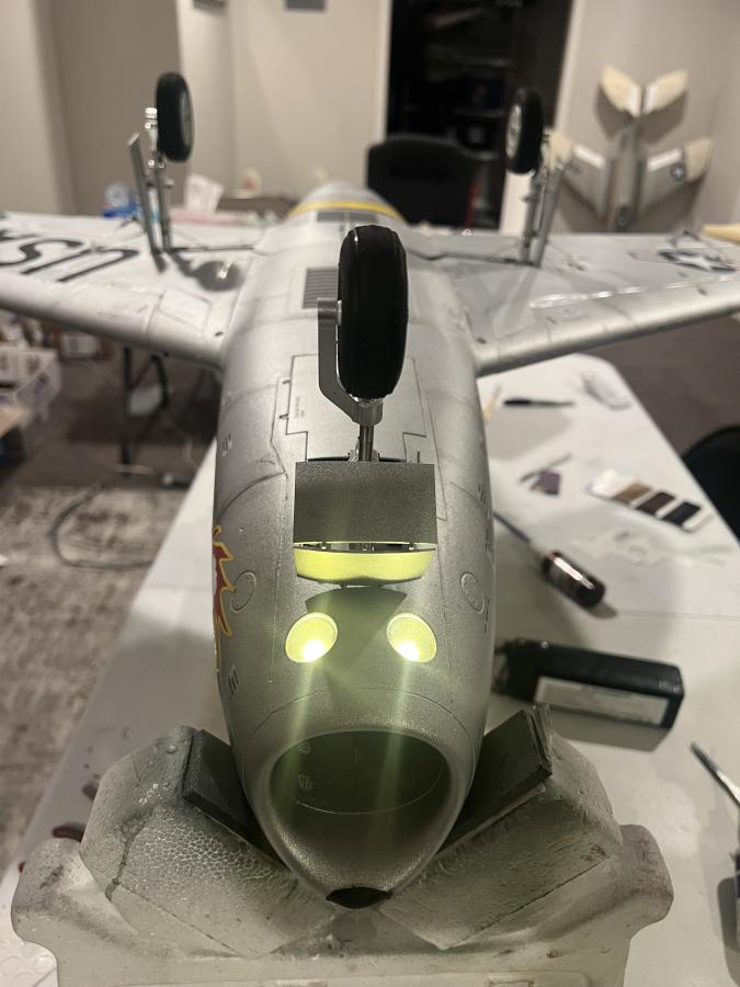

                                    Thanks Dave and LB! Nose gear is patched up and ready to go. I 3D printed a nose gear reinforcement piece that was posted in the RCgroups thread. Should help avoid further issues. Will be packed up Monday for the drive out to St George, UT for the John Morgan electric event.

                                        • 2818
                                        • Arlington, TX
                                        #20
                                        Will do! Packing it in the trailer for the drive today,
                                        As for the nose gear weak spot, for me it was two fold. Just on the aft side of the steering servo, the plastic mounting tray is very thin. It cracked there and caused the support linkage to collapse. The second issue is that these support trays were glued from the inside of the air intake, likely as the halves of the model were being assembled. This puts the glue (which was very sparsely applied) in tension where it is weakest. Most other models would mount parts from before for that reason.
                                        The small 3D printed support bracket in the RCG thread solves this by bracing the upper sides of the plastic mounts against the plywood battery tray, which is much more rigid.
