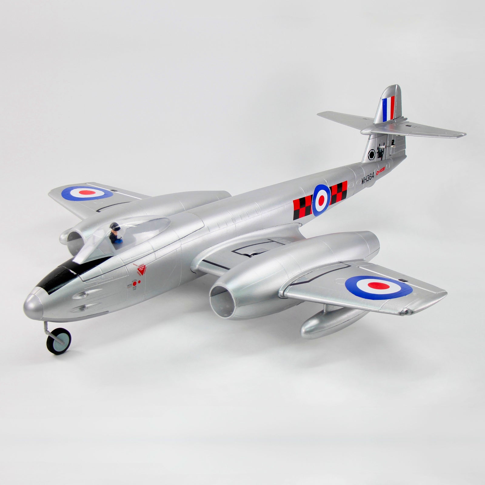

          BTW, here is a twin jet that somewhat resembles your project. This one is commercially available and mass produced. You can do a comparison of dimensions and power set up.
            https://www.dynamrc.com/products/glo...8-v2-6s-dy8974
            Thanks, man, really appreciate it!
