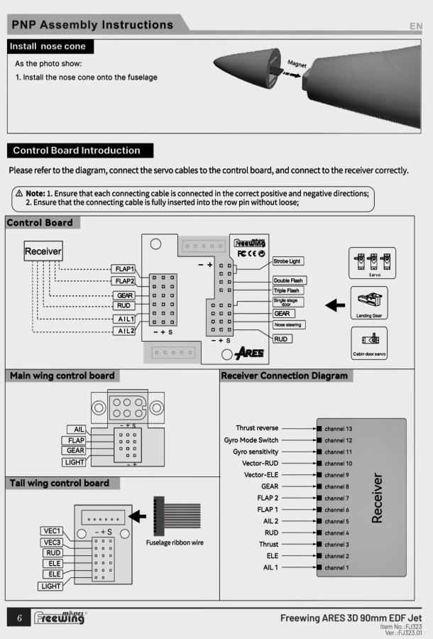

              I downloaded the Ares 3D manual and it shows using XTM Switch SD to switch between 3D flight mode (Heading Hold) and Standard flight mode (Normal Damping) using receiver channel 12.
              Channel 11 is for Gyro sensitivity. I would have it on my 2 position switch SC for High Rate/Low Rate.
              Jeti makes a 14 channel receiver but has no stabilizer so I have to use Ares 3D two stabilizers. This jet has no wingtip missile rack like my F18 but … the wing aileron leading edge at the wingtip is past the hinge point and would dig into the grass if a wind gust rolled it on landing if I moved ailerons to level the plane.

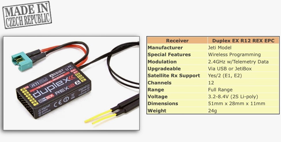

                I had several of my RC Club friends tell me to do this:
                I am removing both their EG01 Gyros for lighter weight and use a Jeti REX12A and have no Gyro On/Off channel so always on. Then I will have my 90mm F18 Flight Modes:
                SD Up - Heading Hold for Hover and advanced aerobatic maneuvers.
                SD Md - Damping for normal flight.
                SD Dn - Training Mode for takeoff and landing stays level on wind gusts.

                    Freewing released this assembly, radio setup video. I found the radio setup part very informative but some of it is irrelevant to me as I would likely do a 10-ch set-up. I'm very reluctant to spend another $400.00+ for a 14-ch "power safe" Spektrum RX. The video is meant for Futaba but the principles are the same. It covers the full 13-ch set-up, SBUS set-up and an 8-10ch set-up (requires 4 Y's). I'm still curious about the gyros. Does one turn OFF one gyro when hovering and doing stunts and the opposite when flying "straight"? Or or they both ON or OFF all the time?

                      They are linked to both be on or off at the same time depending on the mode input. If you don’t plug it in it defaults to on. Same with the gyro gain. Don’t plug it in and both default to medium gain.
                      I like low-medium gain for regular flying and high for hovering.
                      If you don’t want to do the surfaces and TV set up in the manual or the two gyro channels obviously you can get by with fewer channels.
                      Thr, Ail, Ele, Rud, Gear, Flaps, Rev, TV, TV.
                      You could even Y the TVs to the Ele and Rud.
