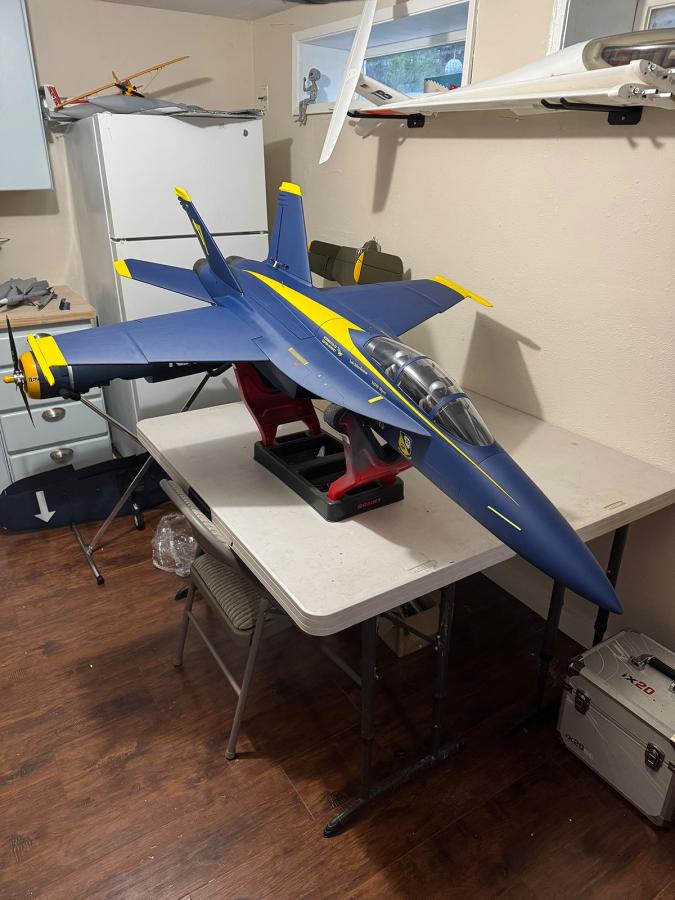

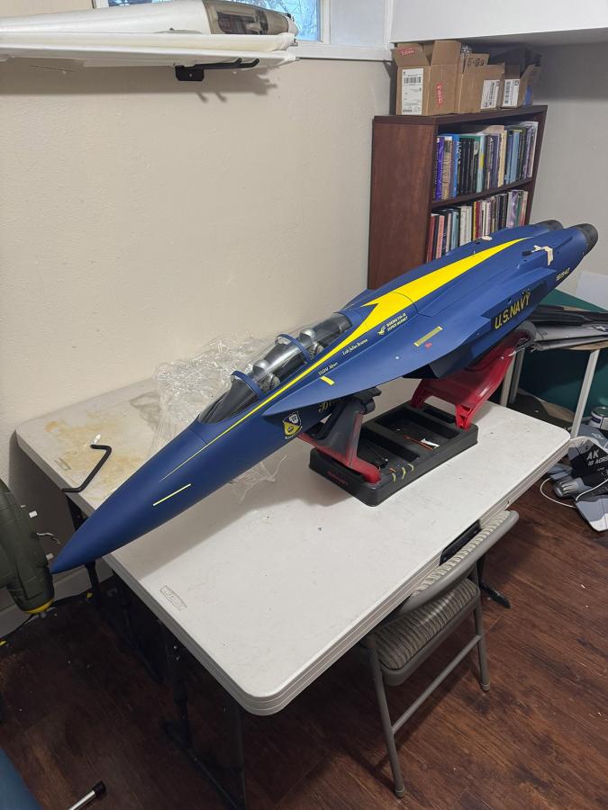

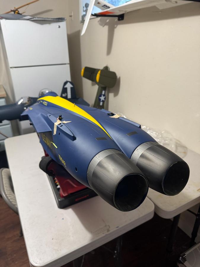

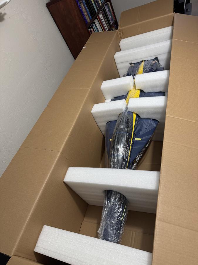

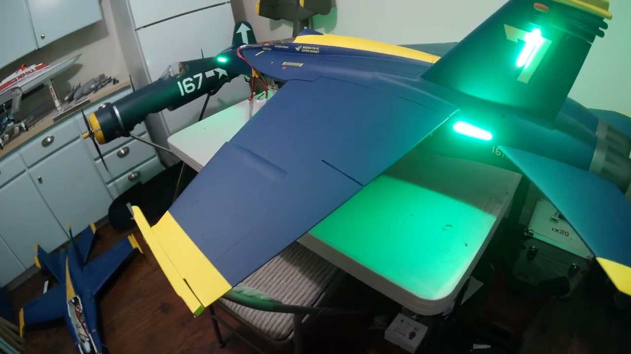

    I went ahead and pulled the trigger (much to my credit card's moaning) on the HSD 120mm F-18E/F Blue Angel PNP EDF Jet.

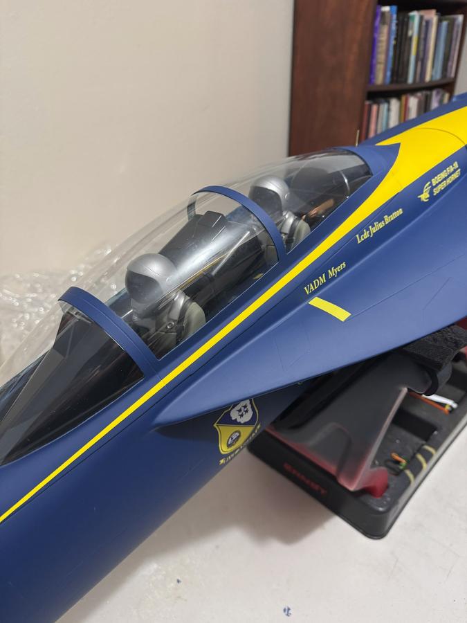

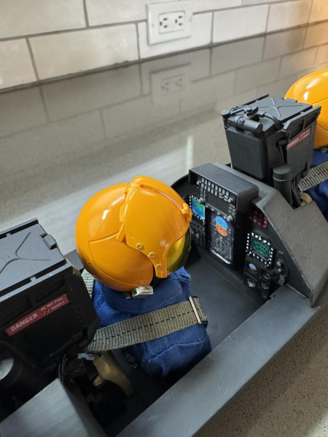

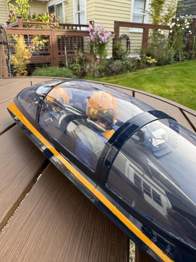

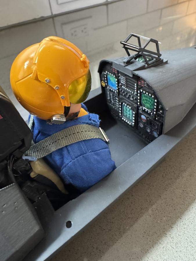

    Arrived today...Man, she's a beauty! Matte finish which I will want to paint a high gloss like the full scale. Elbee and others, I will really appreciate any insight into proper paint and technique. I want a glass-like finish like the full scale as much as possible. The cockpit and pilots are decent (it's a tandem cockpit) but inexplicably they are not painted as Blue Angels! Clutch the pearls!!
    So with some detail work, man, she's going to be a beaut!
    Quite a bit larger than the Freewing 90mm version. Made of a carbon/fiberglass composite. Takes the same power supply setup as my HSD 105mm F-16s did (2x 2S LiPos for receiver/controller, 2x 6S LiPos in series). So I am familiar with both the setup and controller it uses. Comes with full light package including formation green strip lighting, brakes, totally scale gear (will need to be painted white of course). From the video I've seen she seems to fly pretty solid and docile. At this price point I am going to leave nothing to chance and have all my i's dotted and t's crossed!
    Maiden will be in the Spring. My flying season is pretty much toast.
    You only live once! Why not buy some small fortune composite EDF you can soil yourself over trying to fly it!?!

    Firstly, just let me say WOW, what a gorgeous model.
    Go bigger or just don't show up, she is a beauty.
    As for Super Shiney Glossy Sparkling Clear finishes, well if it were me, I'd refer to this chart for the correct product.
    Then I'd PM f4u ausie and do whatever he says to do.
    I used Tamiya Gloss Clear on my B-25C Clear Resin Printed Plexiglas rear bubble.
    Dusted on 2 coats within 20 minutes of each other, then hit it with a fill coat (which was quite a bit of paint by comparison) and just didn't touch it for 24 hours.
    Something as large as this, the technique would stay the same I would think.
    You'd want the last coat to flow, so working with parts instead of assembled areas would be my thought.
    That is, paint the stabs (bottom first), the verticals, the wings (bottom first), the fuselage in that order.
    This order would also serve as good practice as you paint larger areas last.
    Just spit-ballin' here, but that is how I would approach it.
    Also, find an area to paint that has an over abundance of light, otherwise you'll get runs.
    However, with clear gloss you can come back and wet sand mistakes and reshoot.
    This is my $00.02 USD and no doubt Craig will have some sage advice and/or a better technique.

      Great advice Elbee, thank you! Now about that cockpit...Check your PM's soon...

        Aros,
        With the HSD dimensions, I would think scaling up the "Official Original & Authentic LB Freewing F-18C Cockpit Kit would be the place to start.
        I know a girl who knows a guy that has met a guy who actually knows the guy who designed the original Freewing version...
        What?!
        No, "What's on Second, Who's on Third."
        In any event, once the tub is sized correctly it would be downhill from there; he said and then remembering your HSD is a 2-seater...

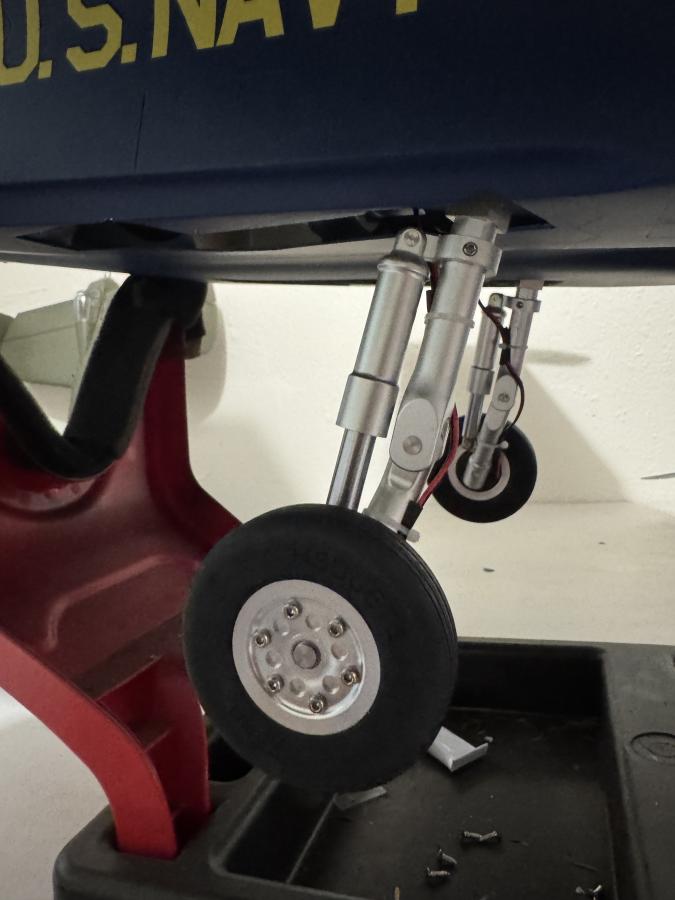

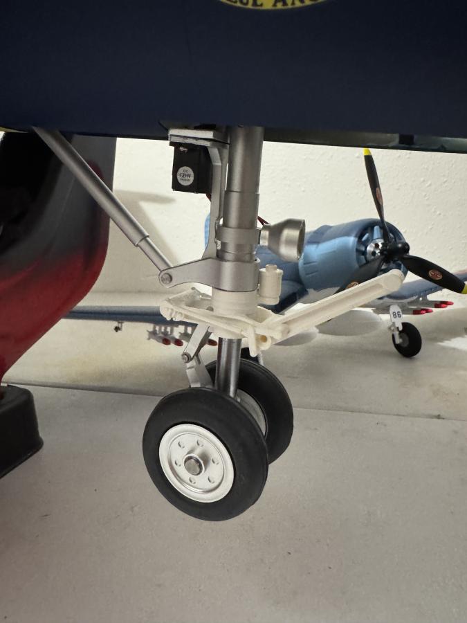

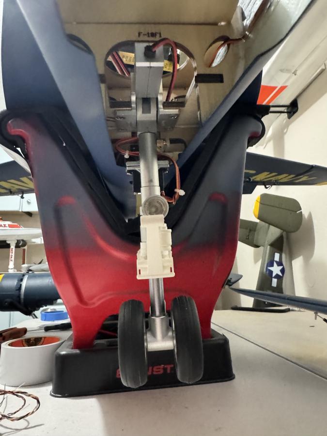

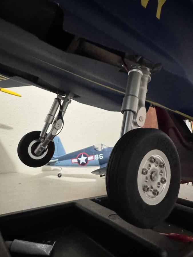

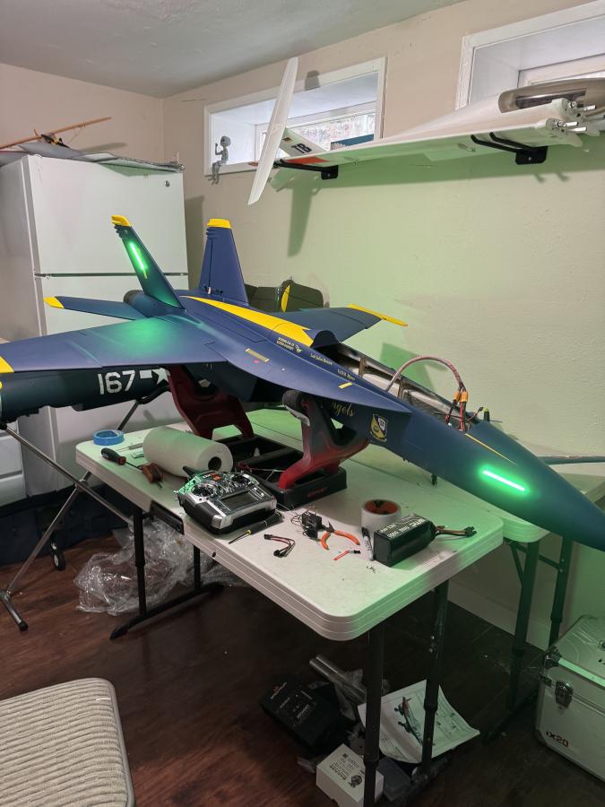

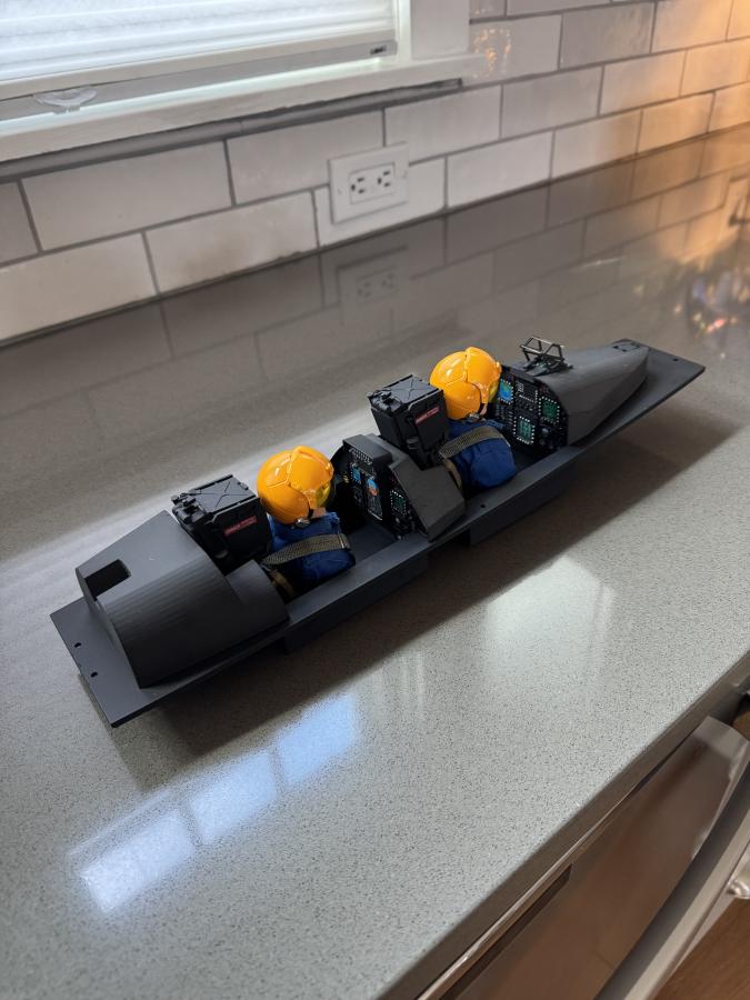

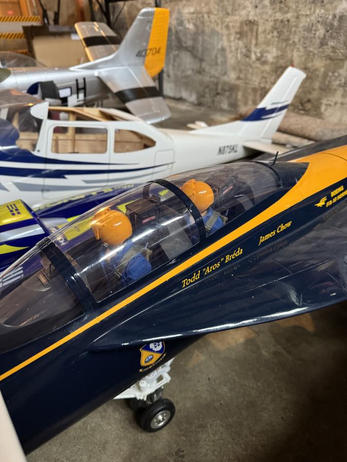

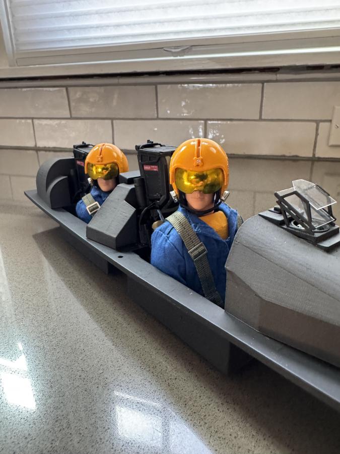

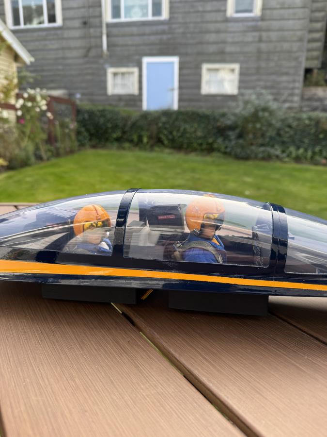

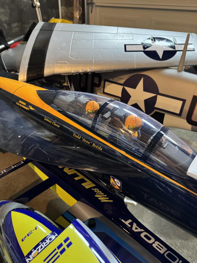

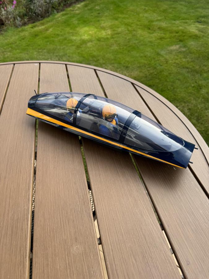

                              She's all ready to go in terms of throws, controls, gear...All that's left is CG and brakes and checking the power, and of course spraying a gloss coat which might have to wait until Summer. Our very own Elbee is being kind enough to work on the cockpit detail for me. I just know I am going to be completely disgusted with his talents, lol!
                              I also will need to paint the gear white, but of course. Otherwise she is a jewel and daring me to maiden and not be a chicken about it!

                                  Watched it on my big screen,, lol... The size really shows.. beautiful model. Looking forward to seeing it in the air.. and I'm sure the cockpit will b awesome do they make an f4 phantom in 120 mm???? Yep the throws seem small
                                  • #18
                                    Well my friend our own Elbee is the key holder to the cockpit mod so we all know what good hands I’m in! As for an F4 I wish!
