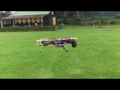

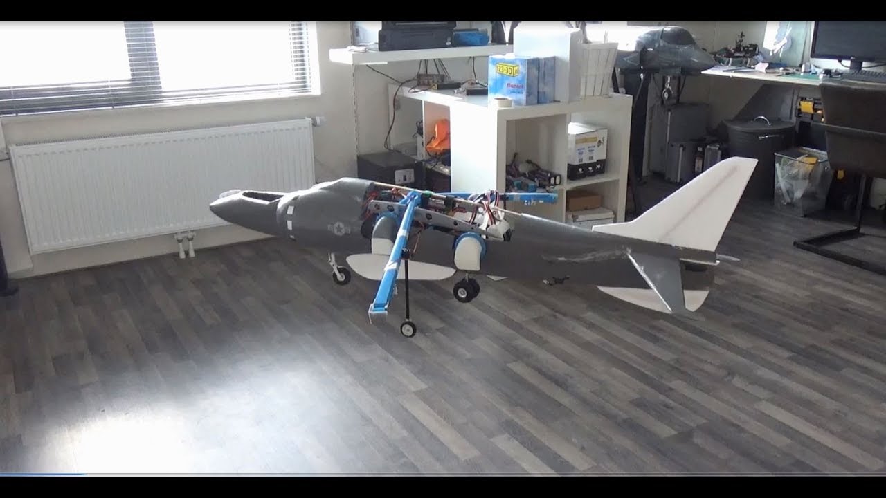

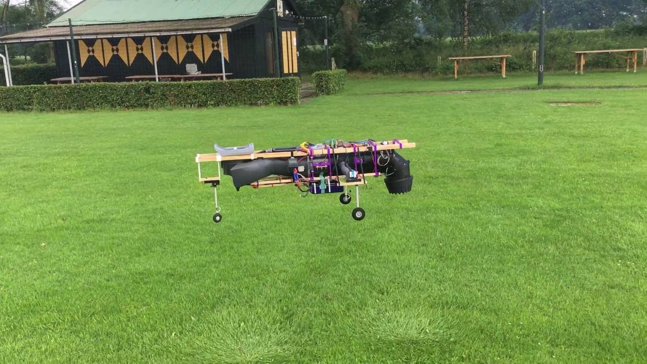

                I just found out that the same guy that has been developing the F-35B has also been working on an amazingly crafted AV-8 harrier prototype..
                I have seen many attempts at making an RC Harrier but many have failed because they deviated too far from the original design to keep it simple. But it simply is not possible to replicate a Harrier with out also replicating the Pegasus engine with all of its ducting. Its amazing what is now possible with modern electronics and 3D printing.
                One of the top selling points about an aircraft like this coming to market is that no one will be asking if it is capable of flying off grass. ;)

                    I just saw this update video of this project and as I was reading the comments someone asked if there going to be a kit available of this Harrier.
                    This is the reply he got: 2019 we going to try to put a kit on the market;)
