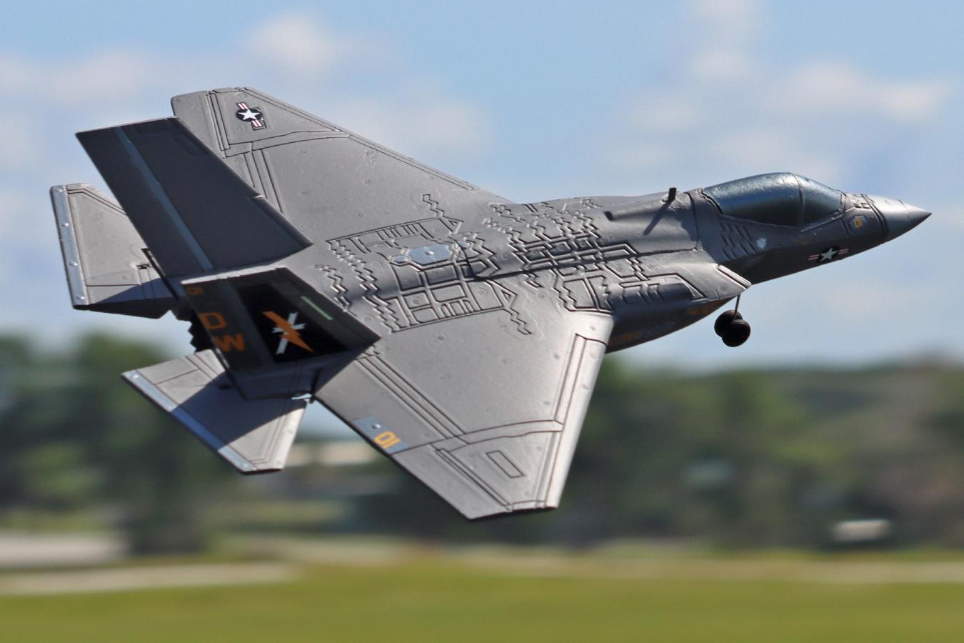

    F-35C Lightning II Micro 30mm EDF Jet with Gyro - RTF from Skynetic - SKY1074-001
    The F-35C Lightning II is the U.S. Navy's carrier-based answer to modern air combat: a stealth fighter built to launch off a catapult, slam onto a moving flight deck, and strike from hundreds of miles out. Broad wings, canted twin tails, and a blended, low-observable airframe give it a shape unlike anything else in naval aviation.
    The Skynetic F-35C Lightning II Micro 30mm EDF Jet shrinks that shape down to a 422mm (16.6 in) wingspan without losing an ounce of what makes it recognizable. Sharp proportions and crisp surface detail give this micro jet serious presence for something you can launch from your hand.
    Power comes from a 30mm 12-blade EDF spinning on a 6800Kv brushless motor and 4S LiPo. This thing hauls for its size, delivering surprising punch, acceleration, and speed from such a compact airframe. A 3-mode gyro (Beginner, Intermediate, Expert) shapes how that performance shows up in your hands: Beginner keeps things stable and predictable, Intermediate opens up more control while still smoothing things out, and Expert hands over full manual authority with no angle limits for pilots who want to fly it like they mean it. Beginner and Intermediate modes also unlock the one-key aerobatics button, for an instant, clean automatic roll or loop at the press of a button.
    This Ready-to-Fly (RTF) version comes factory-bound to the included Skynetic 2.4GHz transmitter, so you can skip the binding process entirely. Charge the included 350mAh 4S battery, snap in the landing gear if you choose, and you're airborne.
    Out of the Box, Into the Air
    This RTF jet ships complete: aircraft, transmitter, battery, and charger, all factory-matched and ready to go. Add 4 AA batteries for the transmitter, charge the flight pack, and you're airborne. No binding, no setup, no waiting.
    Three Modes. One Incredible Jet.
    Beginner locks in stability, Intermediate opens up greater maneuverability, and Expert hands over full manual control, no limits, all from one switch. Beginner and Intermediate also unlock one-key aerobatics: press the button, move a stick, and watch it snap off a clean roll or loop on its own.
    Guardians Of The Sky
    Wearing the authentic scale markings of VMFA-251’s CAG aircraft, this micro F-35C honors the proud legacy of the “Thunderbolts” and their motto, Custos Caelorum—Latin for “Guardians of the Sky.” Bold tail graphics and a subdued tactical finish give it unmistakable presence both on the ground and in the air.
    Small Jet, Real Thrust
    The 30mm 12-blade EDF and 6800Kv motor at the heart of this micro jet are matched to the airframe for maximum punch. On 4S power, this thing pulls like something twice its size.
    Ready However You Fly It
    Hand-launch it with a confident toss, or install the removable landing gear and use the steerable nose wheel to taxi and take off from a smooth surface. Either way, it is airborne in seconds.
    The F-35C Look In A Micro Size
    The F-35C has one of the most distinctive silhouettes in modern aviation and this micro jet captures that presence faithfully. Broad carrier wings, a blended fuselage, canted twin tails, and the subtle angular geometry that defines the Lightning II, all scaled down to 422mm without losing an inch of identity.
    Features:
    • Authentic F-35C Lightning II design captured in a compact 422mm (16.6 in) wingspan micro scale
    • Powerful 30mm 12-blade EDF and 6800Kv brushless motor on 4S deliver true jet thrust and speed in a micro-scale package
    • Three-mode gyro (Beginner, Intermediate, Expert) sharpens control at every skill level, from confidence-building assisted flight to full manual aerobatic authority
    • Factory-bound Skynetic transmitter included: no binding required, just add 4x AA batteries and fly right out of the box
    • One-key aerobatics button (Beginner/Intermediate modes) performs an automatic roll or loop at the press of a button
    • Mixed taileron control, much like the full-scale jet, drives roll and pitch through the twin tail surfaces
    • Main control board offers direct compatibility with OpenTX (Radiomaster) radios, plus dedicated SBUS and DSM satellite ports for Futaba and Spektrum system add-on recievers
    • Removable landing gear with steerable nose wheel supports hand launches or ground take-offs, with steering control on the ground once you're rolling
    • Lightweight, durable EPO foam construction
    • Compact micro size is right at home at parks, fields, and smaller flying sites
    • 150m (492 ft) maximum control range keeps the jet comfortably in sight
    Includes:
    • Skynetic F-35C Lightning II Micro 30mm EDF Jet — RTF
    • Skynetic 2.4GHz transmitter (factory-bound)
    • 350mAh 4S 14.8V 30C LiPo flight battery
    • 4S LiPo balance charger
    • Landing gear set
    • Spare parts bag
    • Screwdriver
    • Instruction manual
    Requires:Power System and Electronics Compatibility:
    This model is designed to operate using the included ESC and its integrated BEC, which is specifically matched to the onboard electronics. To ensure reliable performance and prevent damage, always power the aircraft's receiver and electronics through the installed ESC using the main flight battery. Do not use any power source other than the main flight battery to power the model, otherwise damage will occur to the electronics.
    The receiver, servos, and other onboard electronics included with this model are rated for a maximum input voltage of 5.5V. When selecting your ESC and power system, verify that the BEC output supplied to the receiver and onboard electronics does not exceed 5.5V. Using a higher voltage will damage the aircraft's electronics. Product Specifications:
    AGE LEVEL : 14 and Up
    SKILL LEVEL : Intermediate
    BUILD TIME : 15 Minutes
    Model Scale N/A
    Wingspan 422mm / 16.6in
    Length 510mm / 20.1in
    Weight 162g / 5.71oz
    CG (Center of Gravity) 50-55mm behind the wing root leading edge
    Power System 1108-6800Kv brushless motor (included)
    Electronic Speed Control Integrated (included)
    Propeller / EDF 30mm, 12-blade (included)
    Servos
    • 3x 2g — 2x taileron (mixed elevator/aileron), 1x steerable nose gear
    Landing Gear Fixed, removable for hand launch (included)
    Battery 14.8V 350mAh 30C 4S LiPo (included)
    Radio 2.4GHz / 4-Channel — Skynetic transmitter included, factory-bound
    Ailerons No (mixed taileron control)
    Elevator Yes (mixed taileron control)
    Rudder No (nose wheel steering only)
    Flaps No
    Lights No
    Brakes No
    Gyro Yes
    Charging Time 40 minutes
    Material EPO Foam
    Skill Level Beginner/Intermediate/Advanced depending on gyro setting
    Control Range 150m (492 ft) max, 100m (328 ft) recommended
    Recommended Environment Outdoors, calm conditions
    Flight Time 3+ Minutes
