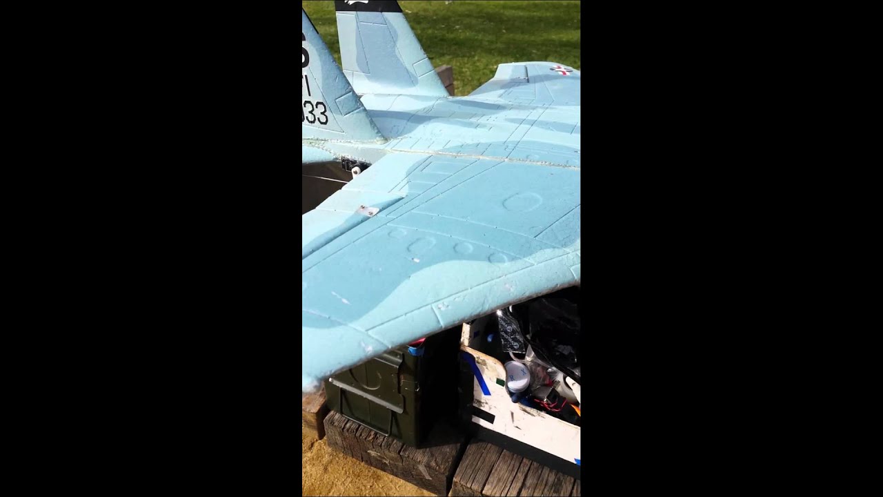

                          I have this plane. It is the newer FMS version but they are the same plane. I swapped out my fan for a 12 blade that I got off of ebay. It uses the exact same housing as the stock fan and drops right in. 3500kv, runs on 4s 2200 and sounds amazing!! Less than $30 for the fan with motor installed... can not beat that!! Here is a video of me flying is a week or so ago...
