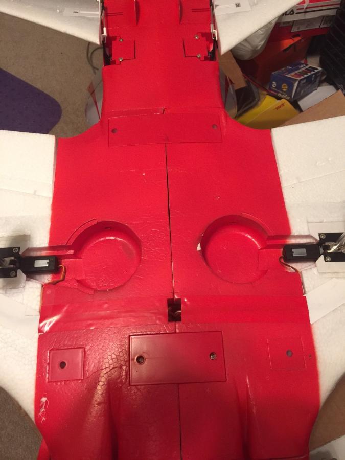

                            Gents, I just got my SScorpion yesterday, and started to look around before starting to assemble. I am a bit confused about the wing assembly. First, I noticed the manual does not make any reference to the plastic parts that seem to be meant to keep the wing together and also to pass the screws to install the wing into the fuselage. Neither there is any indication about gluing the two half wings together. Therefore, I kindly ask for your experience with these planes, if I follow the manual plus some imagination and keep the wing in two pieces and join them by the plastic parts, or should I glue halves and plastics all together?

                              Howdy. I've owned 2 of these, so let's see if I can help:
                              Wings just bolt on (no gluing). There are 2 "straps" each needing 2 screws. These hold the wing together in 1 piece and secure it to the fuselage (see picture below).
                              Point of note: Beware of landing speed. I've crashed 2 of these by letting the airspeed get too low when turning onto final approach, even with full flaps. The wings on this plane are just not providing enough lift. This plane needs airspeed and lots of it. Just beware. Keep the speed up in that final turn and even under power when landing. You'll need some throttle even when it's touching down. Good luck!

                                And I left out...
                                There are 2 other screw outboard of the front strap that attaches the wing half to the fuselage. You can see them in the picture.
                                Good luck!

                                  Thank you AZFlyer.
                                  I got the wings attached to the fuselage. Nice job to pass the bunch of cables through!!. I really appreciate the landing tip. I guess I will have to make a couple of high altitude approaches to get used to the landing speed. I was flying the Yak-130 today (70mm) and coming down with no throttle, although with some speed build up from a steep approach to end in a shallow landing, but form what you said, I better be in the high side of the throttle at all times.
