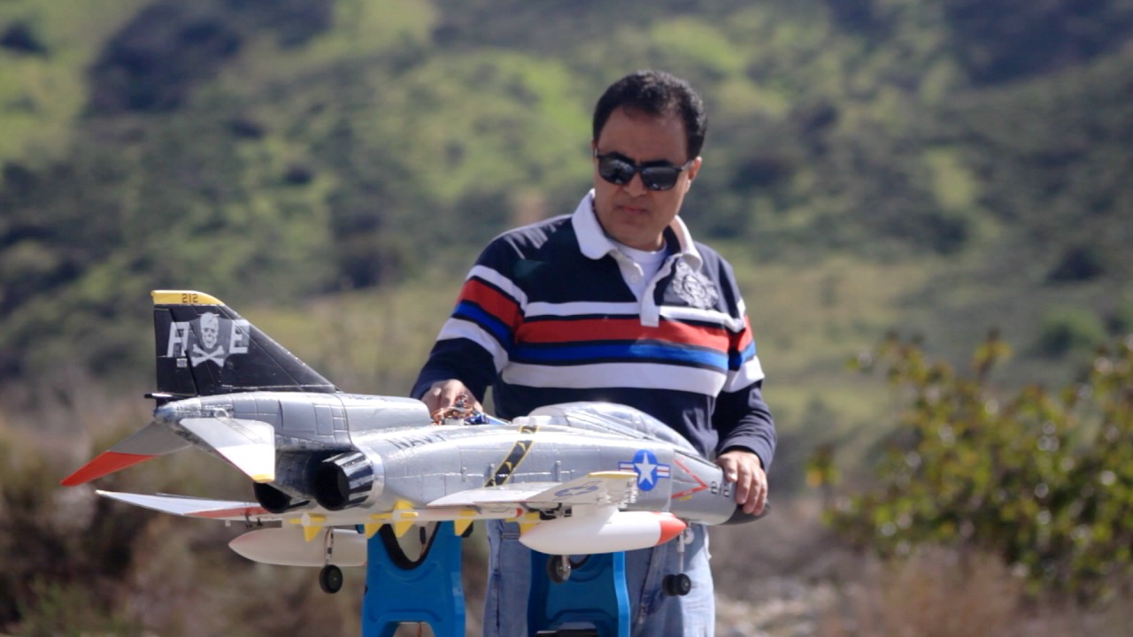

              Thank you all for the great responses. I appreciate and all the positive encouragement. The plane flew great and the 165mm CG was spot on. I had this same model last year and flew with the original stock set up. It was horrible. It was under powered and flew like a brick. The sound was awful and on top of all that, it was a maintenance nightmare. Here is what I felt flying this plane with this set up. It flew like a combination of planes. The F4 glides like the Stinger 90, and with no bad tendencies. Turns like the Mirage/ Mig21. Great plane to fly. Looks like no other in the air. It actually floated and had a nice glide path and considering the lack of power it did land right side up. The damage was very minor. I have it all fixed up and just needs touch up paint. The front landing gear motor was damaged and the main landing gears got ripped out, which caused minor damage to the foam on top of the wing. That's it. I would not change a thing about this build. After flying it, I realized that I accomplished everything I wanted to achieve about this plane. I wanted a freewing quality F4 that was fast and sounded like a real jet. I believe I got it. I have only one small thing to add, the Afterburner LED. I ordered the red LED rings but got the Blue ones instead. I'm still waiting for it to arrive
              (Ebay. http://www.ebay.com/itm/US-2X-80mm-R...lUB9H~&vxp=mtr).
              The inner diameter of the LED ring perfectly coincides with the inner diameter of the exhaust nozzle. I am using the Hobby King Advanced LED control board ($12) to control the Afterburner LED brightness, which is tied to the Throttle port of the RX with a Y connector. I still have to try landing with the Slats and the Flaps. Here are the photos showing the outcome of the repair after the crash. I will try to fly again next Saturday, if the weather cooperates.

                    The motor and EDF is a Freewing 90mm 12 Blade 4068 1680KV Inrunner. Yes, It does draw over 100A. My Amp meter only shows up to 102A and it maxed out with this motor. The power was great It was as fast as my Freewing Stinger 90. I agree, the ME262 twin motors would be great and would save you lots of Modification time, however those motors come with 5Bladed 70mm EDFs and would not give you the proper jet sound. As one of the forum Pilots posted, the FMS inrunner motors for the YAK130 has 12 Bladed EDFs and have 1850Kv. The lower KV rating will give more torque and use less power. I, would go with that set up. Some of the guys at our flying field are working on this project as I'm posting. I have tried using the Freewing 70mm inrunners, and they work great with almost as much power as the single 90mm. The metal housings add more tail weight and your battery placement needs to be adjusted to accommodate for the CG. The only problem would be the power consumption. With the twin Freewing inrunners, the flight time might be less than 2.5 minutes. That's why I believe the FMS motors would be the way to go.

                                        I used this foam from Home Depot. This foam is a bit more dense than others and less porous.
                                        Loctite tite foam is a new generation of polyurethane-based insulating foam sealant that expands to fill, seal and insulate gaps and cracks inside or out. It is white polymer foam based on purified and
