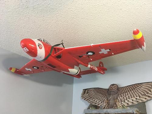

    Mine's just hanging around waiting for the snow to go away.
