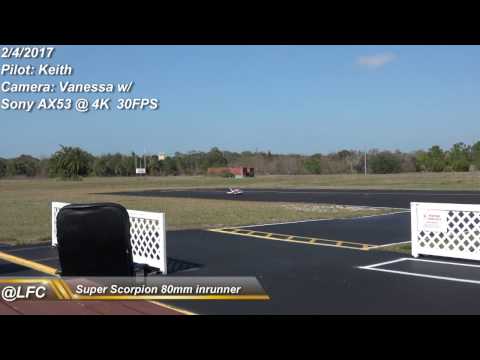

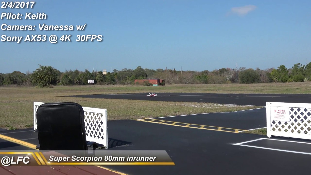

          I agree with Alpha. I bought mine used and it had a ton of play in the mains. I ended up jb welding the setscrews in on the mains, seemed to fix the problem. Did the fix about 30 flights ago, still holding strong. Even after some nasty bounces.Here is flights after gear fix. Have come to really enjoy this jet. 5000mah packs with inrunner motor, so I get around 4min max flying conservatively. Two flights after gear mod. Nothing crazy, the morning out of bounds crew was still present at the field, so kept it cool. I would get a newer generation sport jet, IMO. Unless you get a great deal on one of these.
