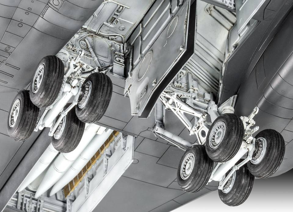

                  I would love to see a B-58 or B-1B! I've always wanted the 106's big brother in RC form. 4x70mm fans for the 58, and a twin 80mm for the B-1B. The 58 would be tough for a lot of reasons though. The fuselage is very thin, and it would be very difficult to fit a normal battery. Perhaps a 2x 4S batteries could fit, similar to the flightline planes. A 4000 4S for each side could be doable, especially if the fans were 9 blades like the big A-10. Then there is the retracts.. They are a work of art, even on the real airplane:

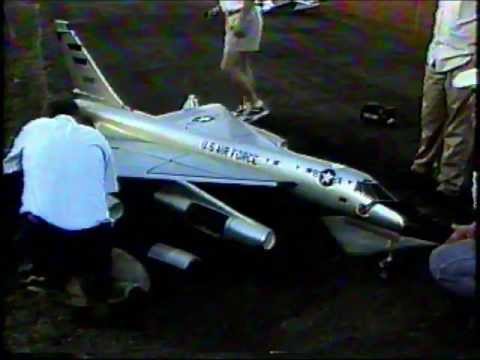

                                    I found this early attempt of a RC B-58 build from back in 1995. Unfortunately at the time EDF units were not available and turbines were probably too expensive if they were available for RC use. So the builder had to resort to ducted fans powered by nitro engines. Too bad this build could not wait till better technology was available. The vibration from the engines ultimately caused the radio to cut off which let to its demise.
