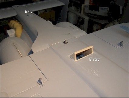

                Maybe a variable size one of these or smaller ones on each side of the fuse...
                  Shouldn't that point the other way and be an "exit" since the batteries are forward of that area? If that's the "entry", what is it cooling and where's the exit? The ESCs are in the airstream of the fans, no? (I haven't unboxed mine yet.)
                    The A-10 in the picture is obviously not the new FW version. The batteries for the FW are in the nose, so any cooling entry needs to be up there. I used the refueling door as an entry point. You could also hollow out the cannon and use that.
