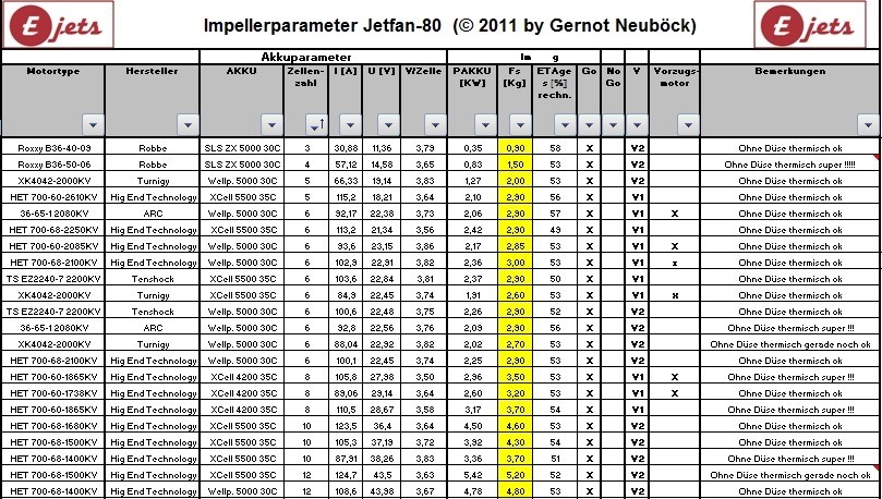

                              Well TCAT it seems you are correct, there is basically no way of putting 90mm in it without losing strength or integrity to fuse. The foam would be paper thin if there was any left, so where do i get a 8s 80mm?
                                • 2137
                                • On planet earth....right
                                Effluxrc has some great service and fair pricing. For the money, a Jetfan EDF/Fan unit is a fantastic value, balanced amazingly well during manufacturing, lightweight, and provides fantastic performance and sound. For Jetfan 80 (stands for 80mm) setups, it depends how much current you're willing to accept. Many choose a HET 1738kv motor or 1865kv motor to use on 8S. Below is a chart showing the current and power (among other stats) of the various motors and LiPo voltage using the Jetfan 80, but you may find the current higher once tested in the aircraft. The chart will help choose which motor you find most appropriate for 8S. :Cool:
                                For the Jetfan 80 shroud and fan unit:
