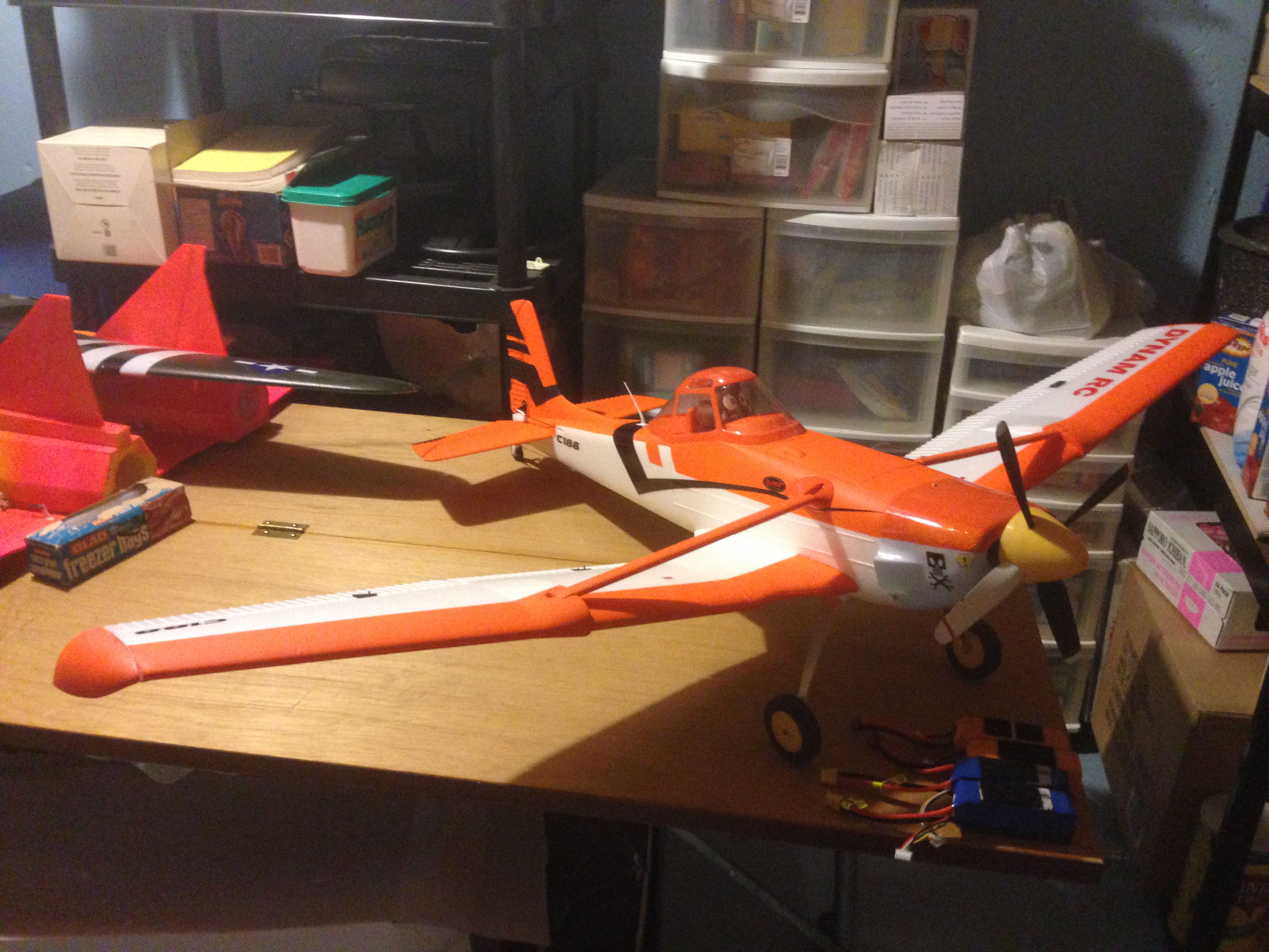

                Besides the 1 piece 4-blade prop from the Roc Corsair, I needed a thick washer to act as a spacer between the motor face and the back of the spinner base (too close). I FoamTac'd some sandpaper discs on both sides of the washer so there wouldn't be any slippage when torquing the nut down. I'm using the yellow spinner and cone from a HobbyKing Durafly 1100mm P-51 Mustang. The back of the spinner back plate needs to have the 4 ribs ground down slightly so it would sit flush with the washer face. Then the prop goes on, then the stock washer and nut. As for the spinner cone, the only way to secure it was to put a dab of FoamTac into each recess of the backing plate, then I used 4 small strips of Blenderm between each blade to hold the cone in place. I'll post a video showing the prop, spinner and maiden tomorrow.
                I flew the Tundra this morning with that prop and it worked extremely well. The plane flew well, with lots of power to even do a prop hang and pull vertically out of it. The sound was also very pleasing. The Tundra flies on 3s, so I suspect Dusty on 4s (lower KV) should be more than comparable.
                • #88
                  Here's a pic of "Dusty". I've got it balanced at 65mm. The 2.2, 4s battery is almost centered on the stock velcro, perhaps 1" further aft. Of note is the 4-blade prop and the "non-stock" pilot. Click image for larger version

                    Wow! With that prop it sure looks like a "mean machine".
