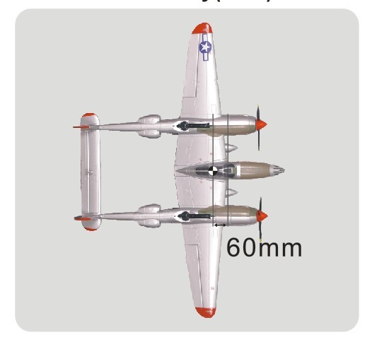

          Ok, I got the feedback from FMS.. The CG is 60mm from the leading edge of the main wing. See picture below:
