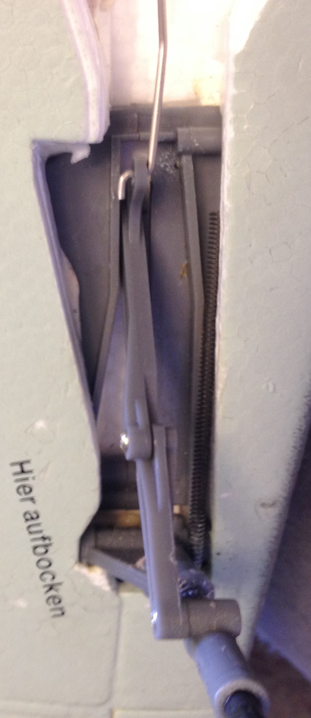

They are a very scale looking mechanical retract opperated by large wire from a single servo with a bell crank. They look good but made of brittle plastic and break easy. The problem I have most is keeping them adjusted. If you crab in a little on cross wind landing on smooth asphalt they almost always collapse. I have to adjust them after each day of flying which requires removing the wing. It's just not worth it any longer.Originally posted by FlygirlHey FF! You mentioned that you wanted to change the retracts to electric retracts... What kind is the stock retracts? You have my curiousity piqued... :-)Comment

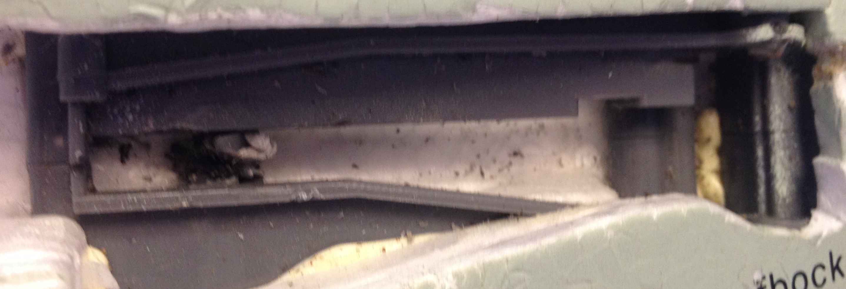

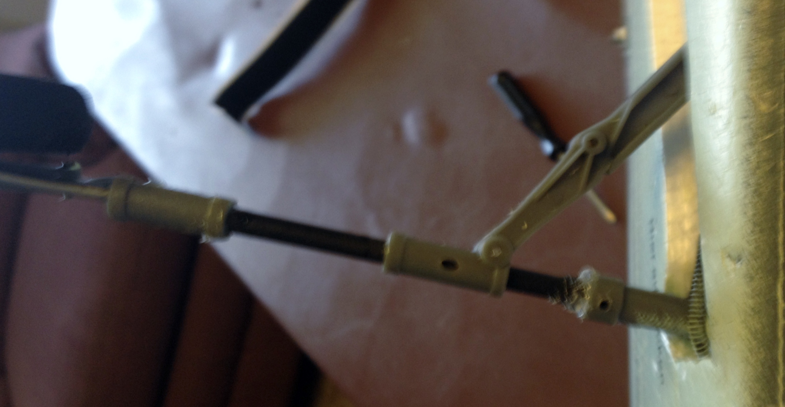

Thanks to Brad from MRC I have the dimensions for the Freewing 190 retracts they are a go. I started today it took 15 minutes to remove old gear 1 remove opperating wires from servo 2 remove screw on gear pivot 3 cut plastic where wire attached with wire cutter slide wire out of wing 4 with a dremmel cut main gear hinge this has a brass rod all the way through I cut down on the front side only and pulled it out 5 the first arm where wire was attached is held with a screw on under side cut it through the plastic with dremmel and pull it out 6 the small tubes the wire ran through to servo can easily be pushed out to allow a entrance for new etract wire and done 15 minutes. When I get the new retracts I'll post the installation. Sorry can't figure out how to add photos.Comment
RE: Flyzone FW 190 Retracts ?

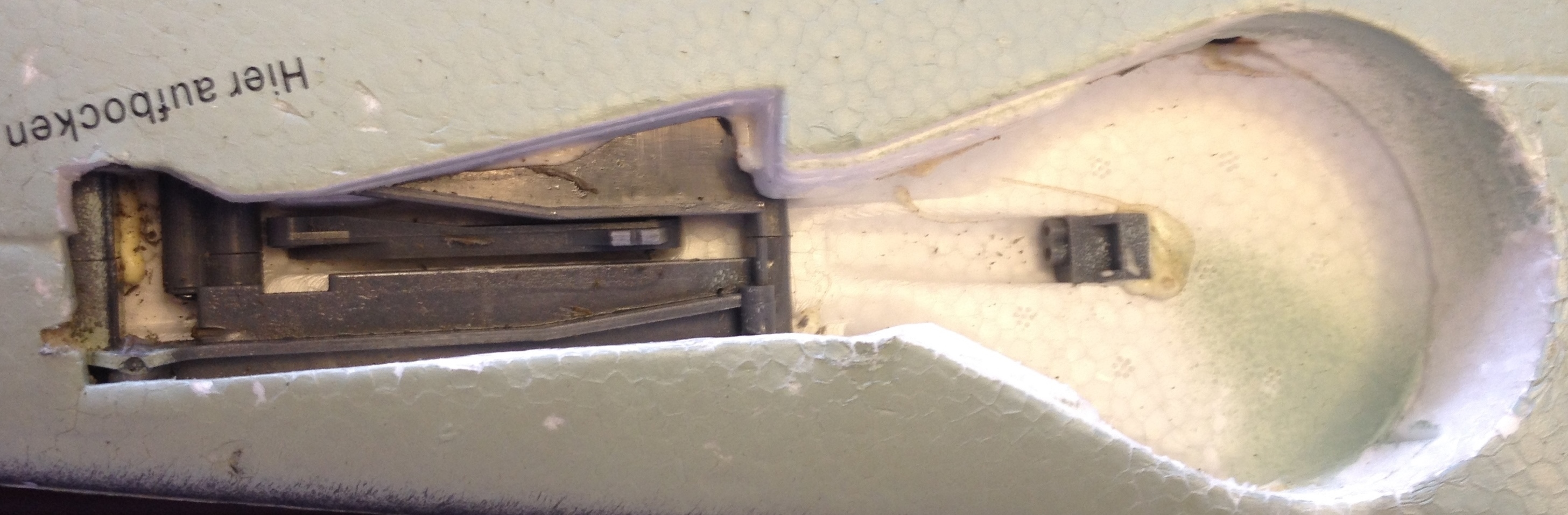

Ok I got one side ready to glue in it took me 4 hours to get the one side cut out and ready. This is a very extensive mod and some of the foam in the upper half of the wing is only about 1/8 thick you have to be very careful there. I burned a small hole through on the top because of the plastic coming off of the dremmel blade. On a good note the alignment with the gear down looks spot on. I'm thinking this route may not be the best answer but I'm committed now so I'll have to finish them. I was also able to use the stock wheels and covers the ones that came with the Freewing retract set were a little to big.Comment

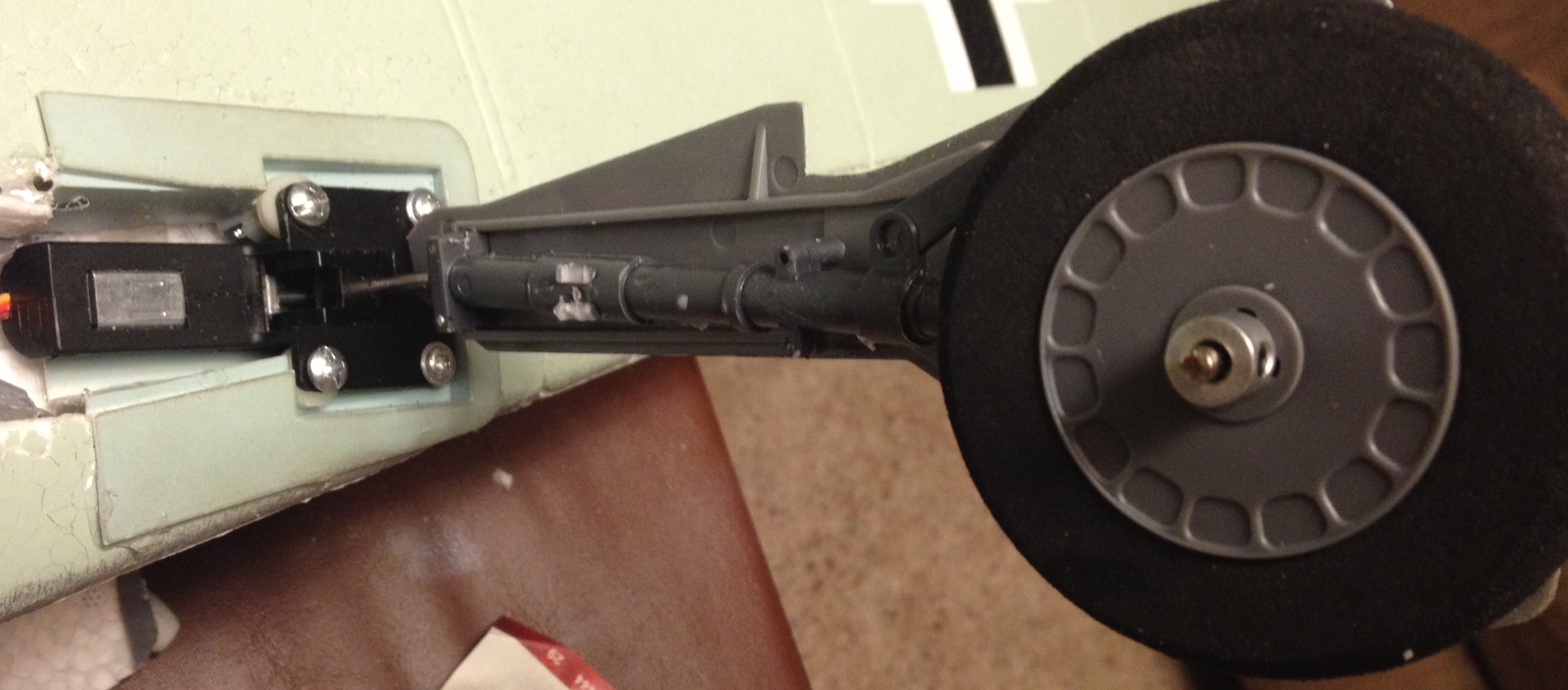

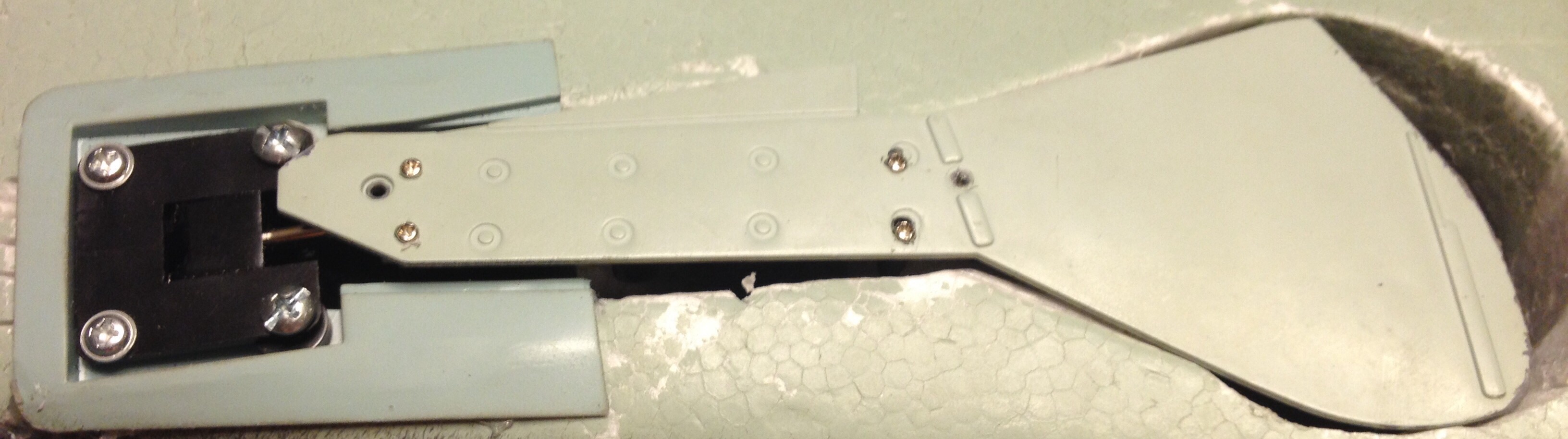

I got the other retract installed today this one went a lot better only took about an hour. They work great the forward rake puts 2/3 of the wheel in front of the leading edge. These retracts have long leads you will only need a short Y to reach the receiver. I formed the flange on the mounts to fit the wing and glued them in. I also shimmed the 2 in board screws with a APC prop adapter to keep the wheels from going to far up in the wing in the up position. All in all I think it's worth doing.

Thanks Loneflier I haven't been able to fly with them yet they have no suspension but the increase in forward take will be good for those flying off grass. It takes some time to do but like I said earlier they're worth it. Now if I have one fail remove 4 screws un plug and replace it. The strut rod on them seems very strong I don't think they'll bend easily.Comment
Whaaat ! 74degrees wind 0-3 mph here today. I got several flights on the fz 190 with the new retracts off pavement and they worked flawlessly. The only thing was I had a little trouble with bounce on initial touch down. I don't know if it was caused by no suspension on retracts or me. On the last landing I let it kinda drop in and bang the retracts pretty hard no problems struts didn't bend or loosen the mounts in the wings. I'm really glad I did this mod. The Freewing 1120mm fw 190 retracts with the mounts are a good fix. I would definitely recommend doing this its a good fix for replacing the stock gear.Comment
